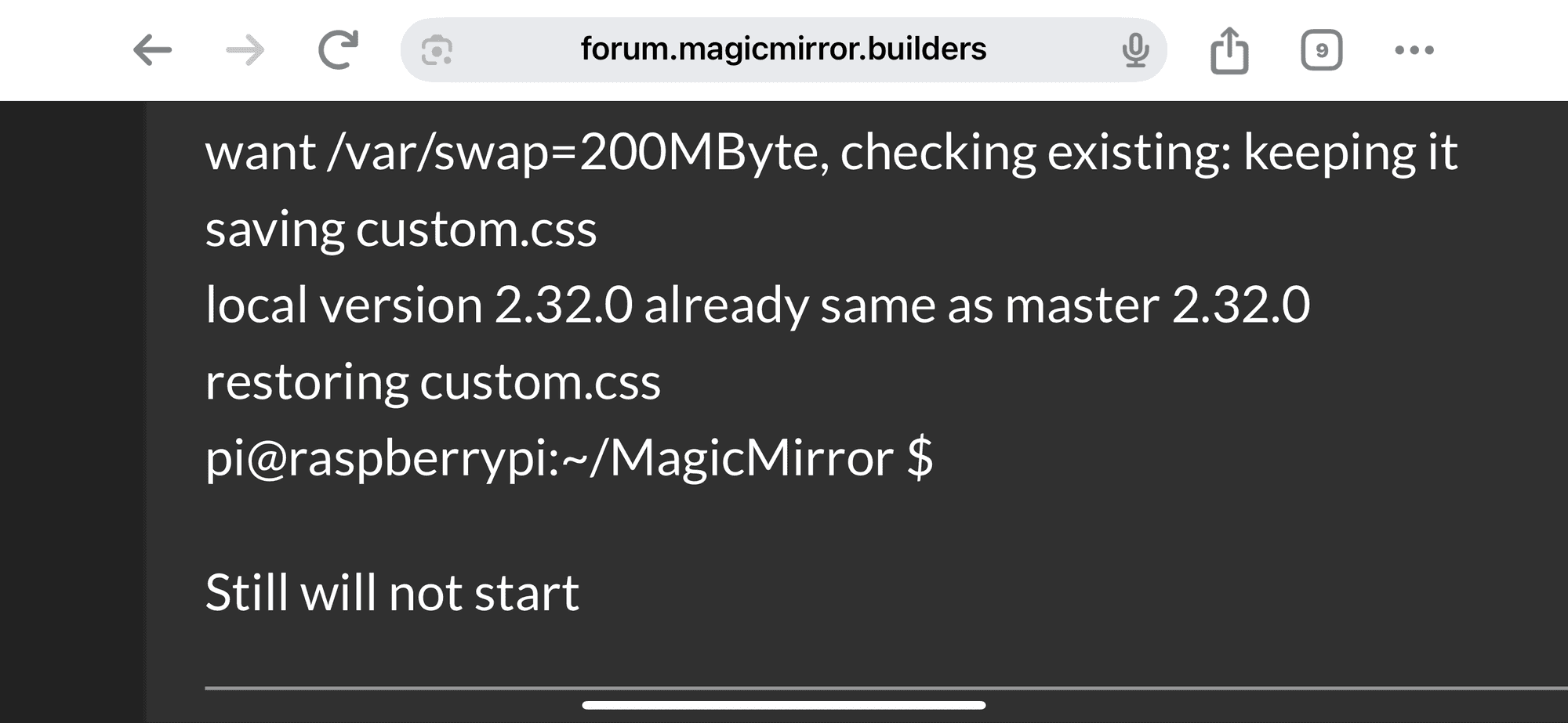

            pi@raspberrypi:~/MagicMirror $
            Still will not start
              sdetweil @Sampleswow
              Because you did this manually the script will abort if the same version is already
              I provide another option, instead of apply use
              force
              At the end of the command
              I don’t document this because I dont want everyone using force and getting into more trouble.

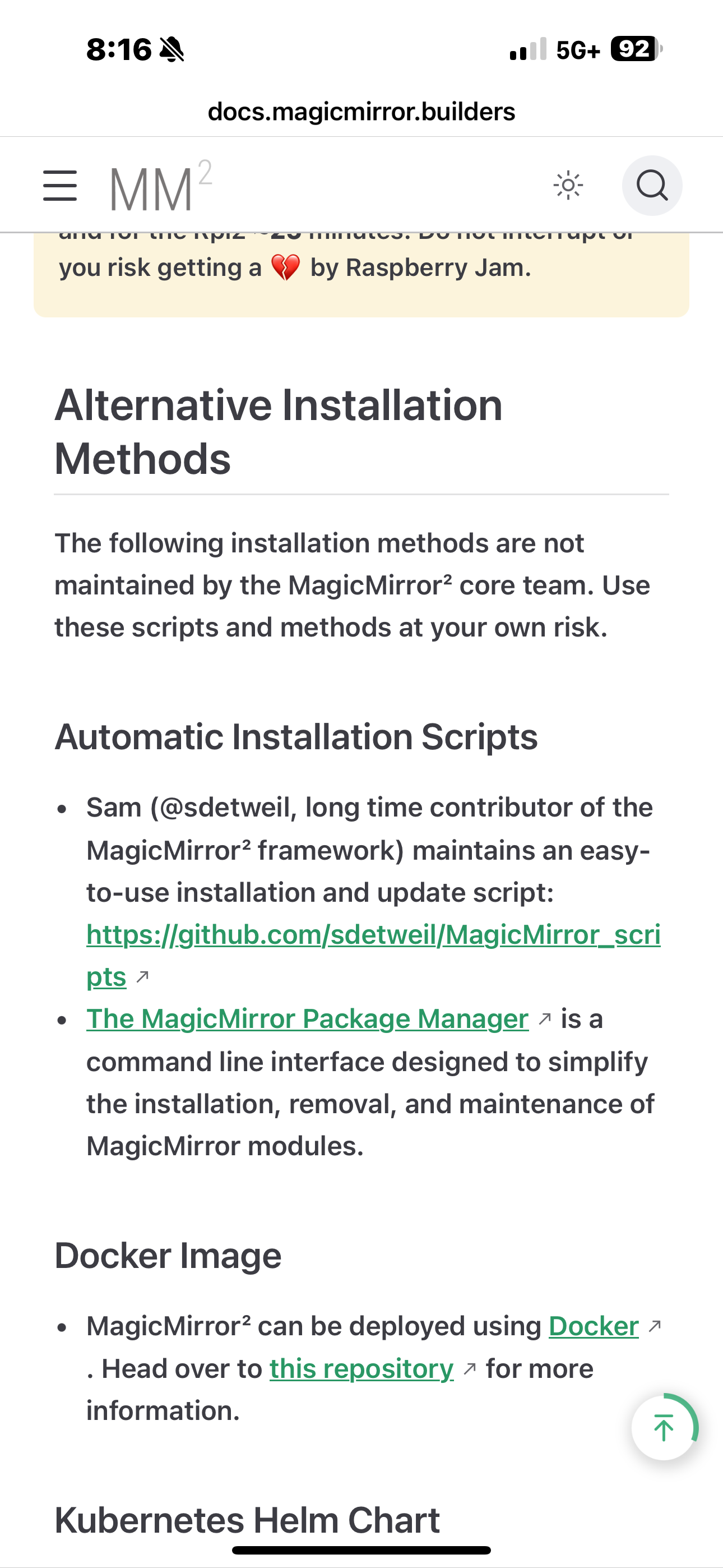

                                also again What script i have no idea what your referring to, or how to use it. I am a basic user of Magic Mirror
                                  @Sampleswow
                                  I have two sets of scripts, install/update are listed in the MagicMirror doc
                                  Install/upgrade
                                  https://github.com/sdetweil/MagicMirror_scripts
                                  Backup/restore, which can save your MagicMirror setup and place it in a GitHub repo, with versions (it does not backup folders, only info required to restore the config onto a new MagicMirror install.).
                                  https://github.com/sdetweil/MagicMirror-backup-restore
