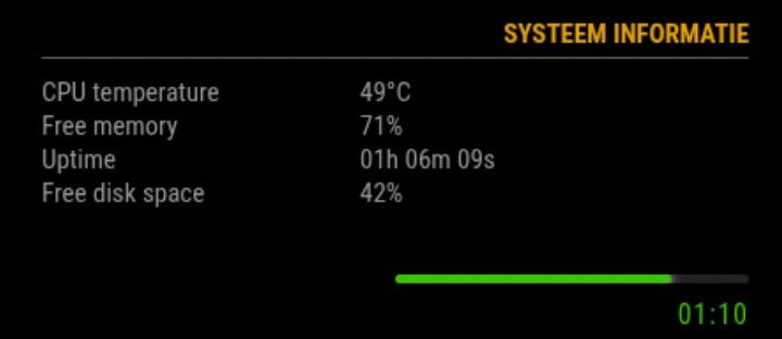

                      Hi Ralf, I implemented the new version and parameter.
                      It works great!
                      I’m now playing with the CSS.
                      Made the bar smaller (50%) rounded edges and alligned the counter at the left of my screen.
                      For those who like this setup, just add following in ~/MagicMirror/css/custom.css
                      /* MMM-PresenceScreenControl */
                      .psc-linebar {
                        width: 50%;
                        height: 5px;
                        background: #222;
                        border-radius: 4px;
                        margin: 6px 0 6px 0;
                        overflow: hidden;
                        margin-left: auto;
                        margin-right: 0;
                      .psc-bar {
                        height: 100%;
                        width: 100%;
                        border-radius: 4px;
                        transition: width 0.4s ease, background 0.4s ease;
                        box-shadow: 0 0 6px currentColor;
                      .psc-timer {
                        font-size: 16px;
                        margin-top: 4px;
                        margin-bottom: 2px;
                        letter-spacing: 1px;
                        text-align: right !important;

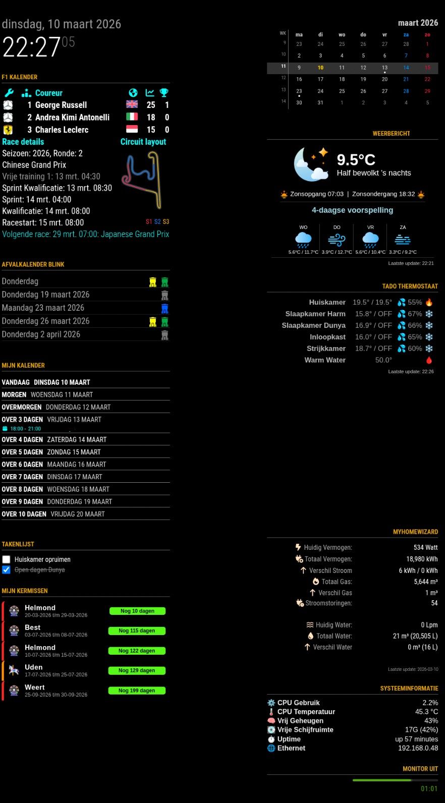

                        • htilburgsH Offline
                          htilburgs @rkorell
                          @rkorell
                          My current mirror
                          This is why I have it on the right. For me this feels better.
                          On the left side there comes the Spotify information, when I play music.
                          (still trying to learn JS, but not afraid to ask and AI is my best friend) ☺
                          R 1 Reply Last reply Reply Quote 0

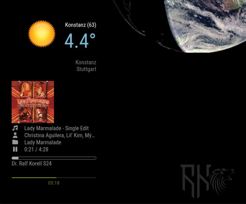

                            rkorell Module Developer @htilburgs
                            I have a quite similar layout.
                            My MusicPlayer (Volumio) is on the left side, too but is spreading the region if cover-art is appearing…
                            Warmest regards,
                            Ralf
                            htilburgsH 1 Reply Last reply Reply Quote 0
                                Dear @htilburgs,
                                Yes, I Like your garbage module - it’s really great - thanks for this!
                                I’m using MMM-NowPlayingOnSpotify …
                                This has exactly the behavioour as described.
                                Shows a spotify logo - which I had replaced with Volumio logo (which is my favourite spotify player) and only expands if something is played.
                                In this case the left corner looks like
                                Warm regards,
                                Ralf
