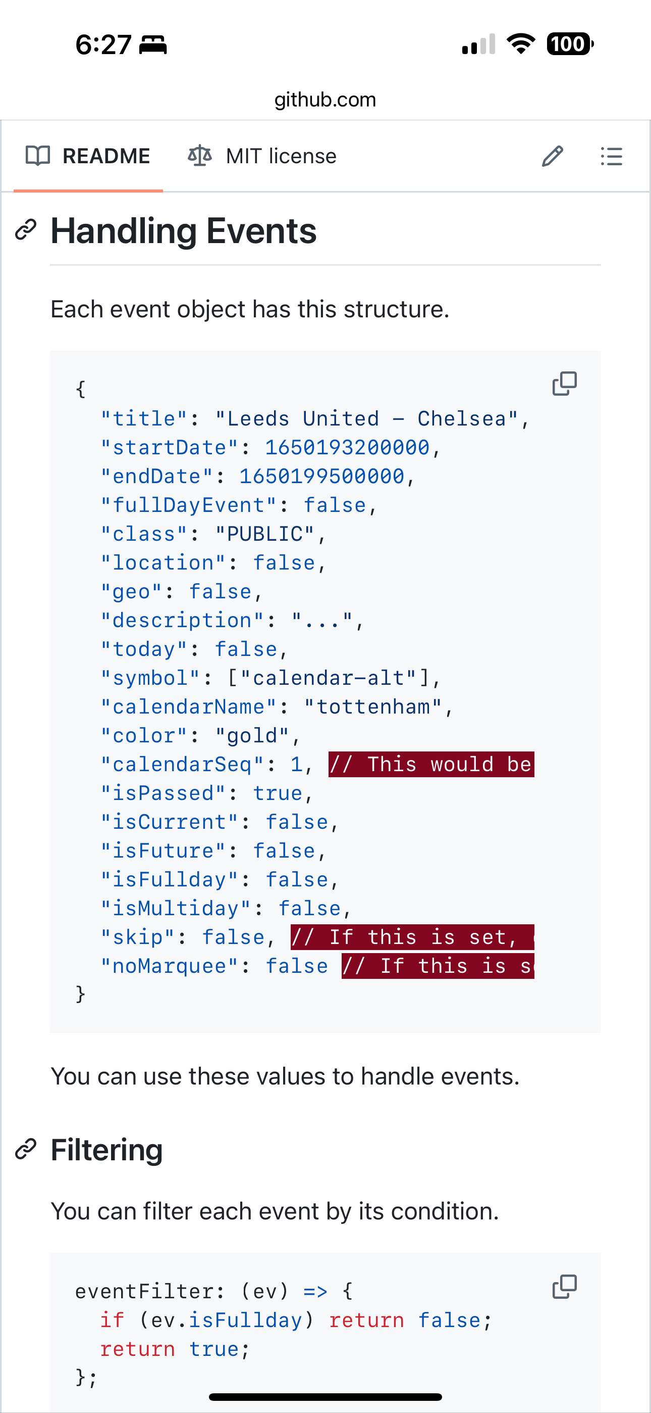

              @_V_ from his readme
                sdetweil @_V_
                @_V_ what do you mean for title? We just searched title
                If you want to change it. Then do that
                ev.title=‘new string’
                Same with symbol
                  sdetweil @_V_
                  @_V_ you can change any property of the event
