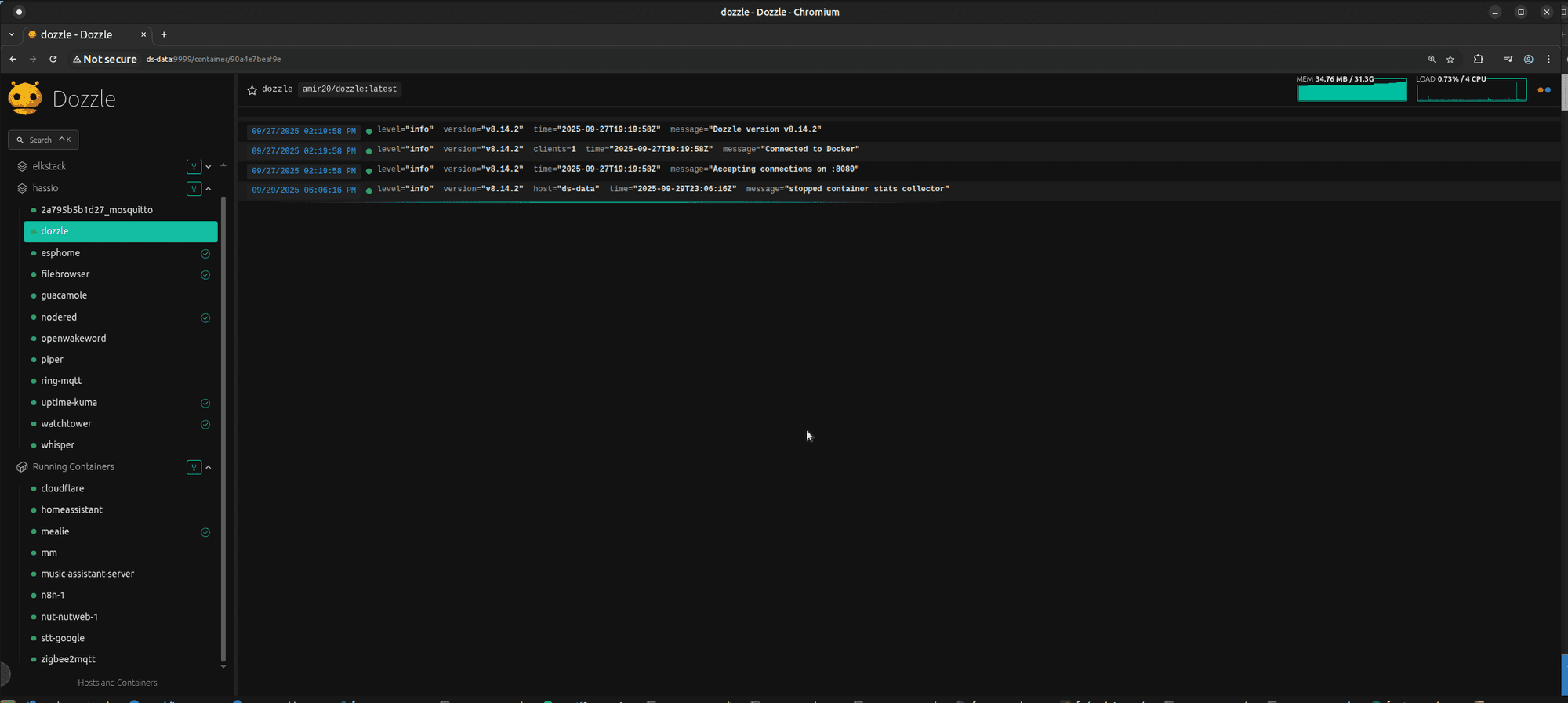

            here is a dozzle list of all the containers I am running on my synology 923+ nas, 32 gig memory
