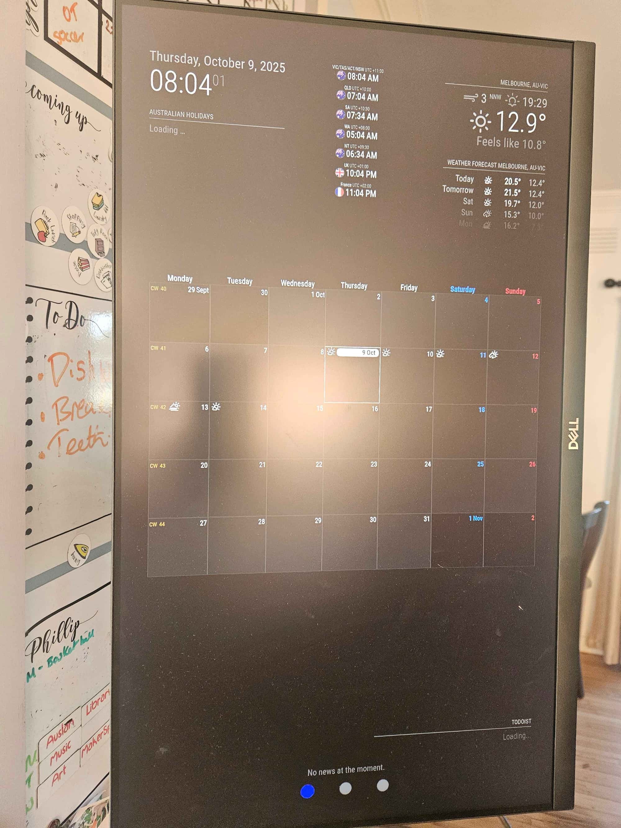

      Thanks to you both.
      @kristjanesperanto I changed to your main one and it has solved the problem. So thanks for that.
      @sdetweil I have never got the keyboard to work. I can click on things on the screen, but I think the keyboard is hidden behind everything, so I probably will just disable it altogether. By changing the MMM-pages, this solved the problem without making changes to the keyboard. Do you know what setting I would need to make it pop up in front when I need to type things in?
      Very happy to have my MM and HA working again :)

      I know I have another response awaiting approval. However, I wanted to confirm that I checked my MMM-pages module and it is https://github.com/sdetweil/MMM-pages branch (hopefully the correct terminology).

      @sdetweil Hi Sam
      I haven’t changed anything in my config, and maybe that is the problem. There are certainly some things I should probably remove which I am not using and aren’t showing. But I don’t want to change anything else until this works. I also meant to say that when I updated Magic Mirror, I used your script.

      Good morning
      My mirror has been pretty stable since my last post which is great. I have three pages, one is my main with calendar, weather etc and the last one has iFrame with my Home Assistant on it.
      Yesterday I decided to do some updates, I finally updated Magic Mirror itself, MMM-CalendarExt3, MMM-page-indicator and MMM-Remote-Control. The latter was a pain and took a bit of time as had some messages about different branches, but it is now showing as up to date.
      My problem is that although the page indicator looks the same, the “Home” button is pulsing to show it is the focus page, however, I cannot switch pages. I’ve checked documentation to see if I needed to make any changes to the config file, but it looks like no changes to that are needed.
      I have set it up using classes.
      I’m about to head to work, but was hoping someone might either know a quick fix or what to check in logs etc that might point me in the right direction. I have a touch screen and that is still working as if I click on an event on the google calendar, the event pops up. Unfortunately this means I cannot access Home Assistant through my MM which is really frustrating!
