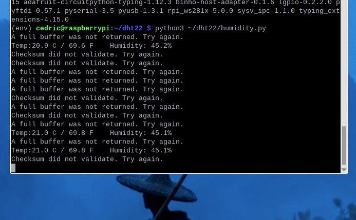

              But, interesting, it finally works when I try another direct way as described on https://pimylifeup.com/raspberry-pi-humidity-sensor-dht22/, so that it seems, that everything should work.
              Capture d’écran 2025-11-20 à 13.37.59.jpg.
              Now, do you think that there suddenly could be an error in your module ?

                    It looks like there will installed two additional python libs in the venv in the tutorial you shared.
                    Maybe one of the libs is missing in the virtual environment my script creates.
                    You can add them to the venv with:
                    cd ~/MagicMirror/modules/MMM-Temperature/scripts
                    ./venvWrapper.py --venv-name py-venv --install-libs lgpio RPi.GPIO
                    wishmaster270W 1 Reply Last reply Reply Quote 0
