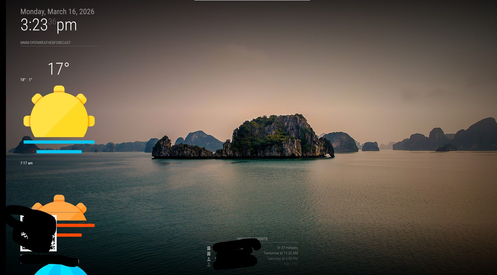

      But I’m getting a strange formatting thing – look at the attached screenshot. The icons are giant and the module runs off the screen.

        Oops, the screenshot didn’t take, here it is:

                                  Ok, I commented out forecastLayout: No change.
                                  I renamed the custom.css – No change.
                                  I’m pretty stumped.
                                  Did something change in mirror versions? I set mine up maybe 2-3 years ago and it’s chugged along with no problems. – so I haven’t updated anything.

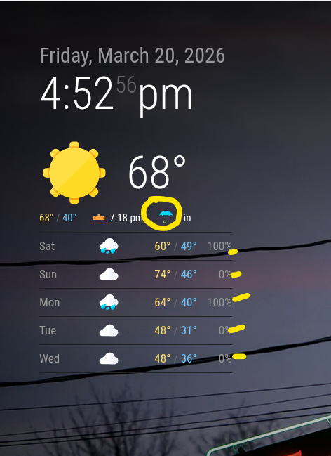

                                      I do have a follow-up formatting question – if you look at the screenshot below, you can see I turned off the table header (I like a more compact look).
                                      But now the rain percentage isn’t obvious to someone looking at it. I want to add the little umbrella icon to the right of the rain percentage on every day row.
                                      Could someone point me to the right place for that? And if there’s a way to figure this out on my own, please let me know.
