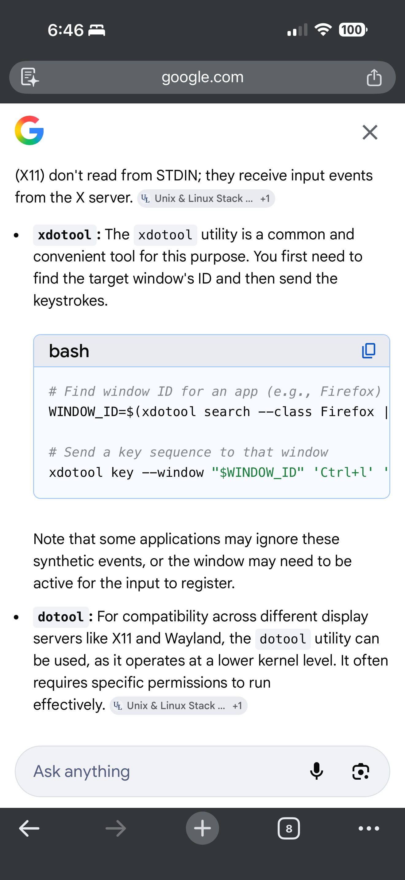

            There are Linux tools that can send keystrokes
