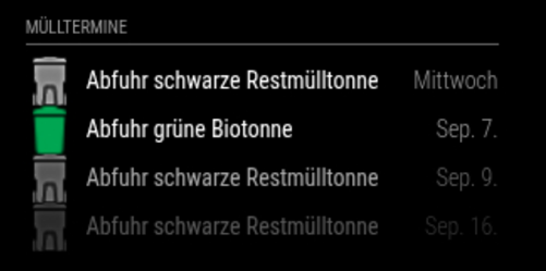

        At the end i have my bins on the screen:
        I’m sure there must be a much simpler way, but it took me quite a while to get the result, and that’s what counts in the end. ;-)

                      Thank you very much for the tip.
                      But I’ll leave it as it is for now.
                        sdetweil @MyMirror
                        @MyMirror I wasn’t suggesting you change anything… just for others watching, there are other options…
                        my backup/restore won’t save/restore files from inside the default_modules… cause they are not supposed to change
                        M 1 Reply Last reply
                        • M
                          MyMirror @sdetweil
                          Everything’s fine – that’s what I thought.
                          That’s why I’ve set out my changes as clearly as possible.
                          Thank you very much!
                          Reply Quote 1
