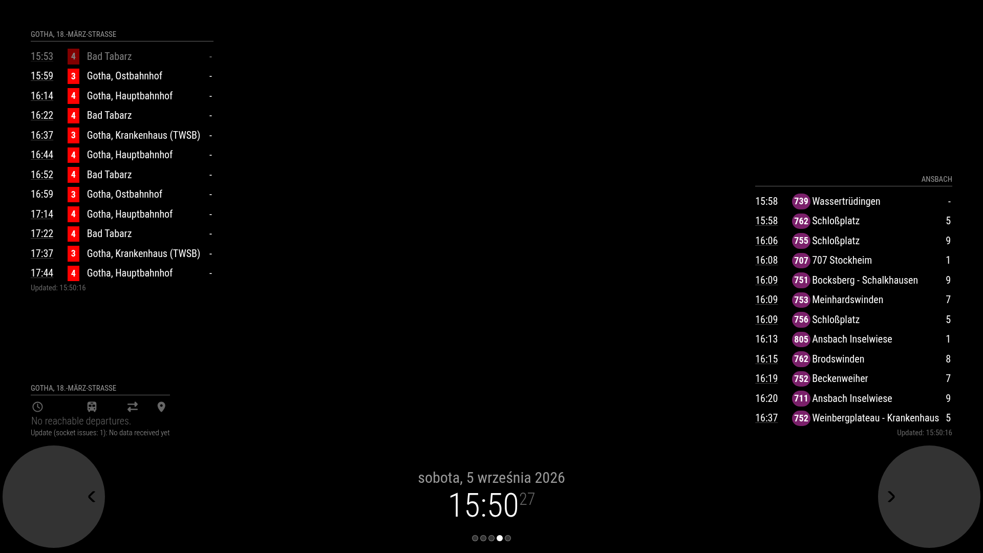

          @KristjanESPERANTO well, on the HAFAS (older module) I see only 22 position when I am searching using node. Why? How to change pagination.
          Your new Module HUB is working for Gotha Hauptbahnhof… perfectly. I want to use both modules if possible.
          And still on theolder module HAFAS is update socket issue 1
          On the searching mode inside node query can not use German letters. How to configure node CLI?20260904_14h51m33s_grim.png
          On your module Hub node console looks exactly:
          • M
            Mati_93 @Mati_93
            So ID searching tool from node query still won’t work with 18 März Straße but i found stationId via gemini :) (i dont’ like it). In my code i am using two TransportHub modules (TransportHafas is in code but i am not using in my carousel because is not working) . 18 Marz Strasse station does not return an error but says that there is no departures. Ansbach station works perfecly.

            please help me to figure it out together.

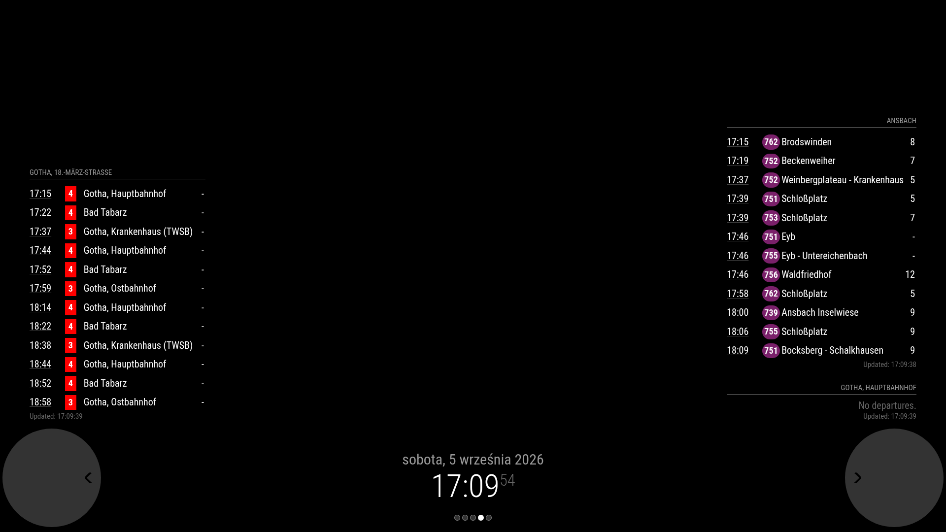

              @Mati_93 Wow, that a bunch of separate issues. These three minimal configurations work for me with the Gotha stop. Please test them one at a time first. I had to play with timeInFutureMinutes a bit to get departures.
              MMM-PublicTransportHub with HAFAS
                module: "MMM-PublicTransportHub",
                header: "Gotha, 18.-März-Straße",
                  provider: "hafas",
                  hafasProfile: "vmt",
                  stationId: "167050",
                  timeInFutureMinutes: 720
              Older MMM-PublicTransportHafas
                module: "MMM-PublicTransportHafas",
                  stationID: "167050",
                  timeInFuture: 720
              MMM-PublicTransportHub with Transitous
                position: "top_center",
                  provider: "transitous",
                  stationId: "de-DELFI_de:16067:167050::16705000",
                  contact: "@Mati_93",
              Please note that vmt is a HAFAS profile, not a provider. Therefore the Hub needs provider: "hafas" together with hafasProfile: "vmt".
              The garbled German characters look like a UTF-8/locale problem on Raspberry Pi OS. Please check:
              locale
              locale charmap
              The result should contain UTF-8. You can configure this with:
              sudo raspi-config
              I think you have to select Localization Options → Locale and enable de_DE.UTF-8 UTF-8. Log in again or reboot afterwards.
              As a quick test, you can search without special characters:
              18 Maerz Strasse Gotha
              OPS_BLOCKED usually comes from a blocked DB endpoint. For Gotha, please use the regional vmt profile instead of a DB profile.
              • M
                Mati_93 @KristjanESPERANTO
                @KristjanESPERANTO I can use German signs everywhere on terminal but not in node.js.
                After I type node – run query i am no longer permitted to use äüß umlauts.
                Second problem : HAFAS is over. All the time I have socket issue.

                                	ignoredLines: [],
                                	timeToStation: 10,
                                	displayLastUpdate: true,
                                	maxUnreachableDepartures: 0,
                                	maxReachableDepartures: 7,
                                	showColoredLineSymbols: true,
                                	customLineStyles: "",
                                	showOnlyLineNumbers: false,
                                	showTableHeadersAsSymbols: true,
                                	useColorForRealtimeInfo: true
                    		position: "bottom_left",
                			carouselId: "Station_Gotha_18_März",
                			timeInFutureMinutes: 720,
                			updatesEvery: 60,
                			maxDepartures: 12,
                			timeToStation: 4,
                			maxUnreachableDepartures: 2,
                			excludeCanceled: false,
                			lineFilter: [],
                			directionFilter: [],
                			productFilter: ["tram", "bus"],
                			showDelay: false,
                			showRealtimeIndicator: true,
                			showRemarks: true,
                			columnOrder: ["time", "line", "direction", "platform"],
                			lineStylePreset: "none",
                			replaceInLineNames: { "Bus ": "" },
                			requestTimeoutMs: 12000,
                			fetchRetries: 1,
                			contact: "mateusz.kujawa93@gmail.com"
                    		position: "bottom_right",
                    		header: "Ansbach",
                			carouselId: "Station_Ansbach",
                			stationId: "de-DELFI_de:09561:11000:53:4",
                			updatesEvery: 60,
                			maxDepartures: 12,
                			timeToStation: 4,
                			lineFilter: [],
                			showDelay: false,
                			showRemarks: true,
                			fetchRetries: 1,
                    		header: "Gotha, Hauptbahnhof",
                			carouselId: "Station_Gotha",
                			stationId: "de-DELFI_de:16067:8010136",
                			updatesEvery: 60,
                			maxDepartures: 12,
                			timeToStation: 4,
                			lineFilter: [],
                			showDelay: false,
                			showRemarks: true,
                			fetchRetries: 1,
                /***** DO NOT EDIT THE LINE BELOW *****/
                For Slide 3 and 4 I have no solution. Your module Hub understand carouselId only when i put it in ignoreModules list!
                EDIT! I’ve found a solution : O to the carouselId!
                      		module: "MMM-Carousel",
                		position: "bottom_bar",
                        		transitionInterval: 20000,
                        		ignoreModules: ["clock", "alert","Station_Gotha_18_März"],
                        		mode: "slides",
                        		showPageIndicators: true,
                        		showPageControls: true,
                        		slides: {
                          			main: ["weather"],
                          			"Slide 2": ["MMM-OpenWeatherForecast", "newsfeed"],
                          			"Slide 3": ["calendar", "compliments",{name: "MMM-PublicTransportHub", carouselId: "Station_Ansbach" }],
                				"Slide 4": [{ name: "MMM-PublicTransportHub", carouselId: "Station_Gotha" }],
                				"Slide 5": ["MMM-EasyPix"]
                        		keyBindings: {
                          			enabled: true,
                          				map: {
                            					NextSlide: "ArrowRight",
                           		 			PrevSlide: "ArrowLeft",
                            					Pause: "ArrowDown",
                            					Slide0: "Home"
                         		 mode: "DEFAULT"
                dictionaries were the key. Sorry for my bad level of programming.
                Still bad that hafas module is over. I liked design of hafas module much more.
                Now everyhing is working on HUB module just like before it has been running on HAFASmodule (clock and main station is permanent on the screen on every slide and other modules and stations shows only with dedicated ones slides.) I like this combination. Still have not found a solution to UTF encoding in node.js query searching tool.
