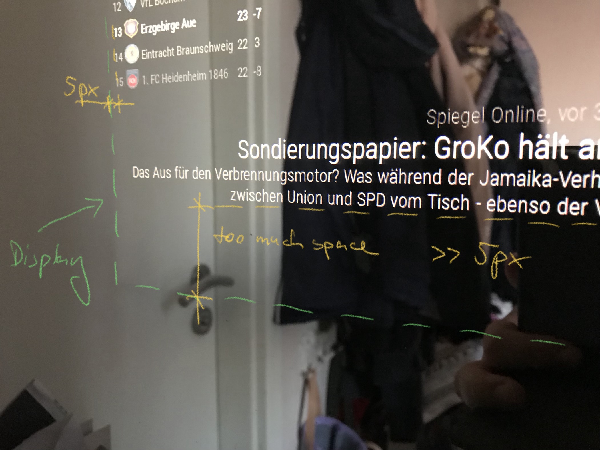

          I understood that so far and also wanted the modules (e. g. MMM-Soccer) stop bouncing over the newsmodul. But then I noticed that the lower distance between the news module and the display edge is too big. The distance is at the top, left and right correctly only bottom space is wasted. The „height“ parameter doesn’t seem to work.
          By the way, my display is smaller than the mirror.
          Maybe a picture will make it clearer…

            Have you started your mirror in developer mode and checked out the elements and the settings? If you start it with “npm start” try “npm start dev” instead. You’ll see “Elemente” where you can go through the whole structure (DOM) and see their CSS settings. Changes to those settings are not stored, so you can play around there.
              surger13 Project Sponsor @doubleT
              margin-bottom: 0px
              had no effect.
              But I had an error under Body, there was a comment with special characters, so the height parameter didn’t work. After deleting the comment it now works as desired.
