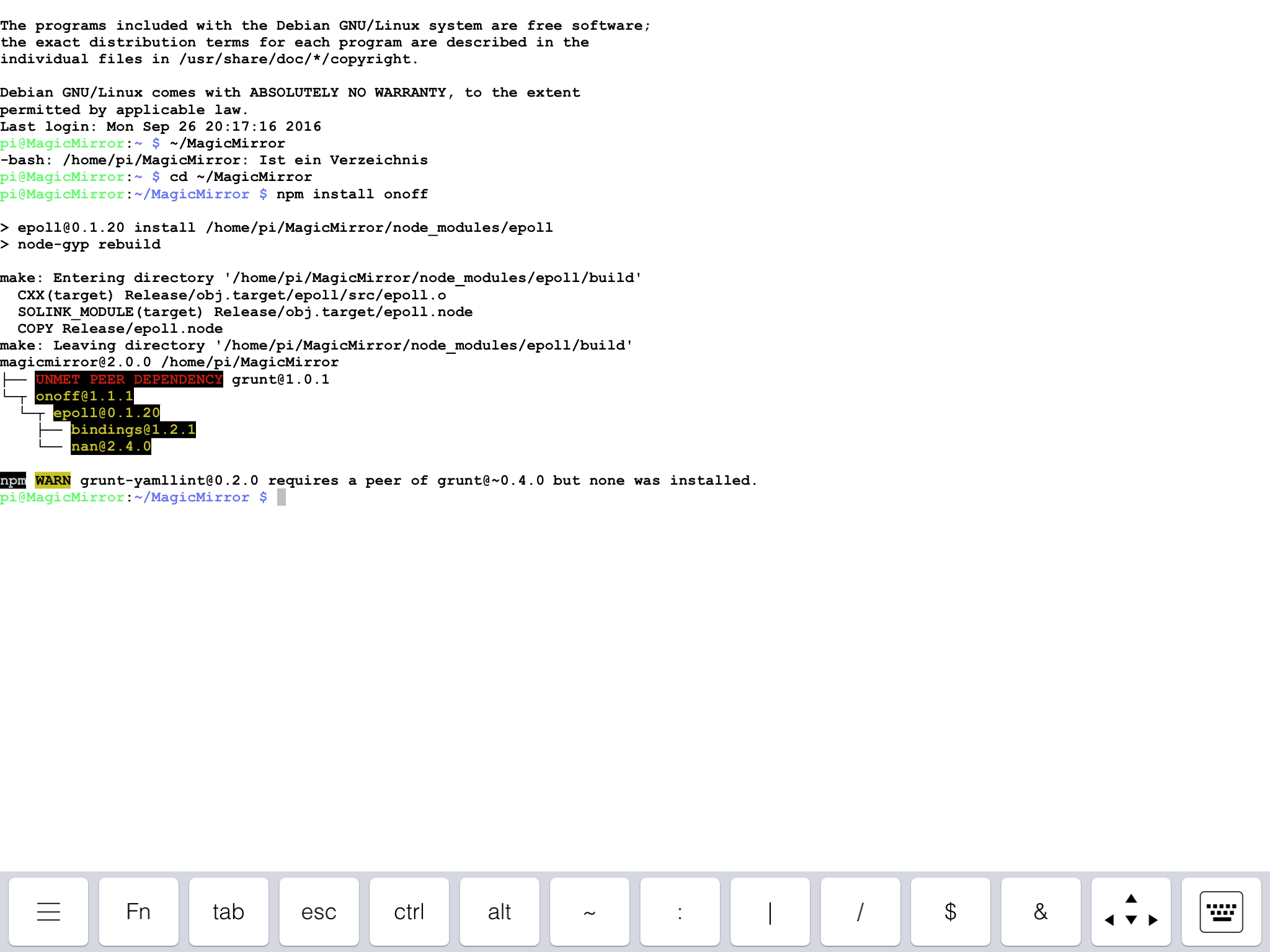

                                  • cruunnerrC Offline
                                    cruunnerr
                                    so, i tried everthing but cannot get it work at all. tried it many times…but every time i did the “install” i got some warnings. tried to get them away with install the newest versions and it shows me that it was succesfull, but always get the same warnings… dont know why and if they are significantly.
                                    edit: why others dont have this problem? I used the “complete setup tutorial”. or is it cause i used the automatic installer?
