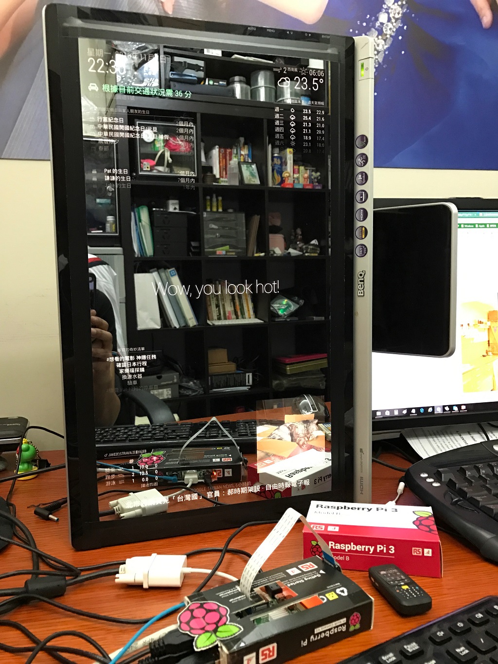

      Hi all,
      Yes, sorry!! as you can see, it still under construction. I will use it on 37~50 inch monitor in my living room.
      I got “one way mirror” for testing today, I don’t really know how to call it eventually.
      In the photo, it looks great, but when I use my eyes to see it, it isn’t like a real mirror, something like “black mirror”?!
      Can anyone suggest me that what mirror or solution can fix this problem? or it can’t be a real mirror for everyday use my wife says…
      Thanks in advance !!!

        it is very impotant, that the black of your monitor is really dark. If the black is bad, the mirror can not do his job, because every light behind the mirror reduces the mirror effect. For a good result it is also important, that the monitor is bright, but your one looks very bright. I think, that it is very hard to find a perfect mirror. My mirror has also a black touch. Maybe it is normal, because it is no normal mirror.

                I think the issue with your “black mirror” is more an issue with lighting in front of the mirror. Turn the monitor off and put the mirror in a bright area. Preferably with strong daylight. I predict the “black mirror” issue will resolve itself.

                  @bhepler thanks for your comment, but I think the problem is not comes from environment.
                  I did a comparison table, as you can see, no one can use for vanity as my wife said.
                  I may choose #4 for house decoration at end this year. but it is expensive and sensitive parts in Taiwan (you should know, the bad guy use it for “Candid camera” behind glass). And, I don’t know if I use #2 for vanity table my wife will accept…

                    @bhepler I’m afraid it’s probably not the issue. I had the same problem when I replaced a mirror on the bathroom. It was just too dark compared to the one it replaced. The lighting where the same…
