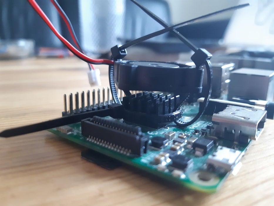

      To avoid overheating of pi, a Heat Sink & Fan is enough to maintain temperature below 50 Deg C.
      But as you quoted that the pi is without a case you could use cable ties to attach it to your fan just like this guy did !
      https://www.instructables.com/id/Simple-Raspberry-Pi-Cooling-Fan/

          Thanks for your hints.
          Well, it does freeze at these temperatures. And I already have a cronjob which reboots the pi every 6 hours, does not help. No freezing when cooling with a fan, but far too noisy, so no, doesnt seem to be a memory problem rather than a heating problem, so I do not think that setting up higher throtteling temperatures will do any good.

              AS I have no case, I have no way to fix the fan without touching anything and then it is scratching on the surface or is vibrating. Tried it a lot, always too loud. No idea on how to get it fixed.

                  Try this if it helps to hold the fan !
                  Try this if it helps !
