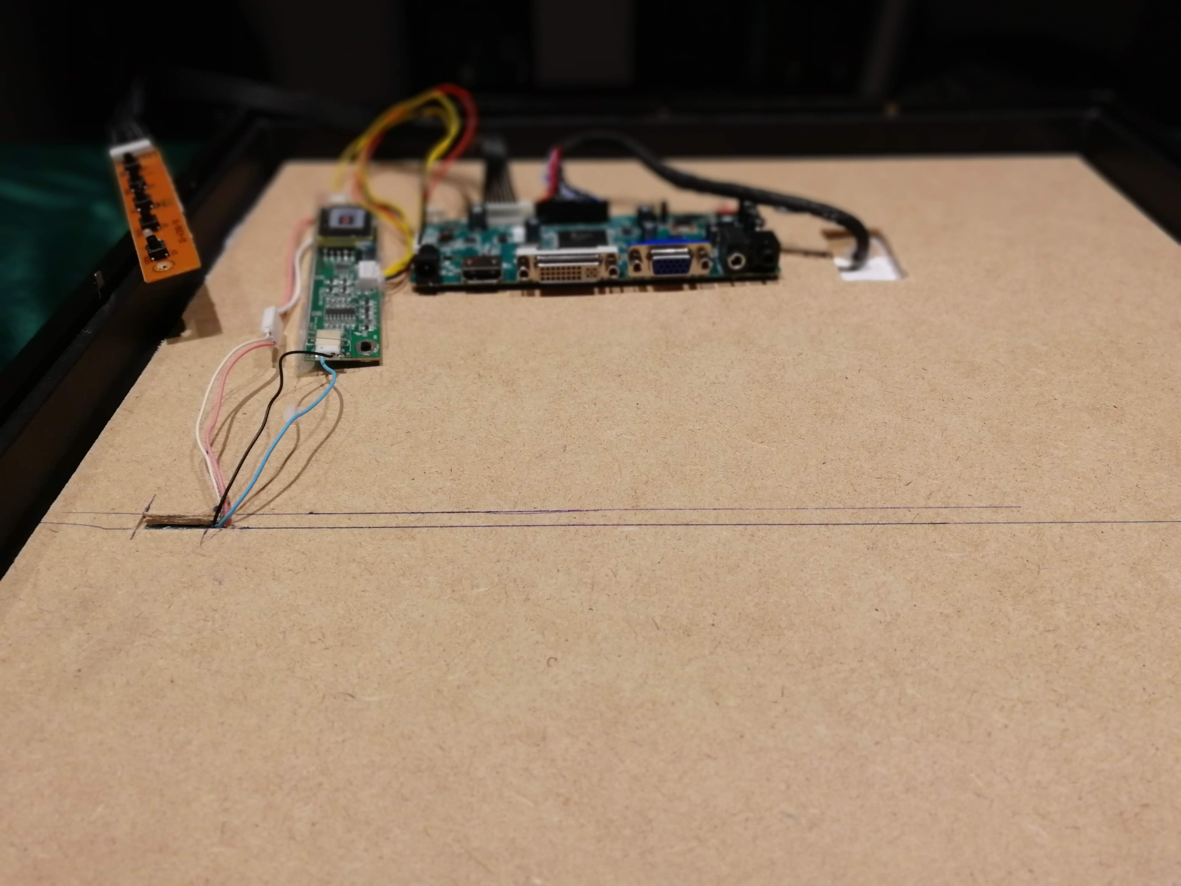

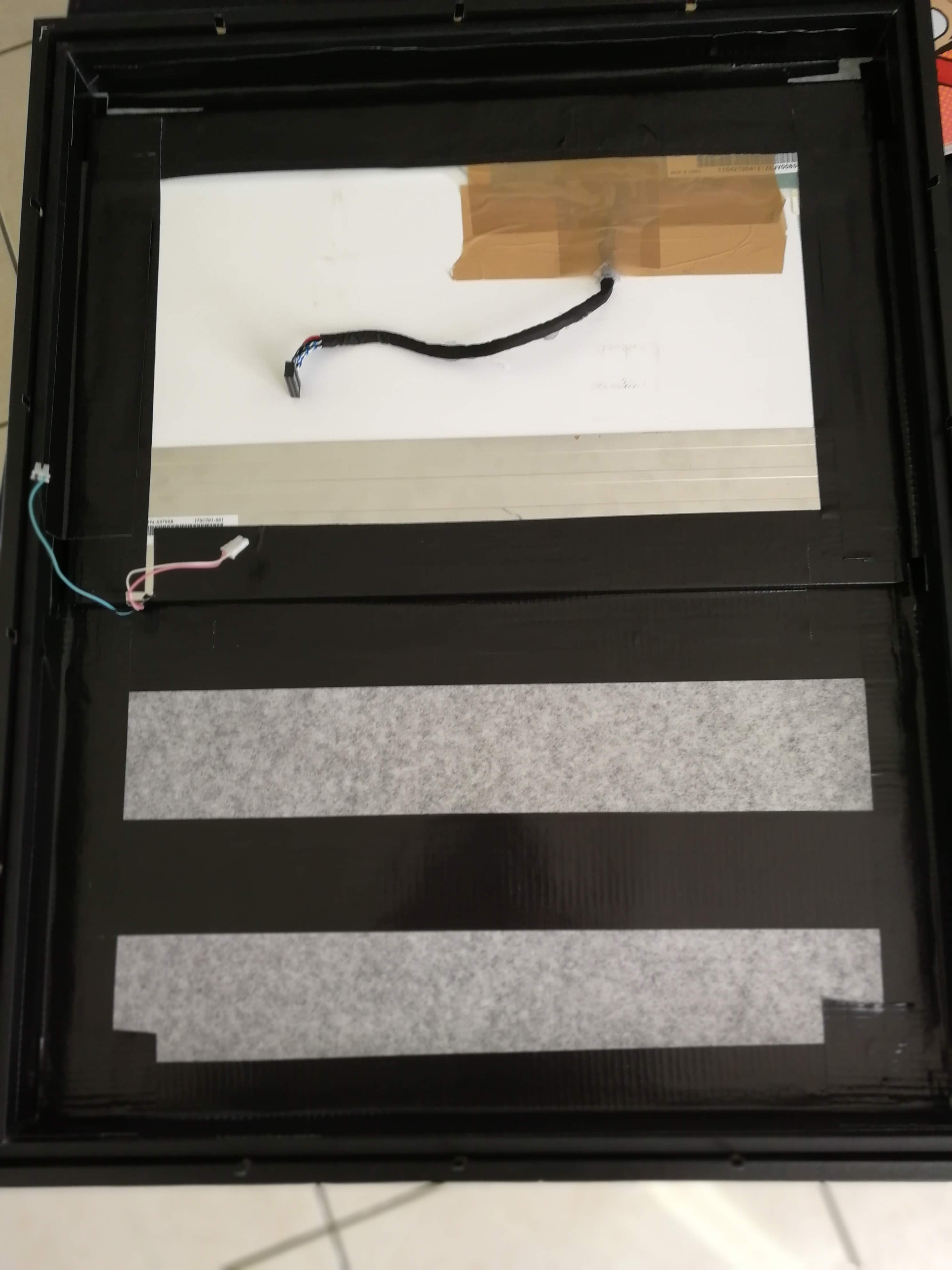

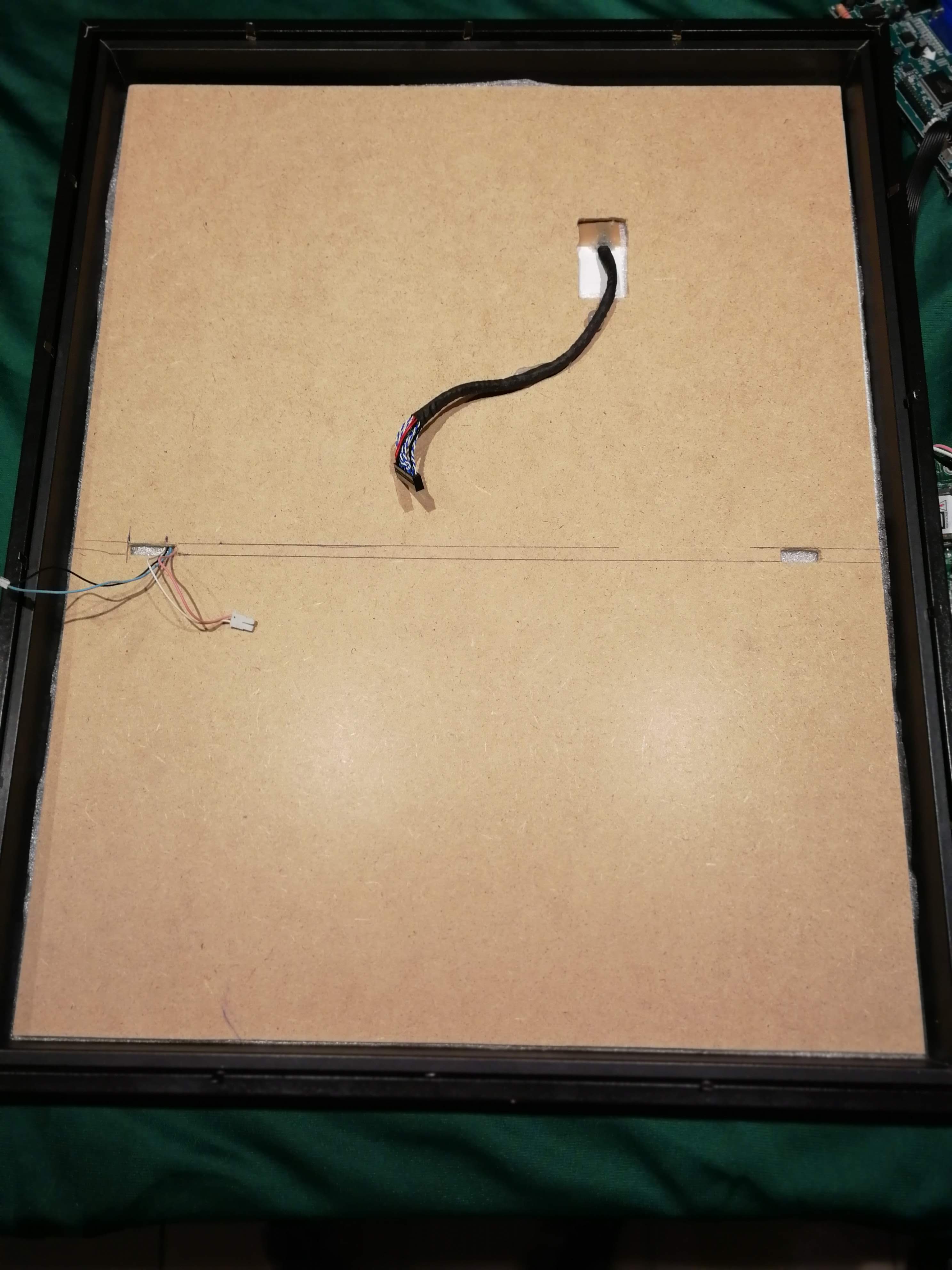

      I’m sharing my first attempt of my mirror build.

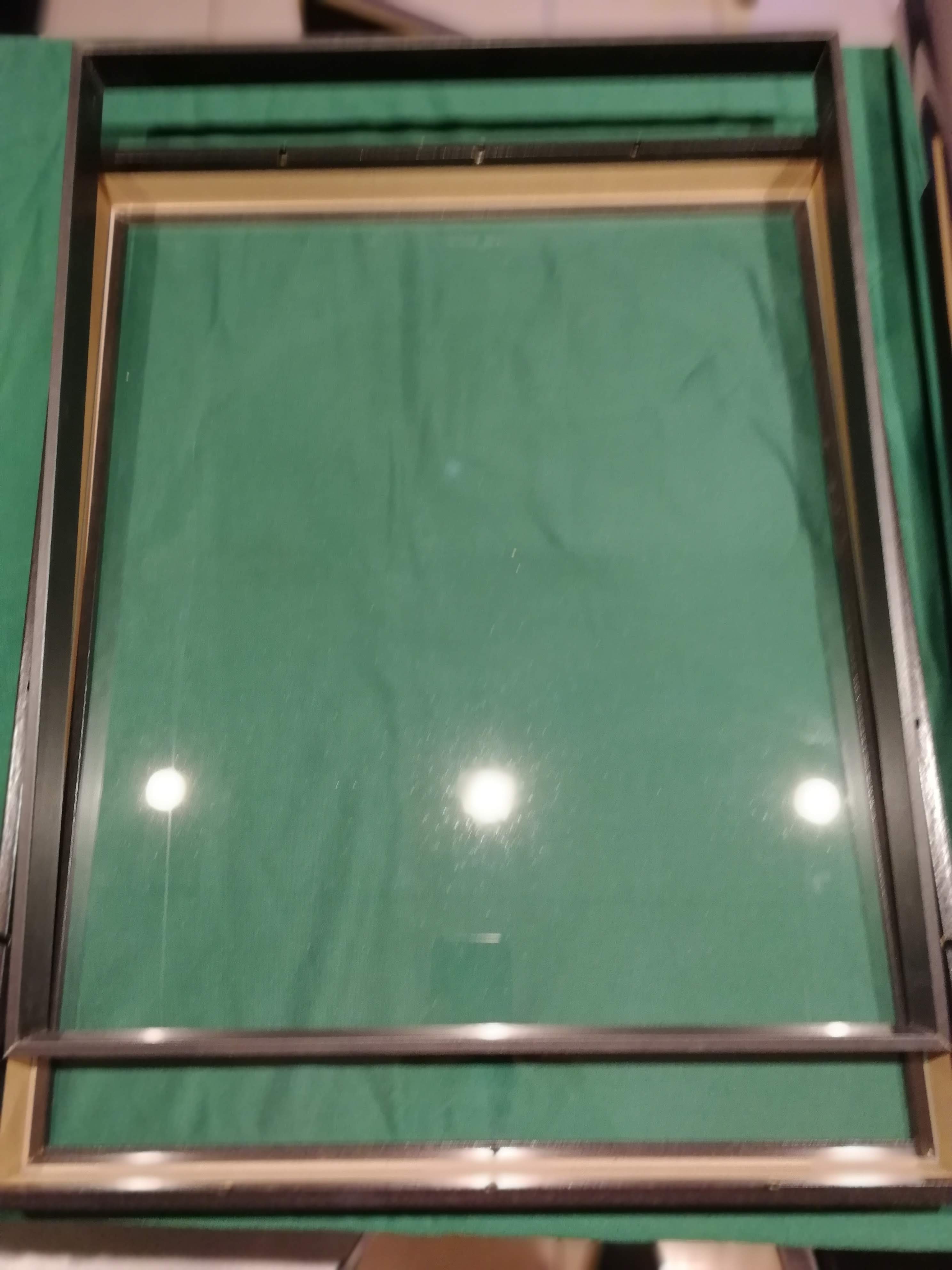

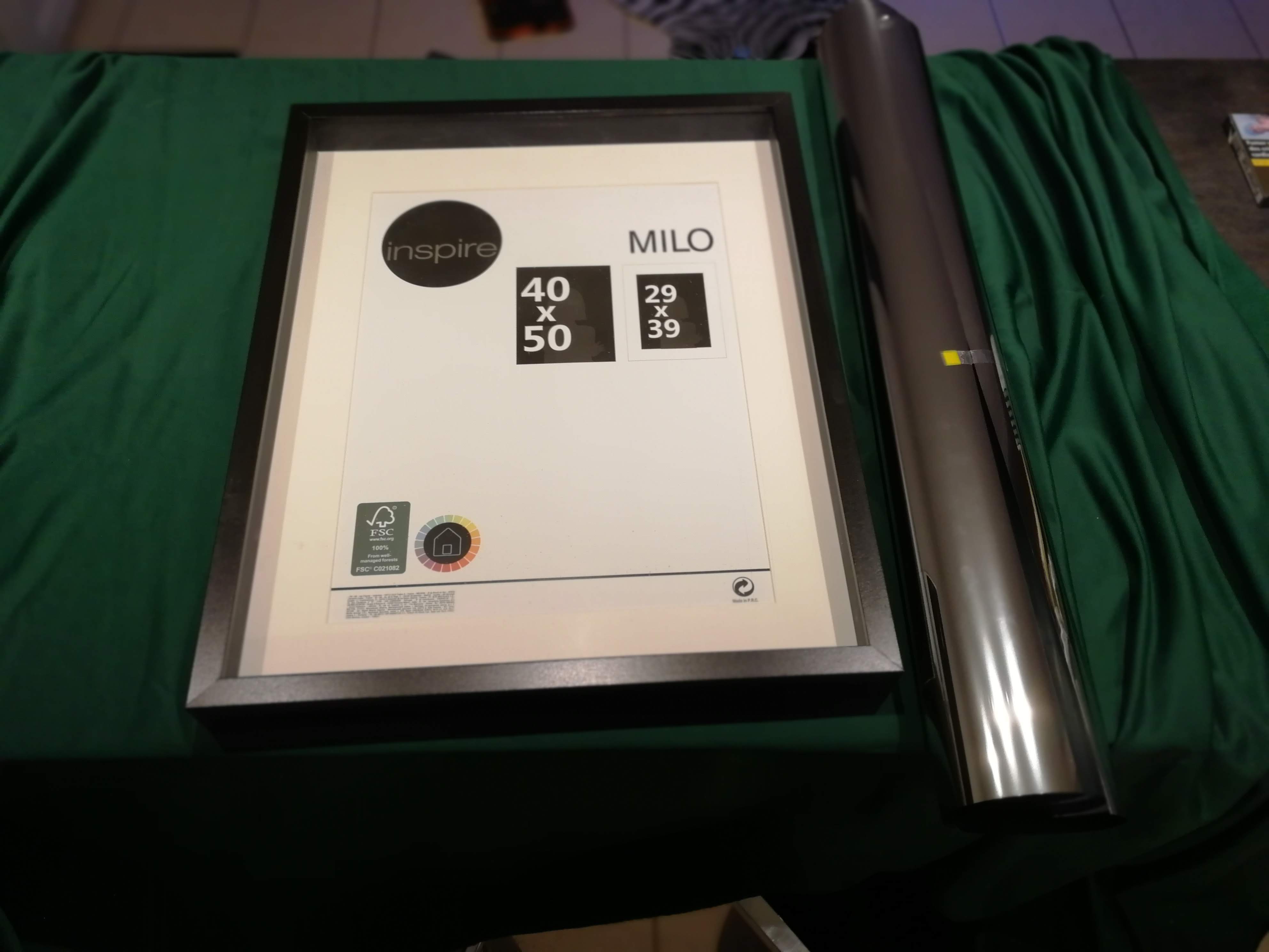

      I used a frame with some deep bought in Leroy Merlin .
      And added a mirror film on the glass . Look is ok, but I’ll redo it as I scratched it a bit at pose time.

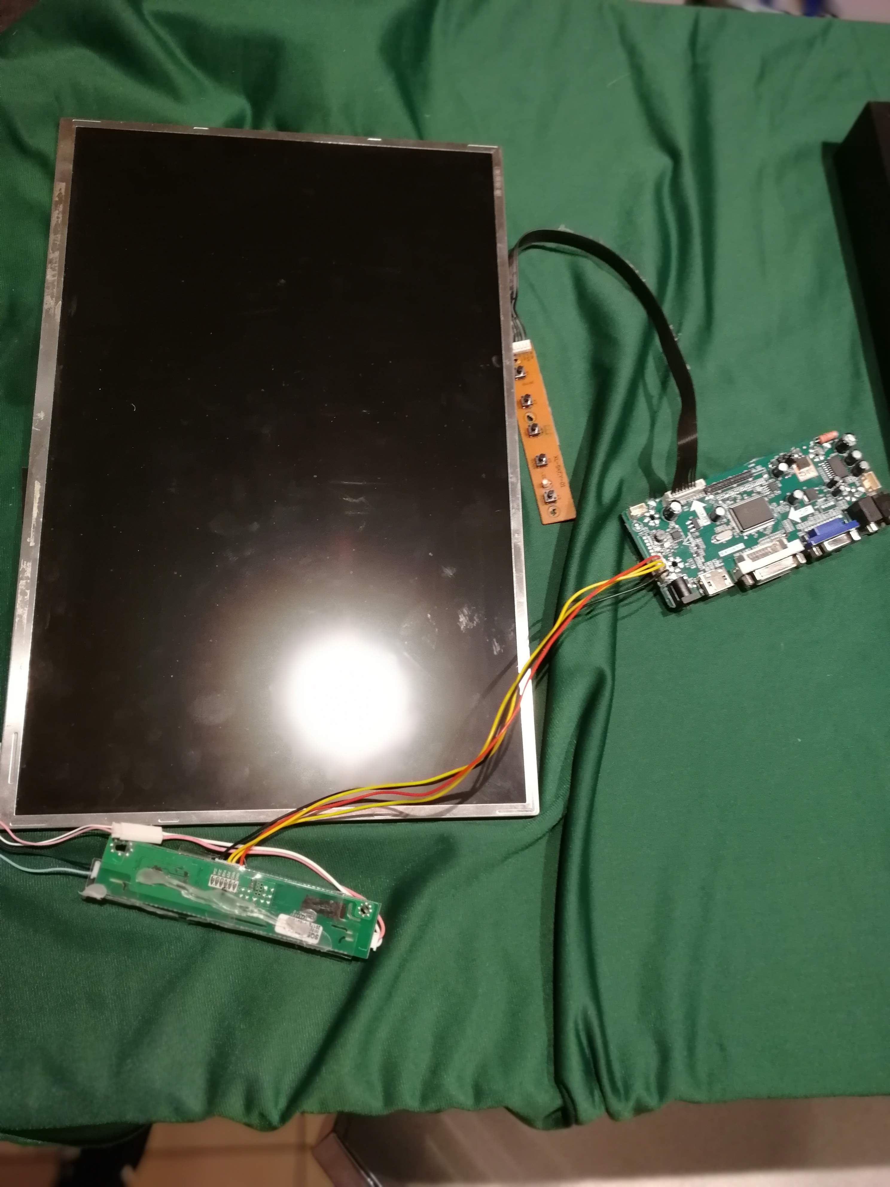

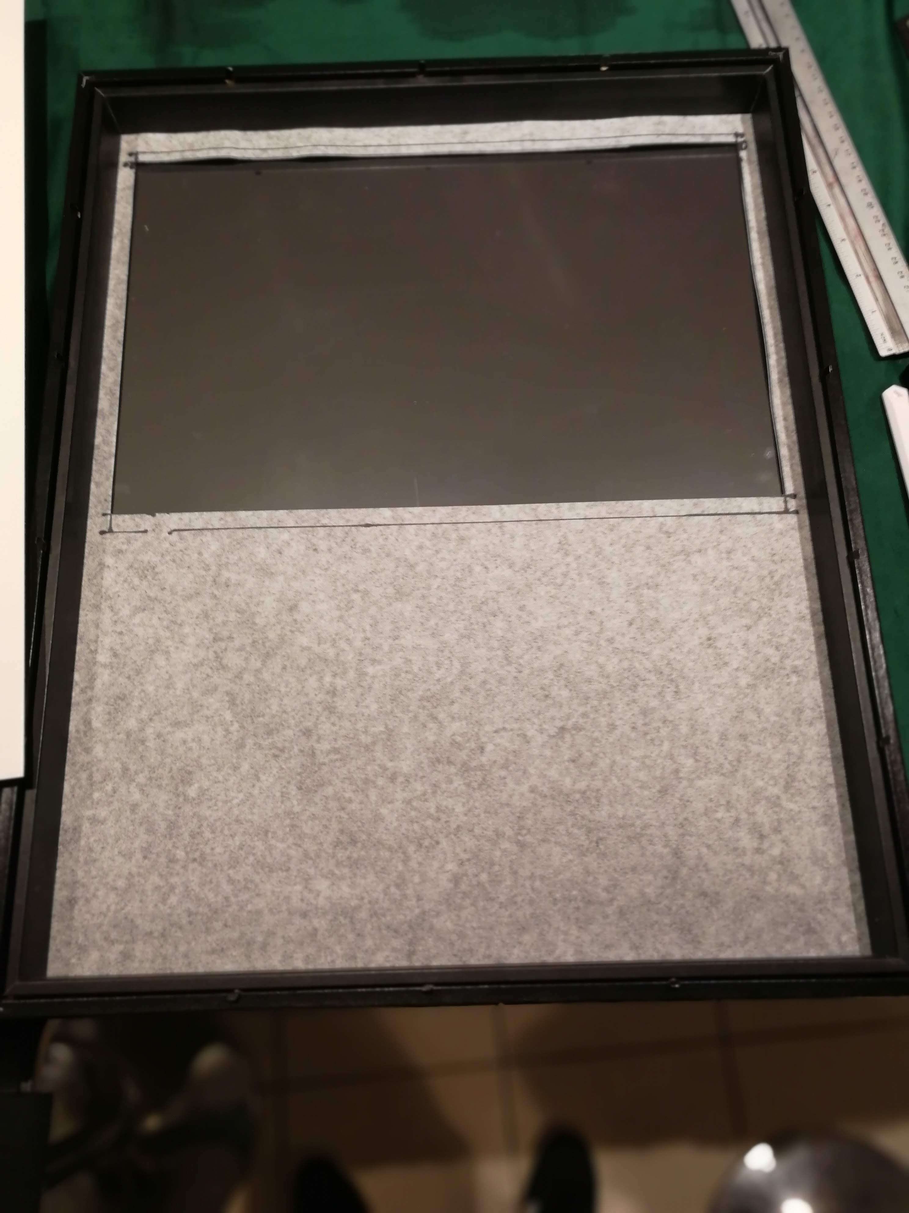

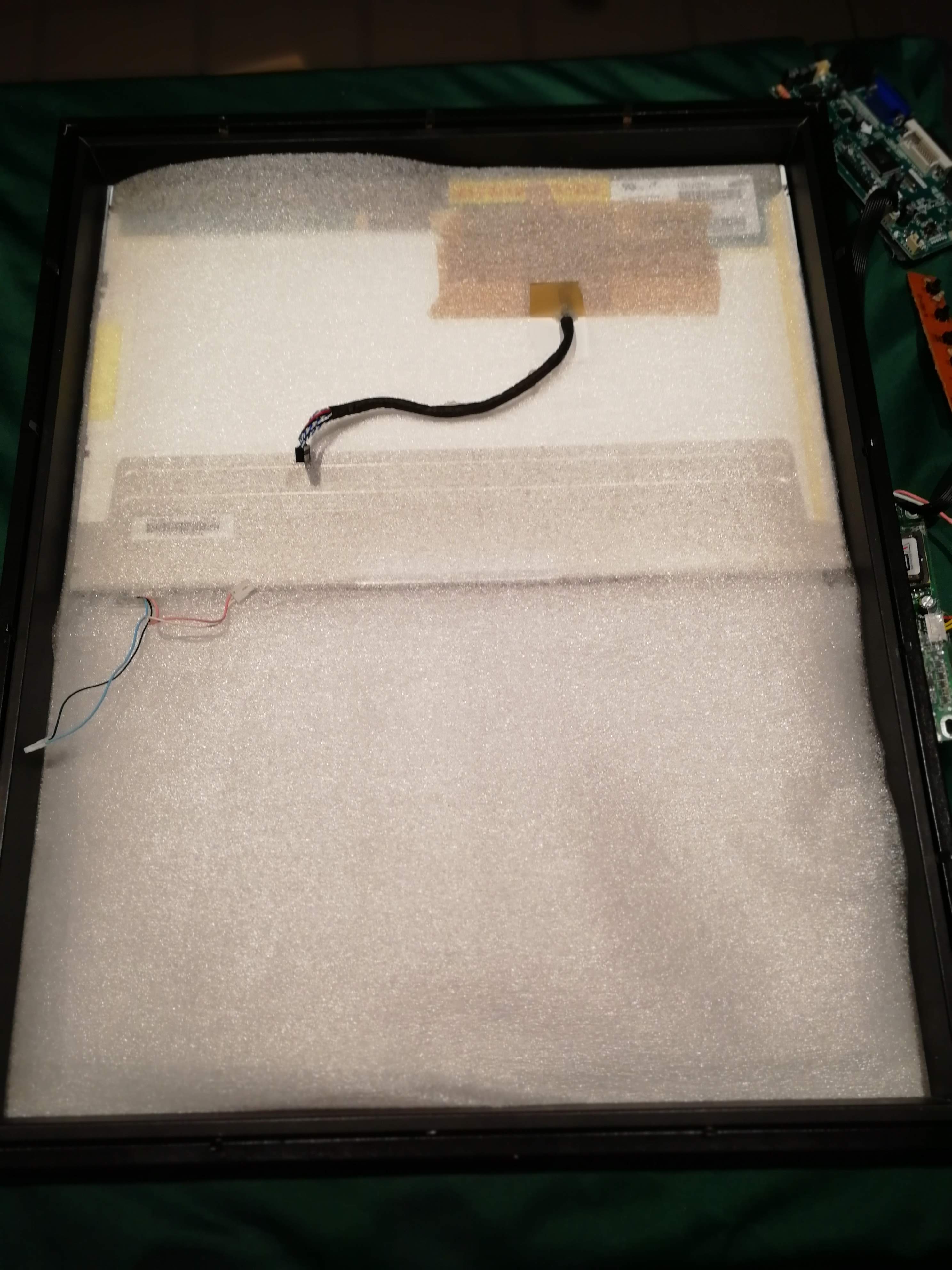

      Inside : A 17’ LCD I got from an old laptop .
      I bought a LDC controler on ebay to get the hdmi output and the power.
      A raspberry pi3B+
      1 wifi usb adapter with external antena to extend wifi range
      1 usb Fan, because my room can become very hot in summer ( this is just in case )
      1 micro sd extender so I can switch SD card from outside without opening the box.

      No speaker or amp connected .I pluged the 3.5mm jack out directly to my mix table who’s connected to the all sound system.
      That’s pretty it !
      As next step I’ll buy an additional frame and glue it to the first one to make the back more pretty .
