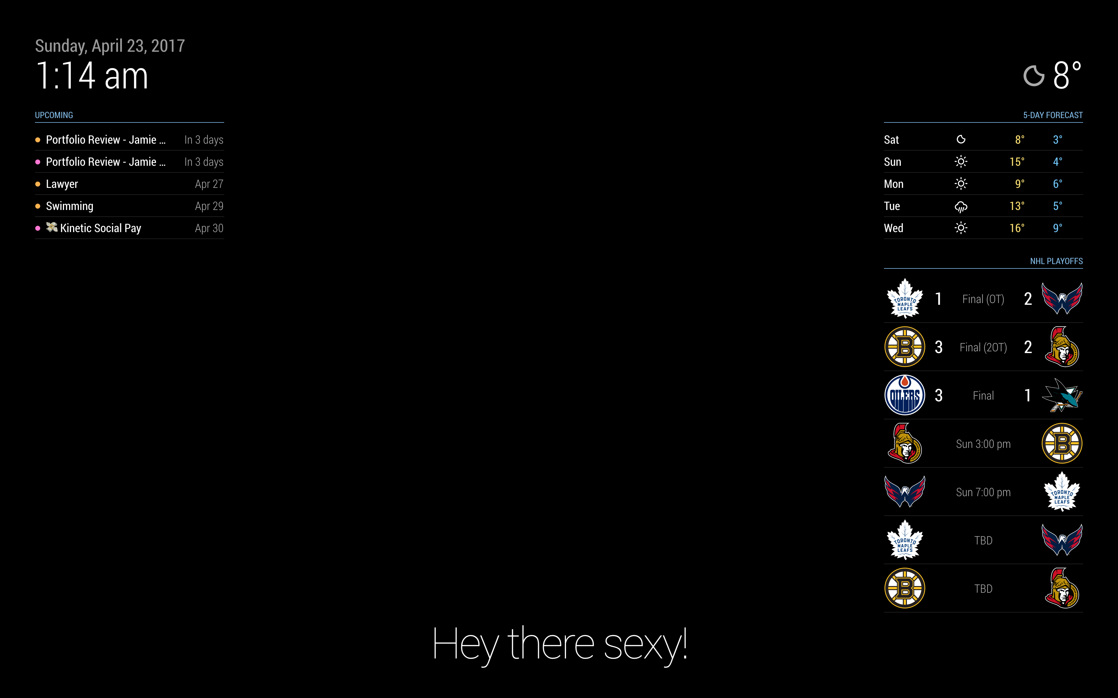

                        • J
                          j.e.f.f Project Sponsor Module Developer
                          I’ve been playing with this module during the playoffs, and I’ve found a few bugs that were causing this module to fail. I’ve fixed them in my local copy, but I don’t know how to go about getting them incorporated into the official download.
                          I’ve also changed the visual formatting for myself, and am willing to share if anyone wants it:
                          Thanks for this wonderful module! Been fun watching the playoffs and tweaking this at the same time. I’d like to make similar ones for other sports – NBA, MLB, CFL – and I’m willing to provide front-end formatting if someone would take care of coding the data fetch.
