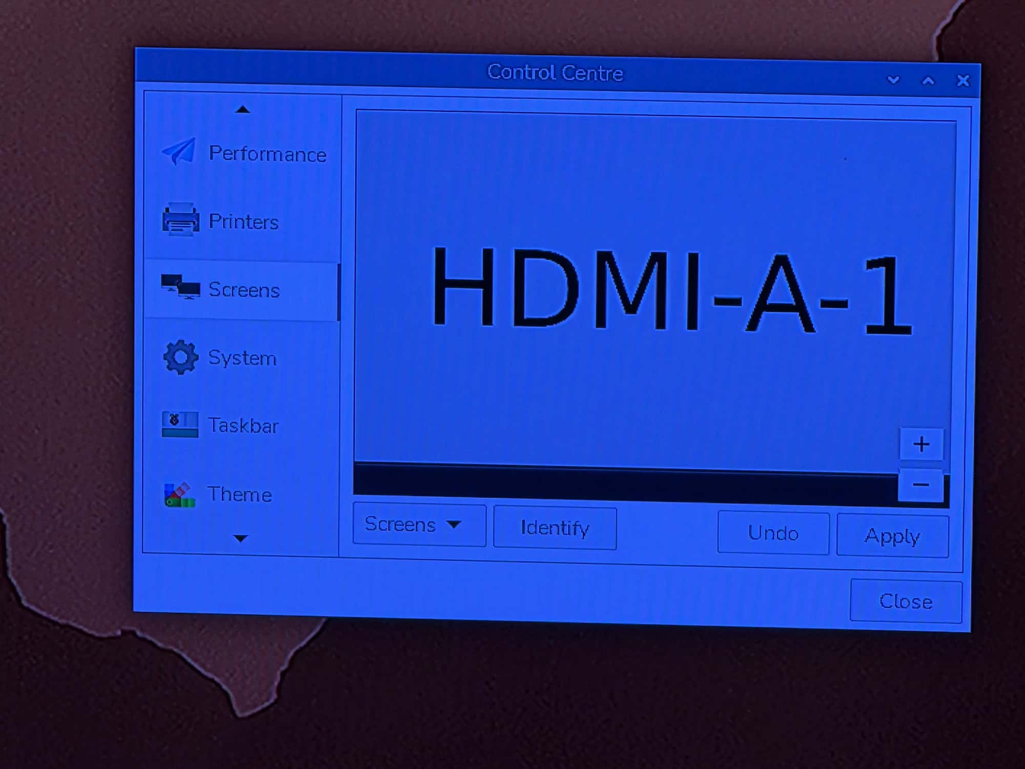

                      @bhepler Any continuation on this discussion? I’m in the same situation. Running Raspbian Debian GNU/Linux 13 (trixie) on Pi 4b, HDMI tv screen and there’s no Screen Configuration under Rpi Menu | Preferences.
                        sdetweil @TX77ConfigMirror
                        @TX77ConfigMirror its in the Preferences, Control Center , Screens
