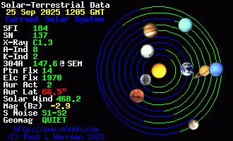

      Here’s the situation. I’m using MMM-iFrame currently (Tried others, same result) to display a PHP generated image. The data behind the image is refreshed approximately every 3-4 hours.
      The two urls I’m using is http://www.hamqsl.com/solarpich.php & http://www.hamqsl.com/solarsystem.php.
      for whatever reason, the images generated within electron on my pi are from the 25th of Feb, which is the first time I used the modules. On other systems, the current image is used which is 28 Feb 2021, 2248GMT.
      Is there any way to turn off the caching, or do whatever I need to do to get a fresh image every time?
