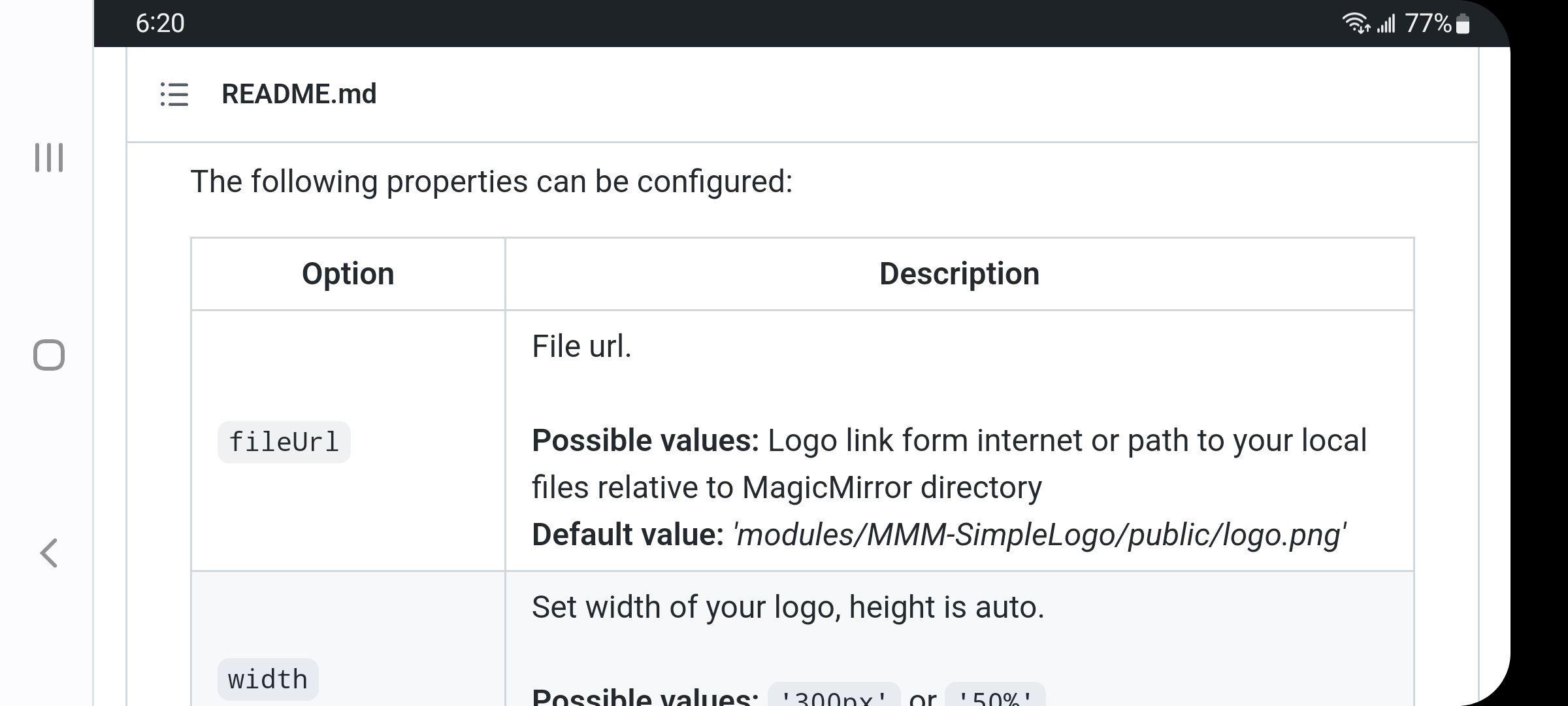

                        sdetweil @Bungle68
                        @Bungle68 it’s the module MMM-Simpke-Logo.
                        what does it expect for the file: parameter?
                        it’s actually fileUrl:
                        note that the image file must be IN the MagicMirror folder tree
