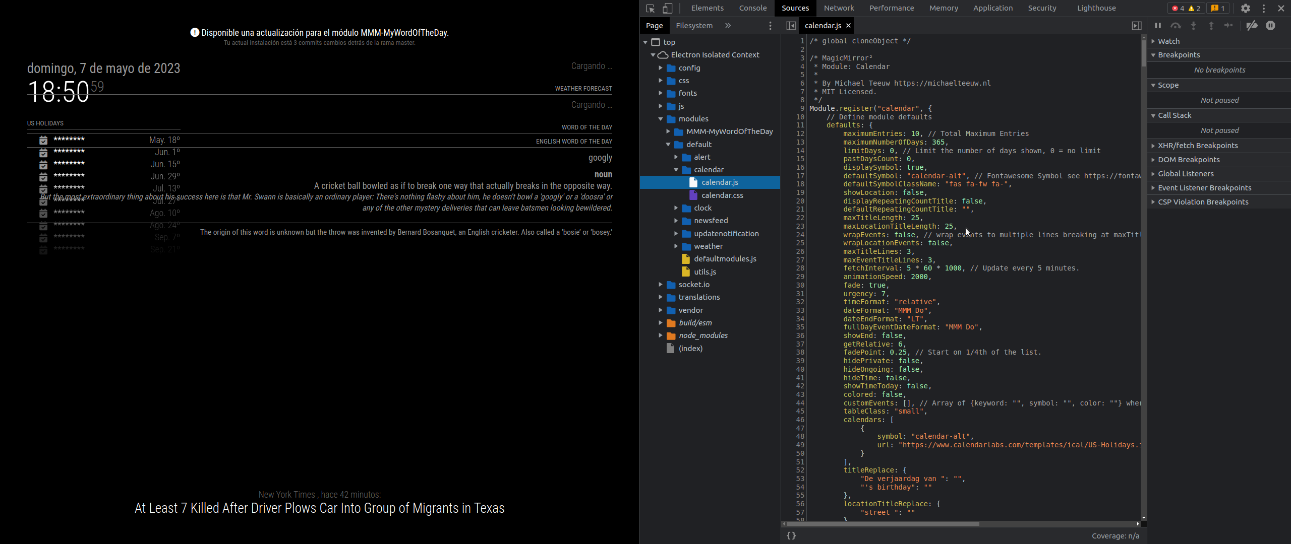

        sdetweil @l0zarus
        @l0zarus open the develpers window , ctrl-shift-i, then select the sources tab, modules in the left nav, and find your module
        click the number in the left nav for the 1st line under your getdom
        and then hit f5 to refesh the page and stop at your getdom function

              sdetweil @l0zarus
              @l0zarus magicmirror… of course

              • L Offline
                l0zarus @sdetweil
                @sdetweil well my module isn’t even in the modules folder even though it is in the config file which is confusing to me. I noticed in your screenshot that default is a subfolder of modules. That is true in my path to the module, but they are appearing as one combined folder. I’m not sure why that is the case. In any event, clearly my module was never actually loading at all. Any idea what the issue is here? I’ll start to update my code to remove the API call from the getDom function.
