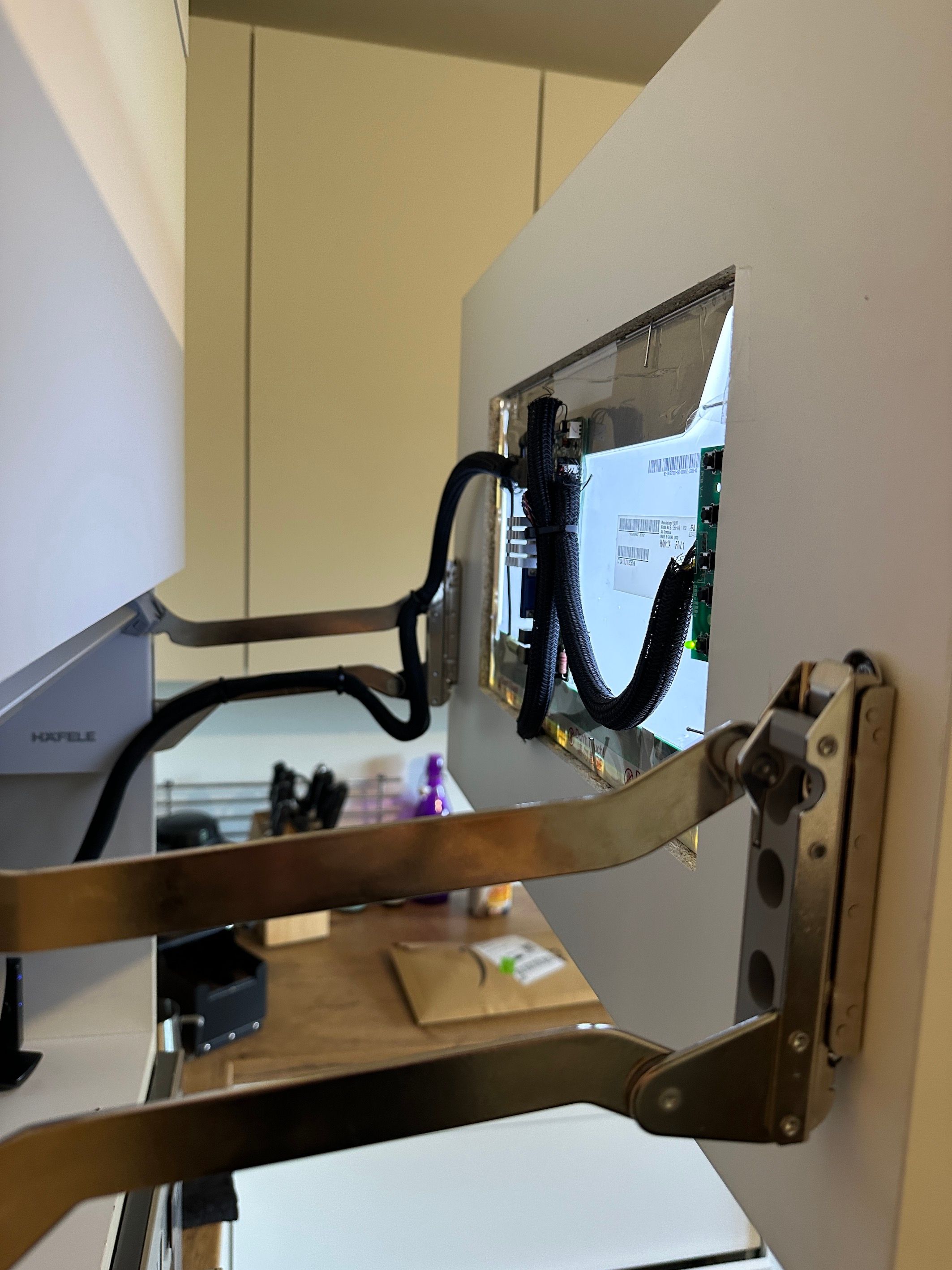

      I would like to introduce you to my Magicmirror solution, which is not a mirror at all, but our Kitchen Dashboard.
      The solution is built into a cabinet door that opens upwards.
      Realized with an LCD display from a old laptop, a LCD board and a Pi4.

        Is the assembly on back side so you can pull it forward to gain access to hardware?
        Ahh, it hides the microwave. That is slick.

          Great project 👍. Can you share more about the LCD board being used?

            here are Info´s for Screen and driver board
            LCD-Screen B156HW01 V.3
            https://datasheetspdf.com/pdf/719344/AUO/B156HW01-V3/1
            Driver Board M.NT68676.2
            https://de.aliexpress.com/item/4001166855347.html
            I hope the information is helpful
