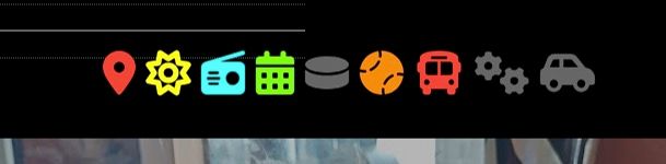

            Now, I have this images from Fontawesome. It looks nice, but I would like to be able to use other image if needed.

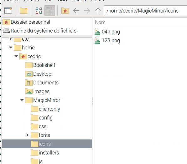

            For example, I would replace the “sun” with a picture “04n.png” in the “icons” forder on my raspberry.

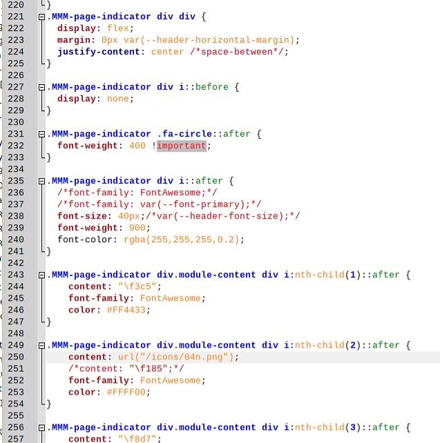

            I tried to change line 251 with 250 in the custom.css file
            Now, the result is, that the sun has disappeared (correct), but just has been replaced with a gap.
            do you maybe see a mistake in my custom.css file? the problem is maybe between lines 221 and 240. this is strange…

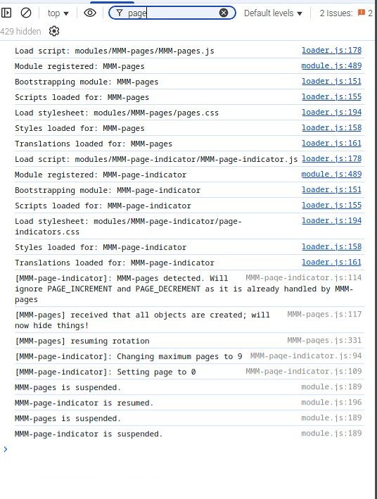

              @com1cedric can you open the developers window (ctrl-shift-i), select the console tab
              and put caro in the filter field to limit messages to the carousel module
              this info might be of help on the image selection

                karsten13 @com1cedric
                @com1cedric
                the /icons subfolder will not work, you have to use one of these

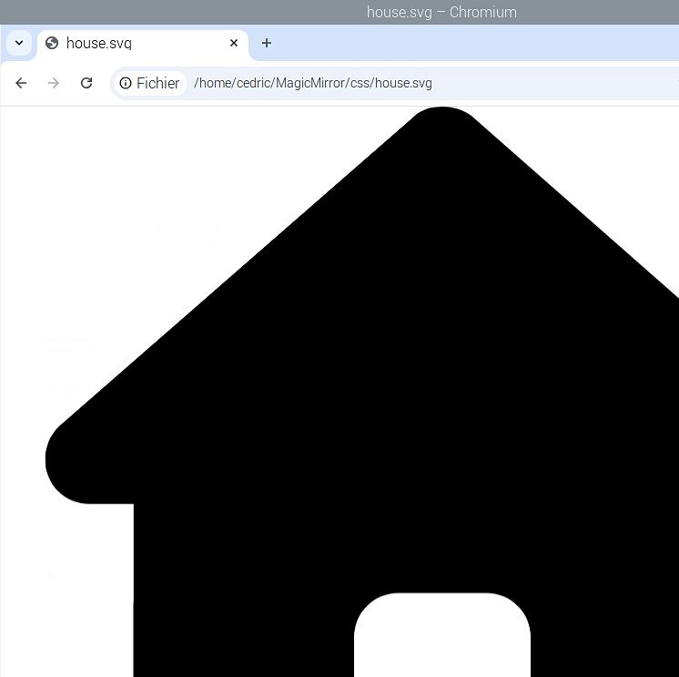

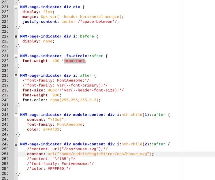

                    I tried it and put the image (downloaded from flaticon.com) on the CSS file
                    When I search for it in the Chromium browser (to be sure the URL is correct), it works
                    but when I put this path in the custom.css files, with full or shorten path, it does not appear…
                    in the console, I do not find anything suspicious (I only use mm-page and mm-page-indicator, and no carrousel).

                      sdetweil @com1cedric
                      @com1cedric again, we wont load the file path url,
                      /home/… in not one of out supported folders
                      it has to be MagicMirror web server based , from the MagicMirror folder as root (/)
                      url('/css/house.svg')

                        I did a test with default calendar and custom.css:
                        .calendar div.module-content::after {
                          content: url("/css/k13.svg");
                        or
                        .calendar div.module-content {
                        which works (svg is visible).
                        So maybe something with your css concerning the child-stuff is wrong (my css knowledge is to bad to help here)
