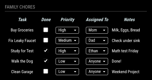

                        UPDATE: Version 4 (February 2026)
                        • Checkboxes and dropdowns are now supported. Additionally, they are interactive (if you change a checkbox or dropdown on the mirror, it will make that same change on the spreadsheet. This should allow for fully-customizable self-built modules and advanced spreadsheet interaction!
                        Check out the README for more info.
                        Example Image (all of the checkboxes and dropdowns are editable and link back to the spreadsheet):
                        W 1 Reply Last reply
