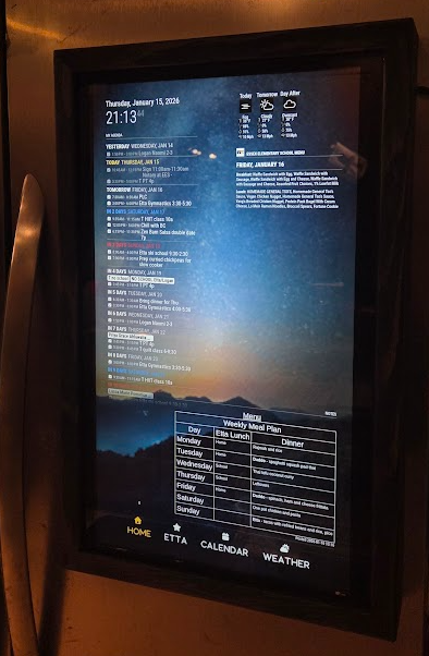

                          Hey everyone! Just released v1.1.0 with some nice updates:
                          New Features:
                          • Responsive scaling - module automatically adapts to fit any region width
                          • Multi-column layout for full-width positions (top_bar, bottom_bar, upper_third, etc.)
                          • Position-aware styling - right-aligned headers when placed in right positions
                          Fixes:
                          • Fixed lookAhead logic to properly trigger on endDay after hideTodayAfter time
                          Improvements:
                          • Removed axios dependency - zero runtime dependencies now, just clone and go!
                          • Added ESLint config and dependabot for better code quality
                          Screenshots of the new layouts in the README:
                          https://github.com/ElliAndDad/MMM-MealViewer
