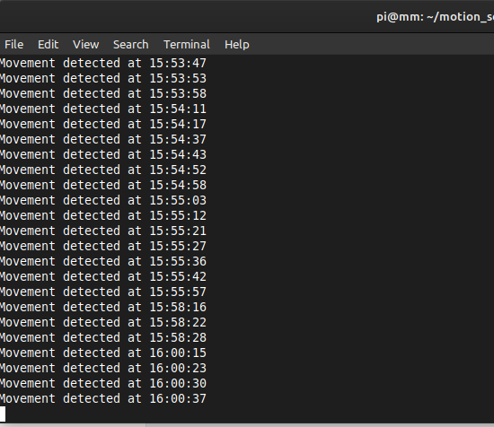

                                      @sdetweil said in Bugsounet and MMM-Pir:
                                      @lif have you verified that the PIR is working outside of MagicMirror??
                                      Yes,
                                        sdetweil @lif
                                        @lif and you are using the correct pin definition
                                            Pir: {
                                              mode: 0,
                                              gpio: 21
                                        L 2 Replies Last reply Reply Quote 0
                                        • L Offline
                                          lif @sdetweil
                                              Pir: {
                                                mode: 0,
                                                gpio: 21
                                          Yes, the working script is:
                                          from gpiozero import MotionSensor
                                          from datetime import datetime
                                          import os, time
                                          import RPi.GPIO as GPIO
                                          pir = MotionSensor(21)
                                          while True:
                                              pir.wait_for_motion()
                                              now = datetime.now()
                                              current_time = now.strftime("%H:%M:%S")
                                              print("Movement detected at", current_time)
                                              pir.wait_for_no_motion()
