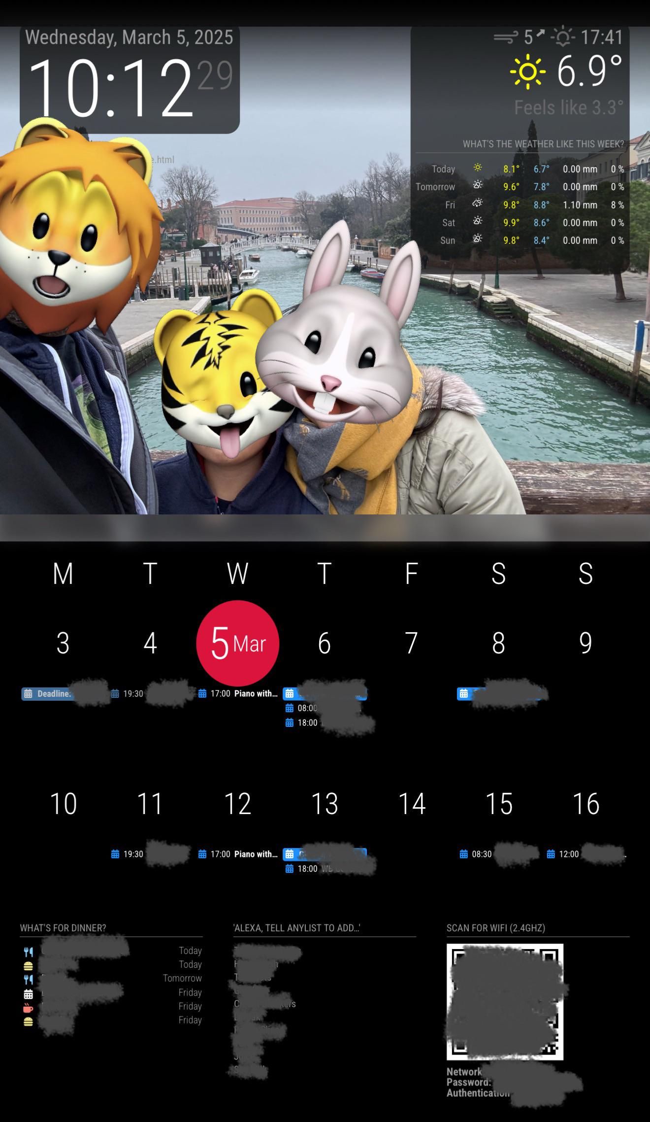

      Sorry for yet another boring family dashboard, but I thought I’d share the progress I’ve made so far with making MMM-CalendarExt3 look like the calendar module in Dakboard.
      I haven’t decided which modules I’ll keep for sure (I was having some compatibility issues between certain combinations) but the other ones you can see here are:
      • Clock (standard)
      • Calendar (standard by invisible)
      • Weather (standard)
      • MMM-AnyList (because we use AnyList for everything)
      • MMM-WiFiPassword (for guests to access the wifi without bothering me)
      • MMM-Remote-Control (for me to issue shutdown request via my phone)
      I’m looking into building the mirror/frame next, as well as the necessary modules to give me a physical safe-shutdown button and any other physical controls that might be needed, depending on how much bloat I build into this device.
      I’d really like to have an alternative to the standard weather module — perhaps to look more like the Dark Skies app or even the old yellow-and-blue Meteo weather app with the graphs, but sadly I’d have to develop my non-existent node.js skills before I could even consider building my own modules.

              • C Offline
                com1cedric @QuackingPlums
                @QuackingPlums hello, nice work ! how did you manage to make your calendar DAK like? Kind regards.
                Q 1 Reply Last reply Reply Quote 0
                • Q Offline
                  QuackingPlums @com1cedric
                  @com1cedric Hi, and thanks!
                  It took me a fair bit of trial and error since I’m not really an FE dev! This is the part of my custom.css that deals with MMM-CalendarExt3:
                  https://codeishot.com/3ukwf76l
                  I’ve only tested it with my specific screen and with the MMM-CalendarExt3 module in the two-week mode that is shown above. Other configs may break it — I notice that if I open the URL in a browser tab on my laptop then the red circle gets squashed, so it’s probably very much dependent on the screen size and possibly even the pixel dimensions.
                  I should come back and take another look at that at some point.
                  I also had to make a tiny tweak in the MMM-CalendarExt3.js file to allow single-character day-of-week initials, because I couldn’t work out how to change that in the config:
                  headerWeekDayOptions: {
                      weekday: "narrow" // ##### EDITED FROM "long" #####
