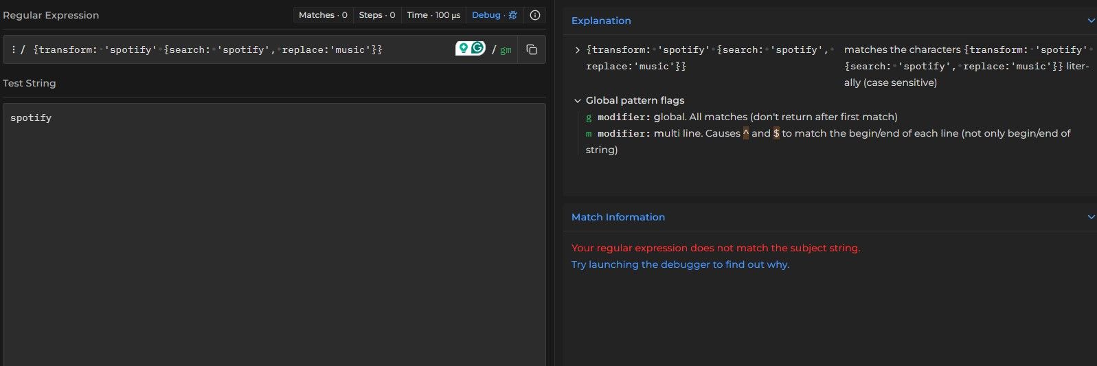

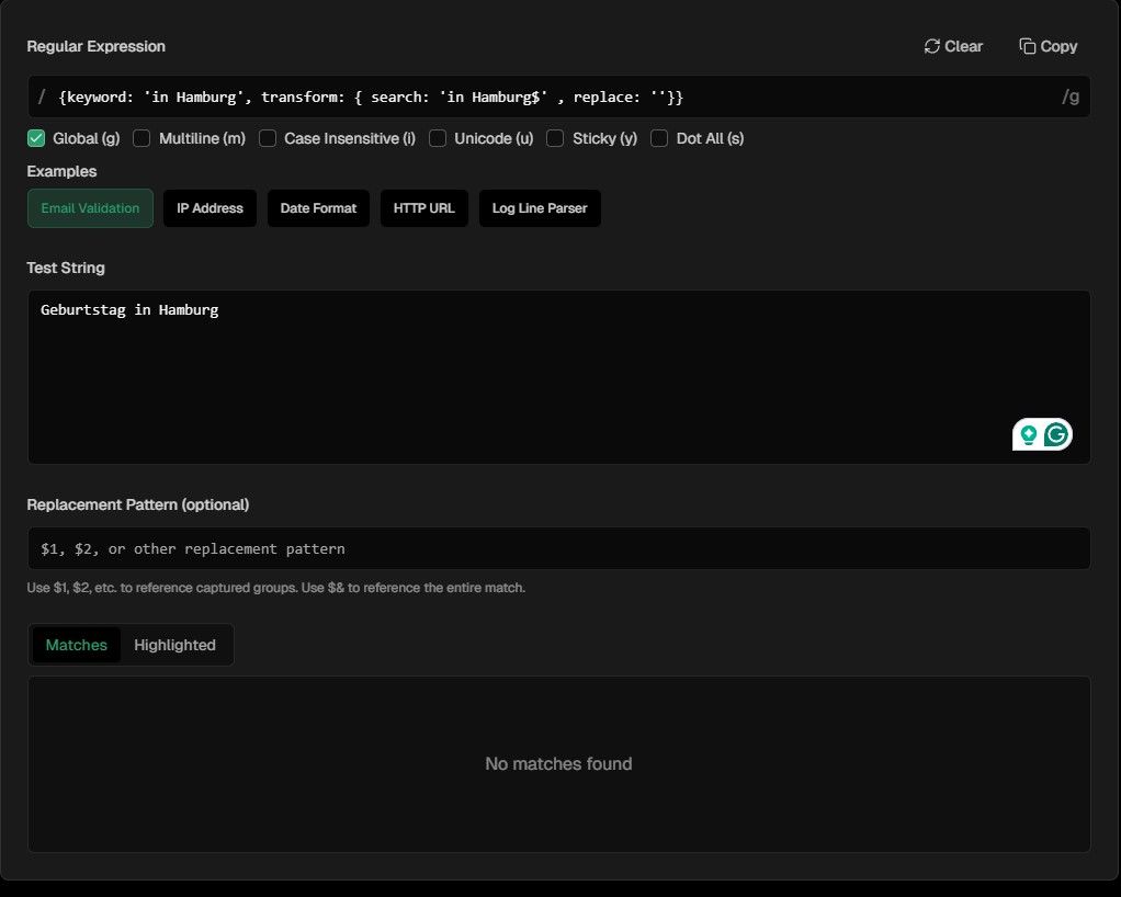

                Sorry for the delayed response. Work and life got in the way. I went to the regex tester and used the example from the calendar config for customEvents {keyword: ‘in Hamburg’, transform: { search: ’ in Hamburg$’ , replace: ‘’}} and I could not make it work as per the example in the documentation.
                (https://fossa.com/resources/devops-tools/regex-tester/)
                I also tried the other checker with a simplier transform.
                (https://regex101.com/)
                I am struggling to understand what I am doing wrong.
                Your help is appreciated.
                  The ‘Regular Expression’ is your ‘search’ from the config line, hence ‘in Hamburg$’.
                  The ‘Replacement Pattern’ is your ‘Replace’ from the config line, hence ‘’ (nothing)
                  The ‘Test String’ is what is triggered by your ‘keyword’ so in this case ‘Geburtstag in Hamburg’ will trigger the search and replace.
                  So, fill in:
                  Regular Expression: in Hamburg$
                  Test String: Geburtstag in Hamburg
                  Replacement Pattern: ‘’
                  Then your Match will be ‘in Hamburg’ and your Highlighted will be ‘Geburtstag’ (that what remains white).
                  For testing search & replace on https://regex101.com, you will need to choose Function - Substitution on the left side.
                  Regular Expression: .in.Hamburg$
                  Substitution:
                  This will result in: Geburtstag
                  This will only match on ‘in Hamburg’, so to make it more flexible you will need to make use of so called grouping:
                  Regular Expression: (Geburtstag).+$
                  Substitution: $1

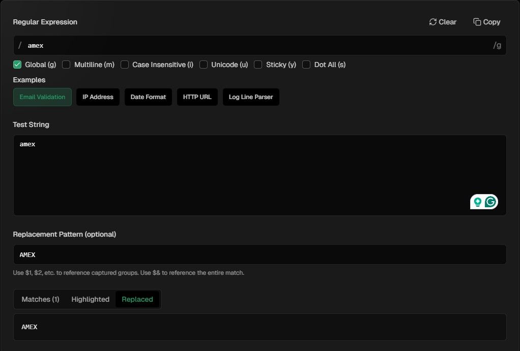

                    In my calendar I have “amex” typed in lower case and I want the transform it to upper “AMEX” to show this works.
                    However when I use the below code on a calendar event that only has an event titled ‘amex’ in lower case does not work.
                    {keyword: 'amex', transform: { search: 'amex', replace: 'AMEX'}},
                    This simple thing is confusing me. I have removed all variables, and it still does not work.
                    Thanks again for everyone help.
