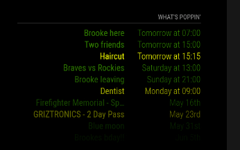

      @sdetweil I think I might’ve just found its related to the month / week views of Ext3…
      This is how I have it now:
      			classes: "page0",
      			header: "What's Poppin'",
      			   colored: true,
      						color: 'yellow',
      						fetchInterval: 7 * 24 * 60 * 60 * 1000,
      						symbol: "calendar-check-o",
      						url: "basic.ics"
      						color: 'green',
      						url: "webcal"
      When I separate them to two instances, this is the code I have:
      			classes: "page0",
      			header: "XX Calendar'",
      			   colored: true,
      						color: 'yellow',
      						url: "basic.ics"
      			classes: "page0",
      			header: "YY Calendar'",
      			   colored: true,
      						color: 'green',
      						url: "webcal"

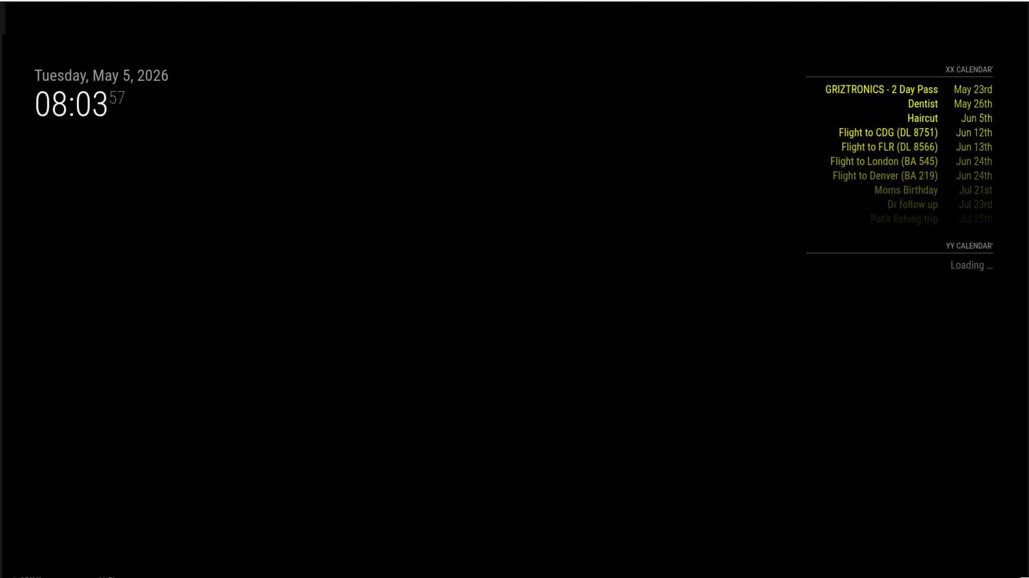

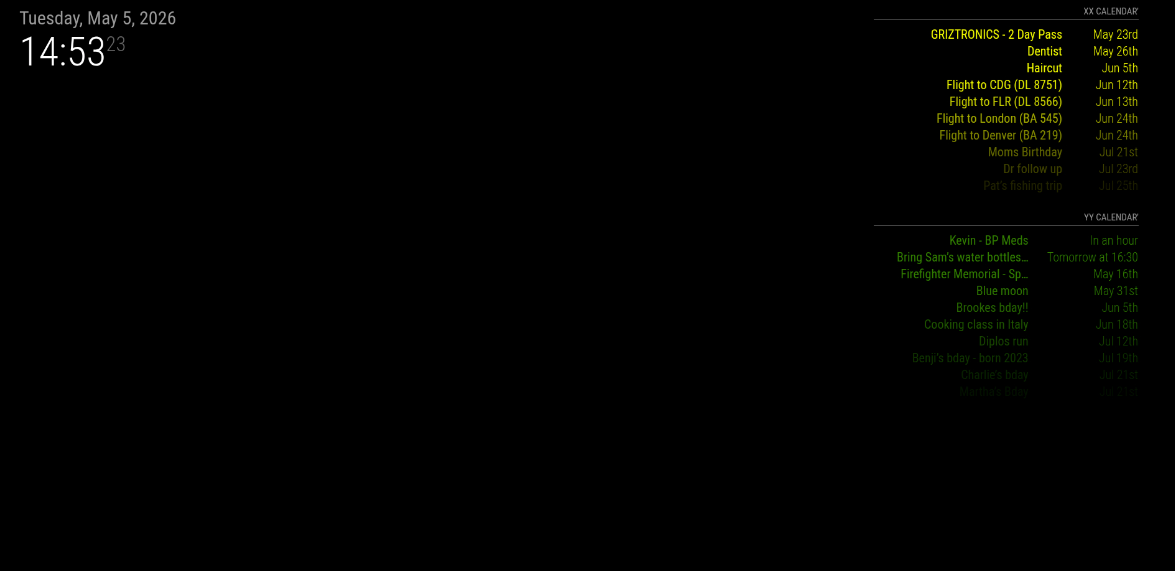

      And without the Pages module, I do get both to load
      I went to add Pages back in with the two calendar instance configuration and have EXT3 on week mode, the second calendar stream does not load
      And still no color on calendar view on the second page
      But then if I switch to month mode in EXT3 streams are loading in and some colors work - but there’s still two events (from the XX calendar) that loaded but did not get color applied.
      As I’ve been messing with it, sometimes on the first run it will load both calendar streams when its in week mode, but it usually doesn’t load it after it runs once. Sometimes in month mode, it still doesn’t load the second calendar, so its not 100% accurate

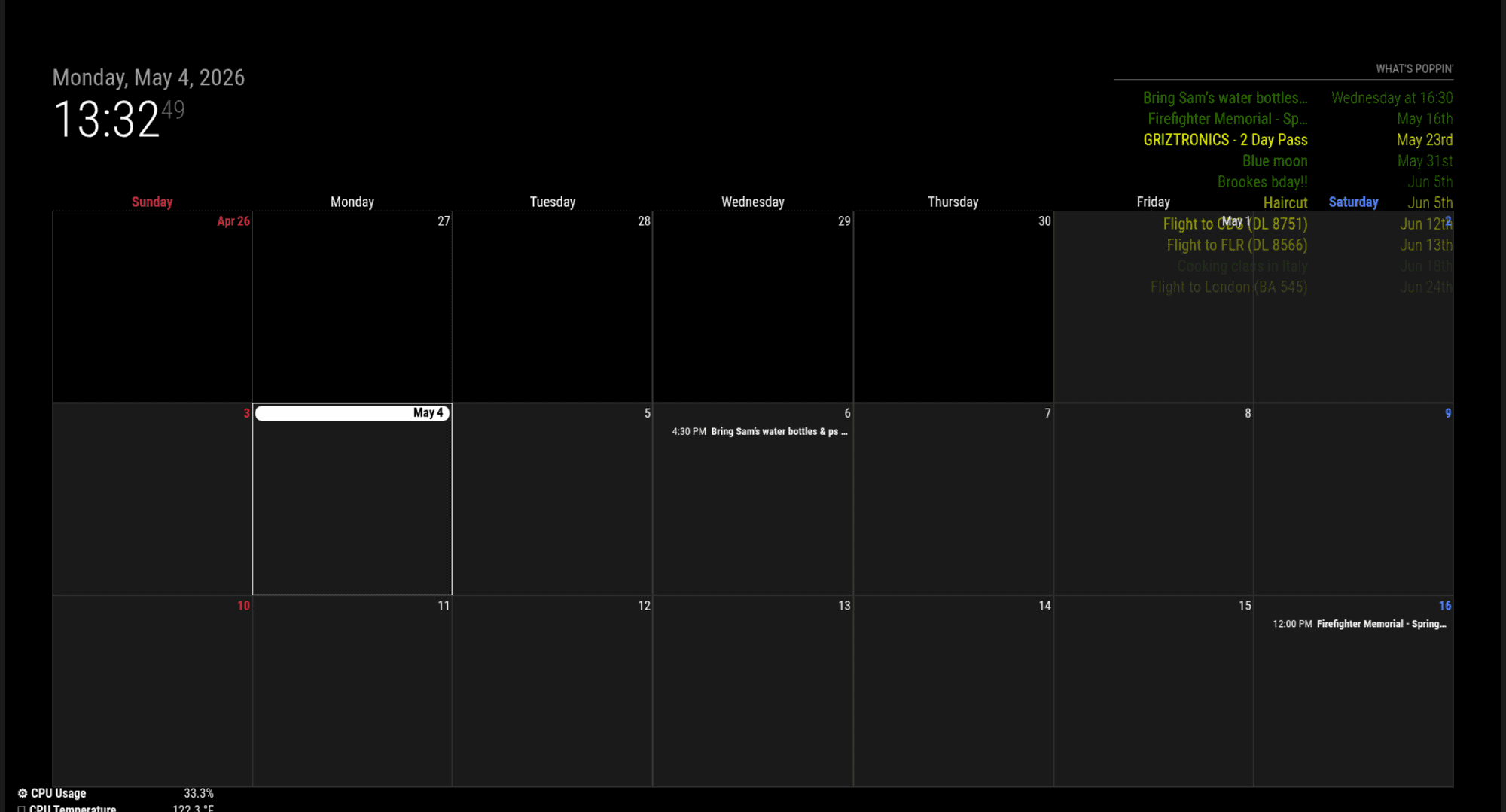

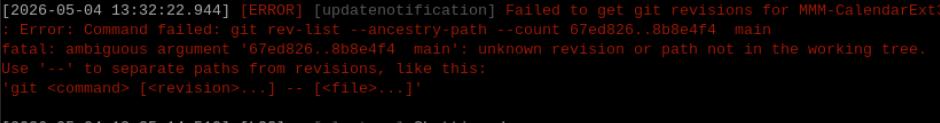

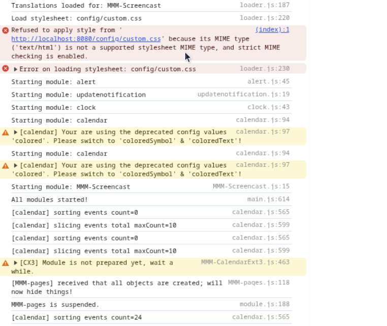

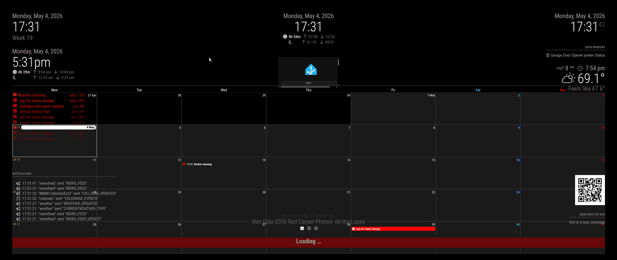

          @sdetweil I’ll keep messing with coloredText, so far everything is staying white when I use that. Here is the errors I’m seeing
            sdetweil @kkmirr04
            @kkmirr04 custom.css not loaded just means there isn’t one. (The default as MagicMirror installed)
            If you had used the scripted install it would have created an empty one so this error wouldn’t be there
            There is the colored vs coloredText, coloredSymbol warning
            No Obvious other errors in that part
            Calendar sorting events=0, means there weren’t any?

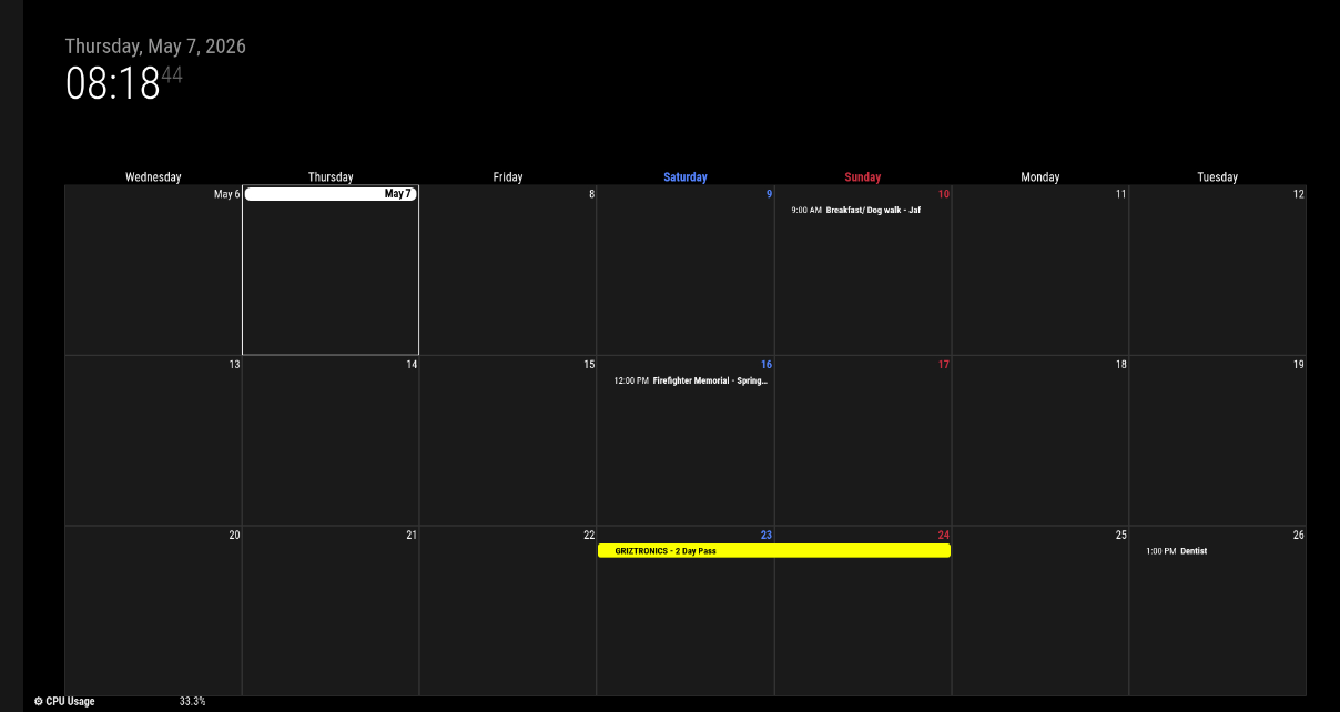

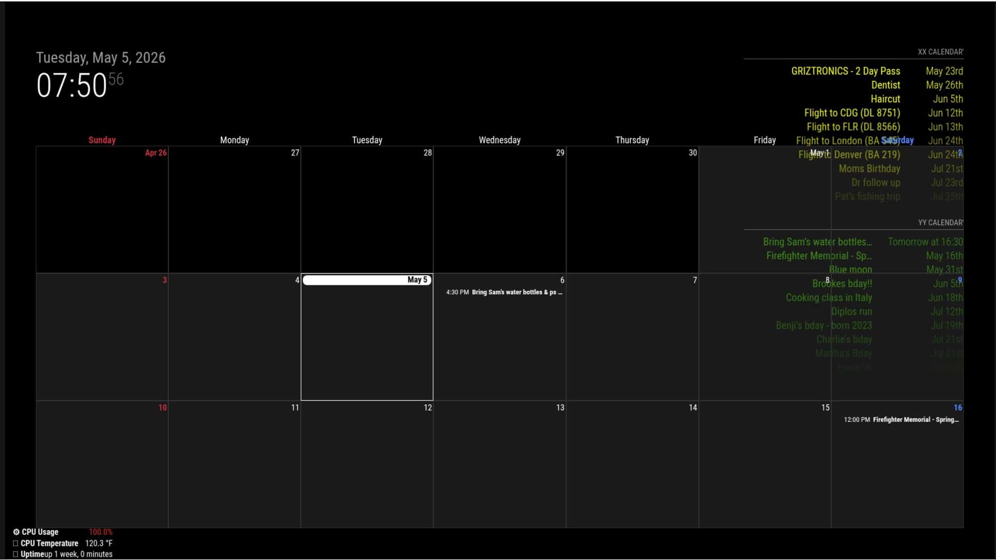

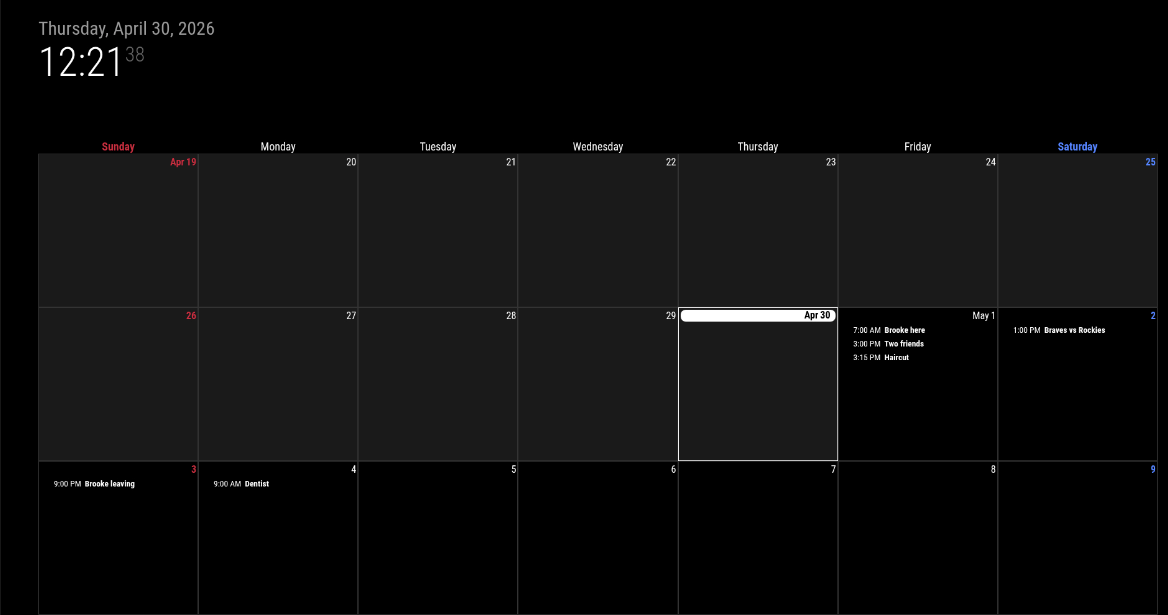

              kkmirr04 @sdetweil
              @sdetweil with both disabled it did draw both instances with color
              Then turning EXT3 back on I’ve got no color on any events again

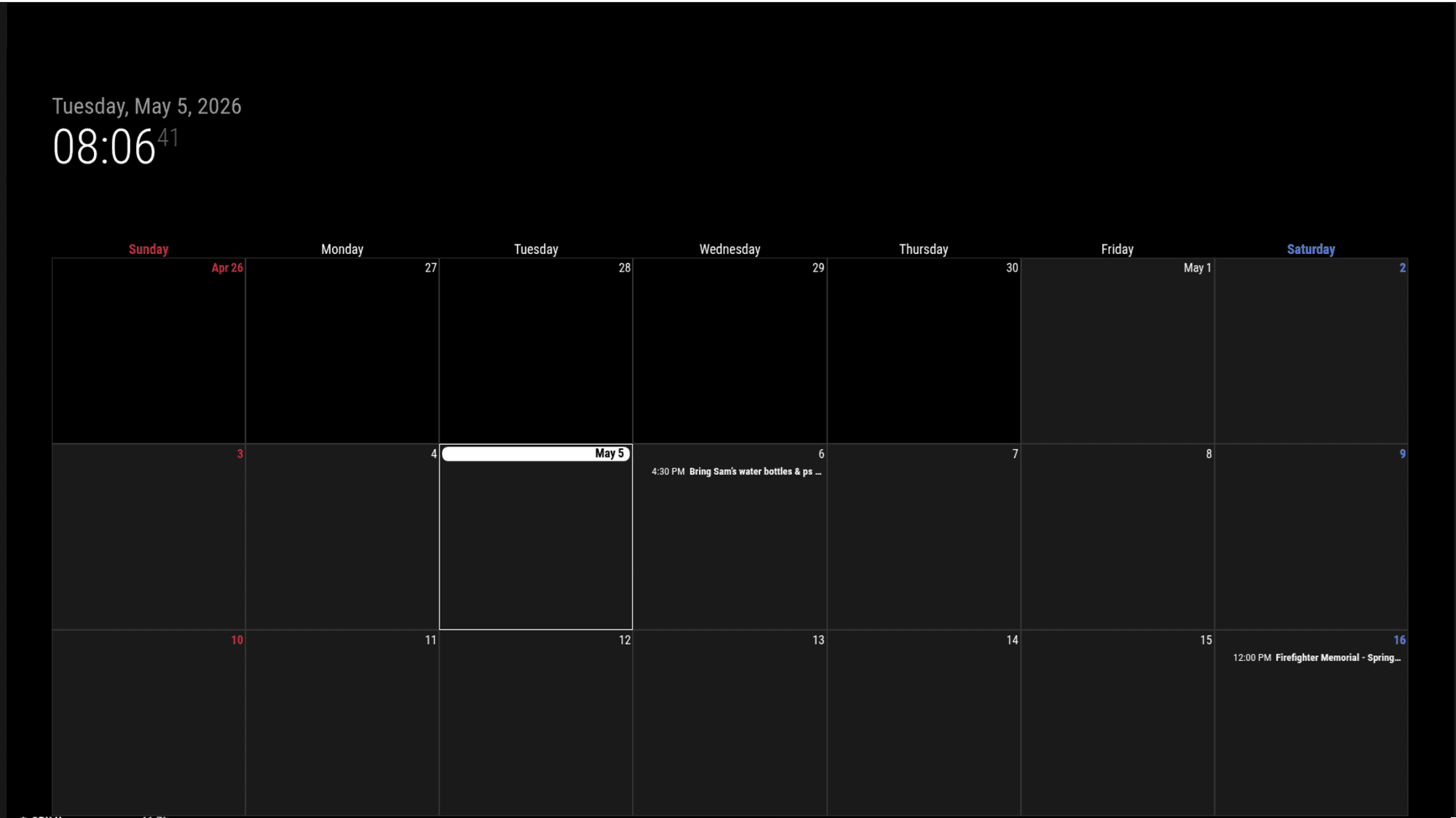

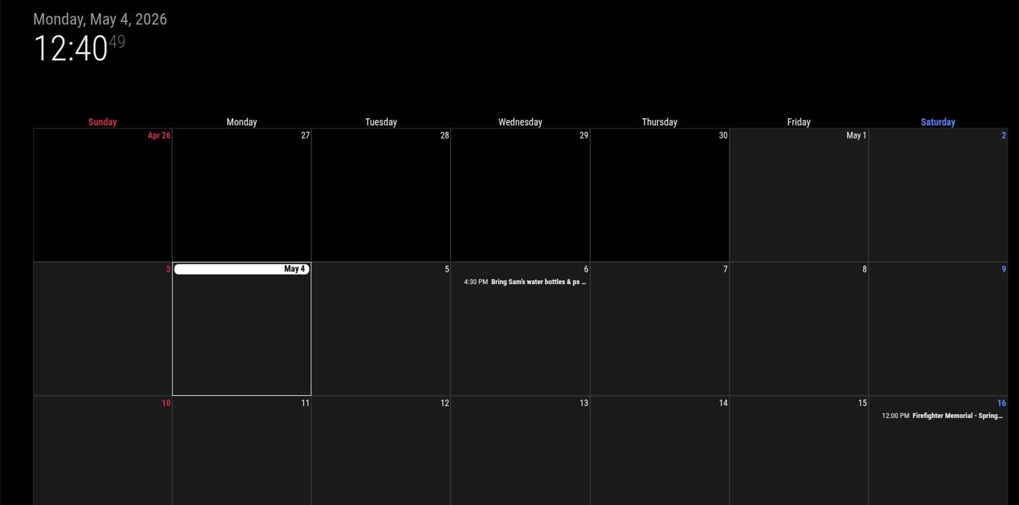

                  kkmirr04 @sdetweil

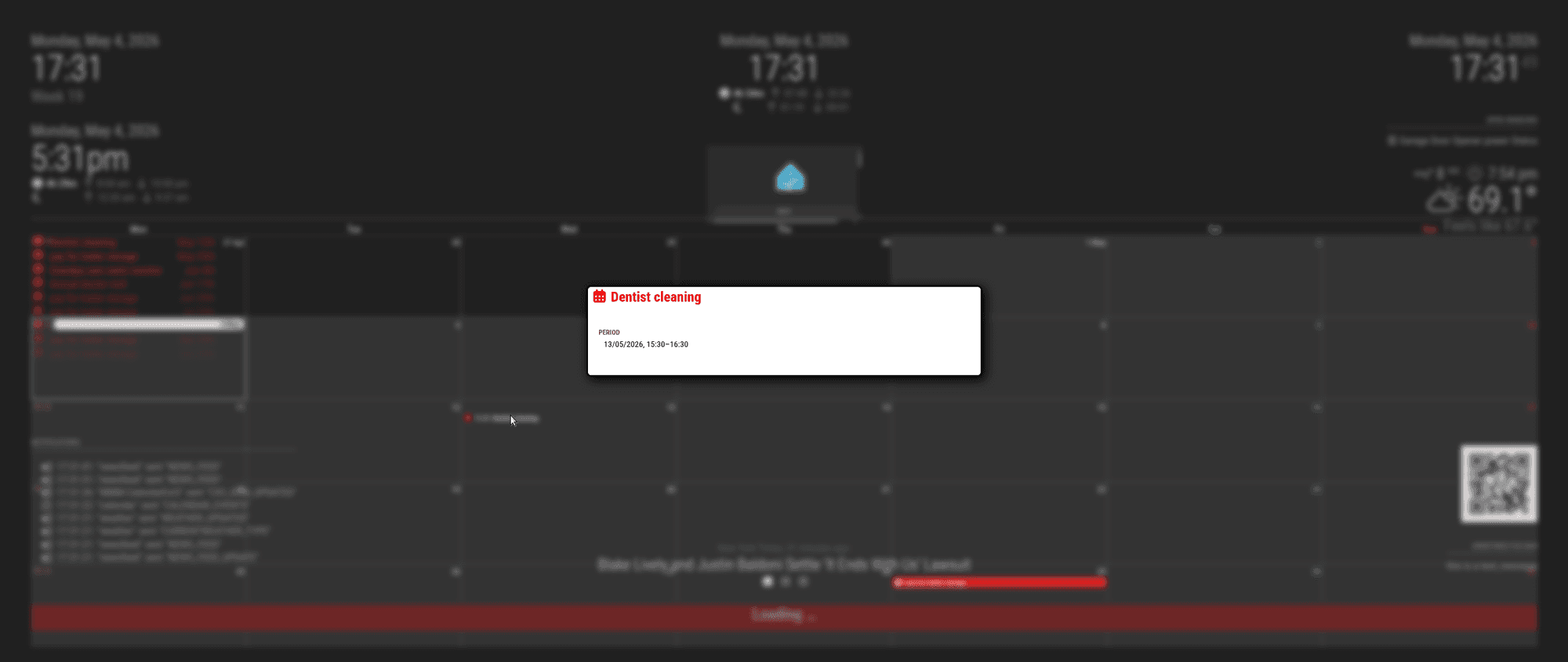

                  @sdetweil No change unfortunately. Both event streams load fine and with color, but the calendar still is displaying everything just white, except for one event that did come with color 10.png

                    @kkmirr04 just for testing, if you have a mouse on that system
                    Mouse over the event without color and click. This will show a new view of that event with the rest in blur behind,
                    Does the text appear in the proper color?
                    Escape key to exit that view

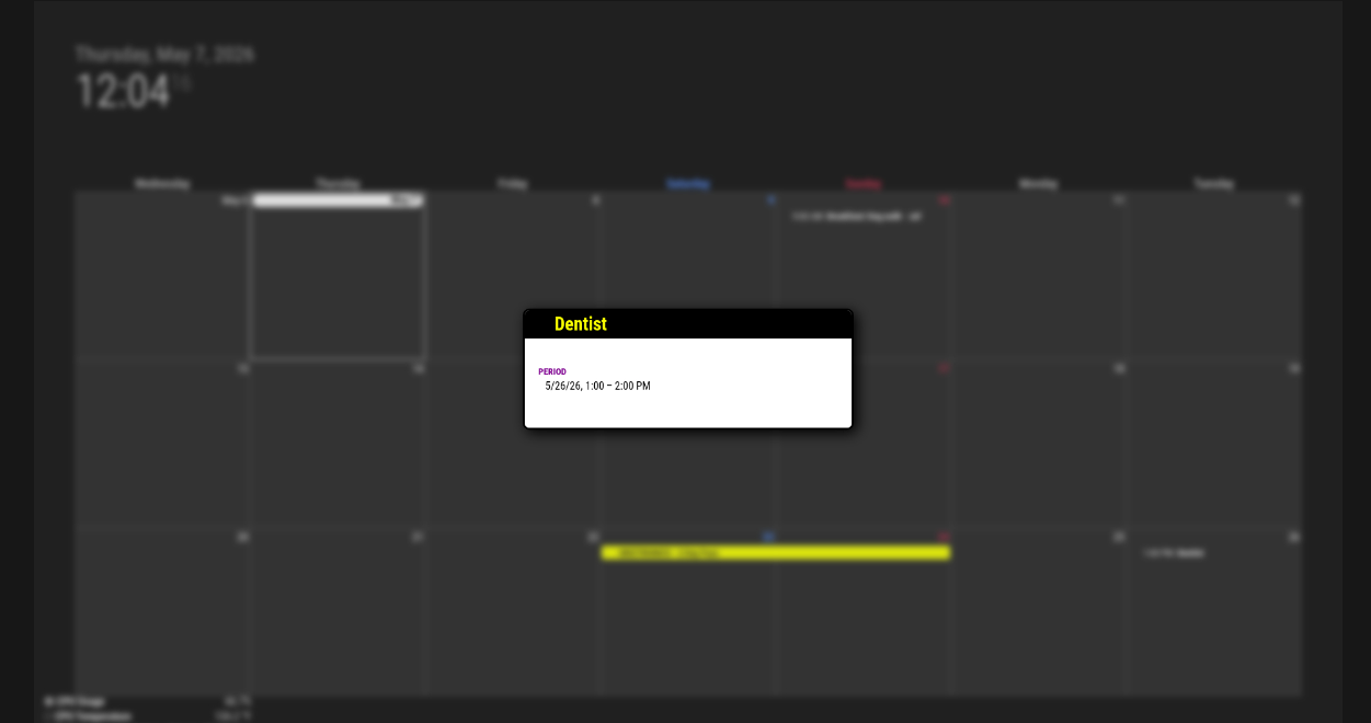

                      kkmirr04 @sdetweil
                      @sdetweil clicking on the event did bring the color in on that new view

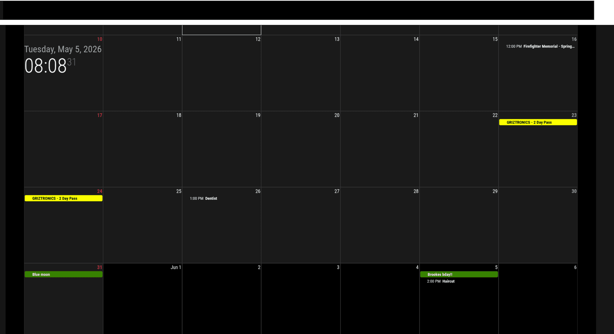

                              KristjanESPERANTO Module Developer @sdetweil
                              @kkmirr04 Does it work when you add this to your custom.css?
                              .CX3 .event.singleday .headline .title,
                              .CX3 .event.singleday .headline .time {
                                color: var(--calendarColor);
                              K S 3 Replies Last reply

                                    sdetweil @KristjanESPERANTO
                                    @KristjanESPERANTO that changed the results for me… now have color

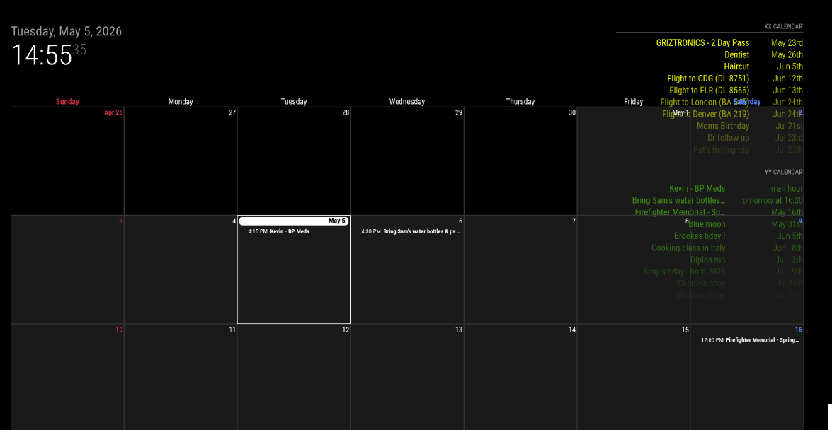

                                            kkmirr04 @sdetweil
                                            @sdetweil This fixed it for me, both calendar event streams are pulling in colors and even across all ‘modes’ of EXT3 now. (month, week, day) and its extending out to all events I can see on the calendar.
                                            Thank you both so much for all of the help on this, my two way glass just arrived so timing couldn’t be better!
