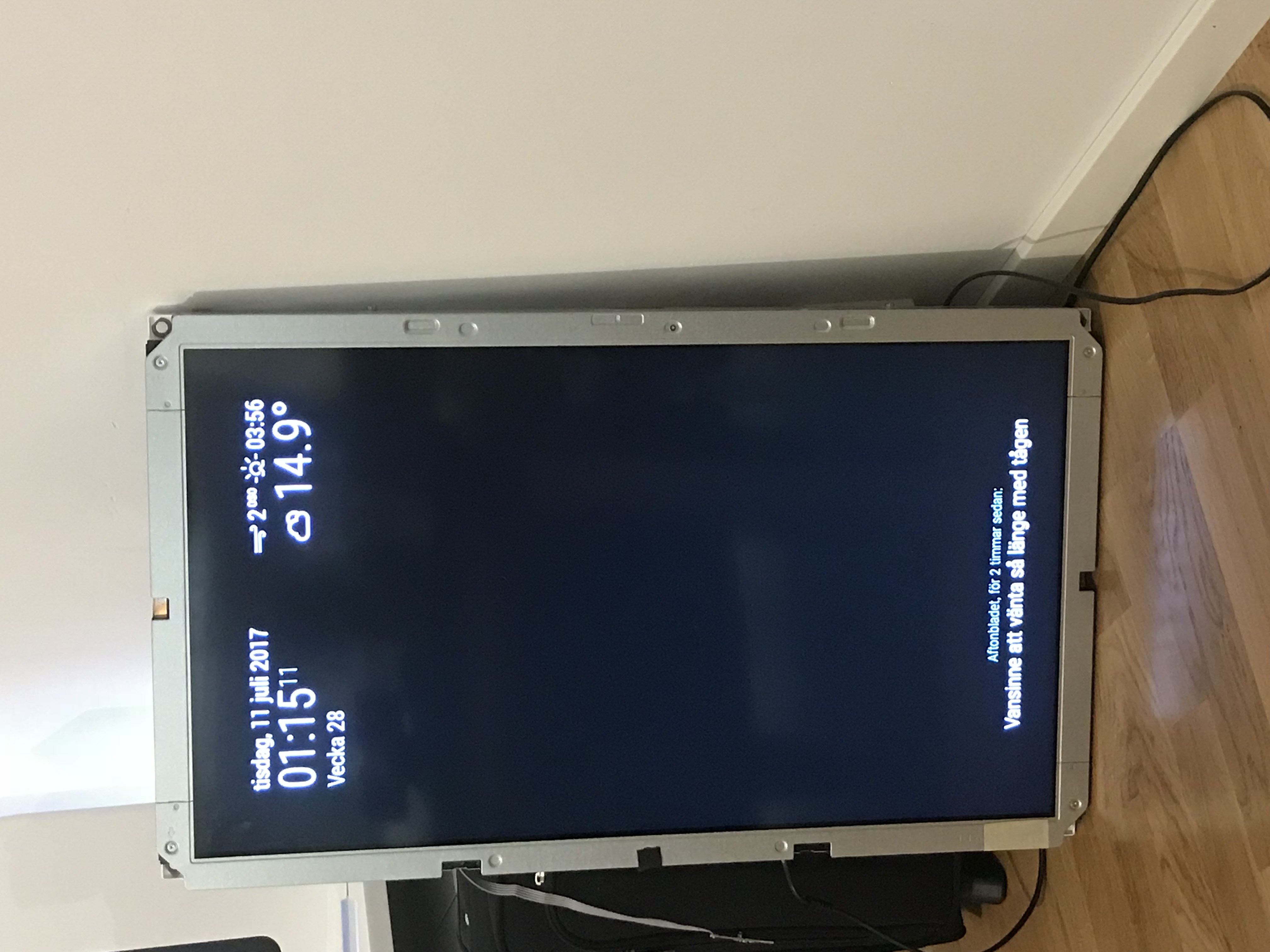

      Hi!
      I’m trying to add some more compliments to the compliments module. Everytime i add some new stuff my MM do not let any compliments show up.
      Any solution?

          Okay, first step: Let’s format your post correctly. Please follow the markdown conventions to help us read your config.js file. For example, please surround the contents of your config.js file with a separate line that contains three “back tick” characters. (`).
          I don’t think we need the contents of the compliment.js file, so you can just remove that.

            After formatting your post correctly you can see there is some mistake in your compliments in one of the first lines where the colour formatting suddenly breaks.
            • B Offline
              bhepler Module Developer
              You shouldn’t be modifying the compliments.js file. Any new compliments should be placed in the appropriate section of the config.js file. Or if you like, you can create a compliments.json file and load them. Check the module READ.ME file for exact syntax.
