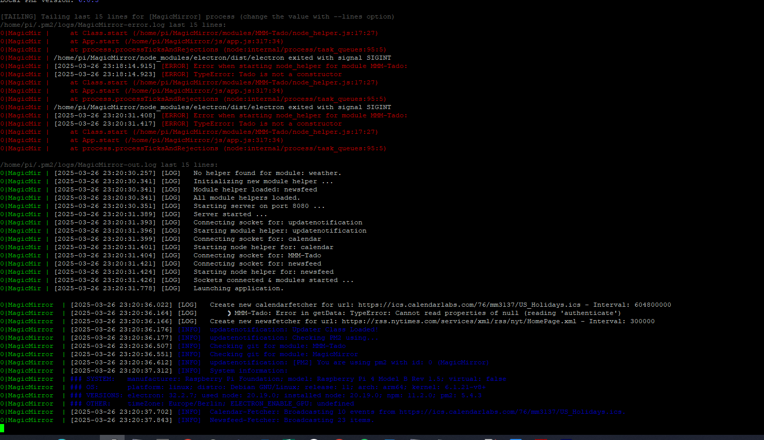

      i Spend now 4 Nights with Chatgpt without Outcome. Only the handle Version change the Bearer works great.

      @sdetweil Hi i reinstall the hole MM Software and use the daydy16 Tado Version but from the beginning with alle the config i became this error 8857d2f8-4886-4377-ba64-0f68710eaec6-image.png what i do wrong
