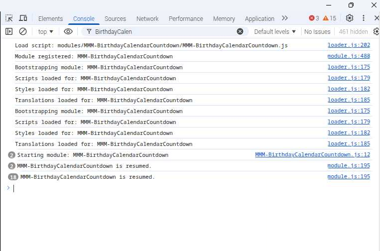

    • RE: Introducing MMM-BirthdayCalendarCountdown – Your MagicMirror Birthday Countdown Module!
      Thanks for the help - I have screenshoted the messages:
      Does this help ?
      posted in Utilities

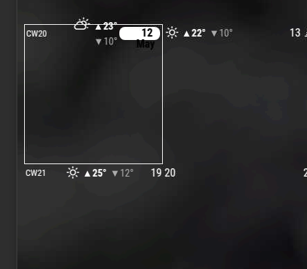

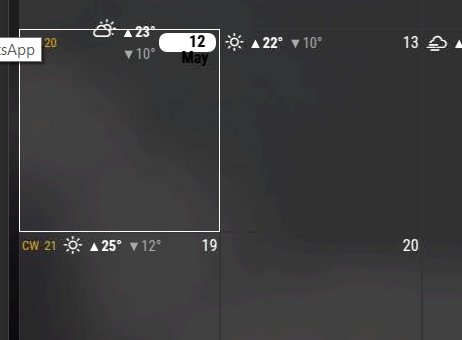

      p1lspeda
    • RE: MMM-CalendarExt3
      I managed to figure it out.
      Just had to play around with the font-size and now it’s as I like it,
      Thanks for your patience.
      posted in Utilities

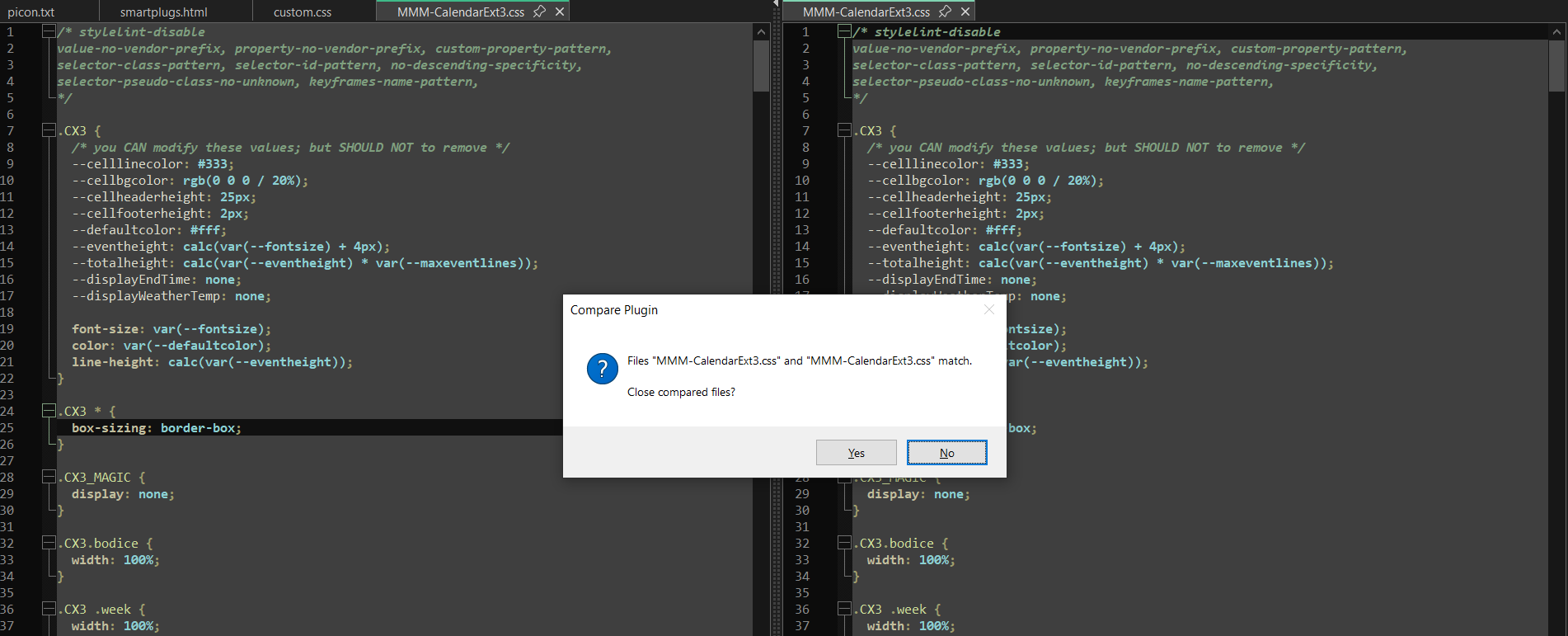

      p1lspeda
      I could narrow it down to cellWeather but I cannot find any css-styles in the module’s *.css :/
      This means I am lost as to where to start testing :(
      posted in Utilities
