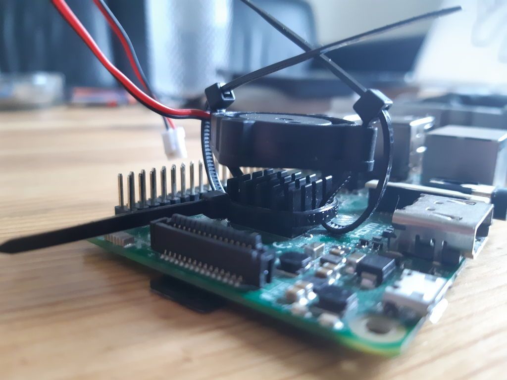

        But as you quoted that the pi is without a case you could use cable ties to attach it to your fan just like this guy did !

                    Try this if it helps to hold the fan !
                    Try this if it helps !

                            @requiemmg Actually there is a hack! You can increase the space between wall & frame by placing 4 no screws in the back side of frame that would give you some extra margin to place your fan on Rpi. You can also adjust the screw height accordingly! Hope it helps !
