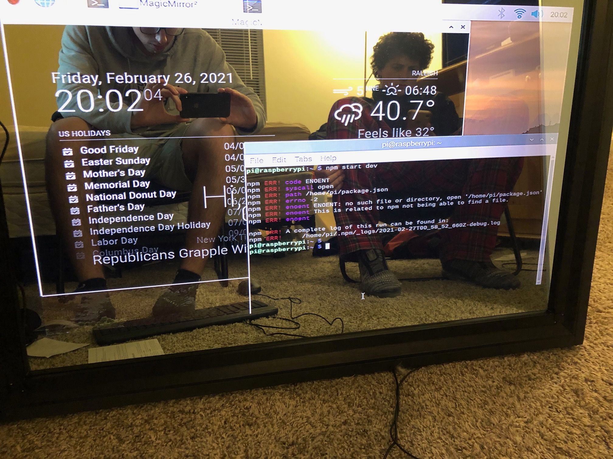

      You trying to run the mirror from the wrong folder. ENOENT error.
      Start the mirror from within the MagicMirror directory

        @mykle1 I am sorry Im a noob. How do I run the mirror from within the directory? cd MagicMirror?
        Mykle1M 1 Reply Last reply

          @brendan_c23 said in Problems With Weather:
          cd MagicMirror?
          yes sir

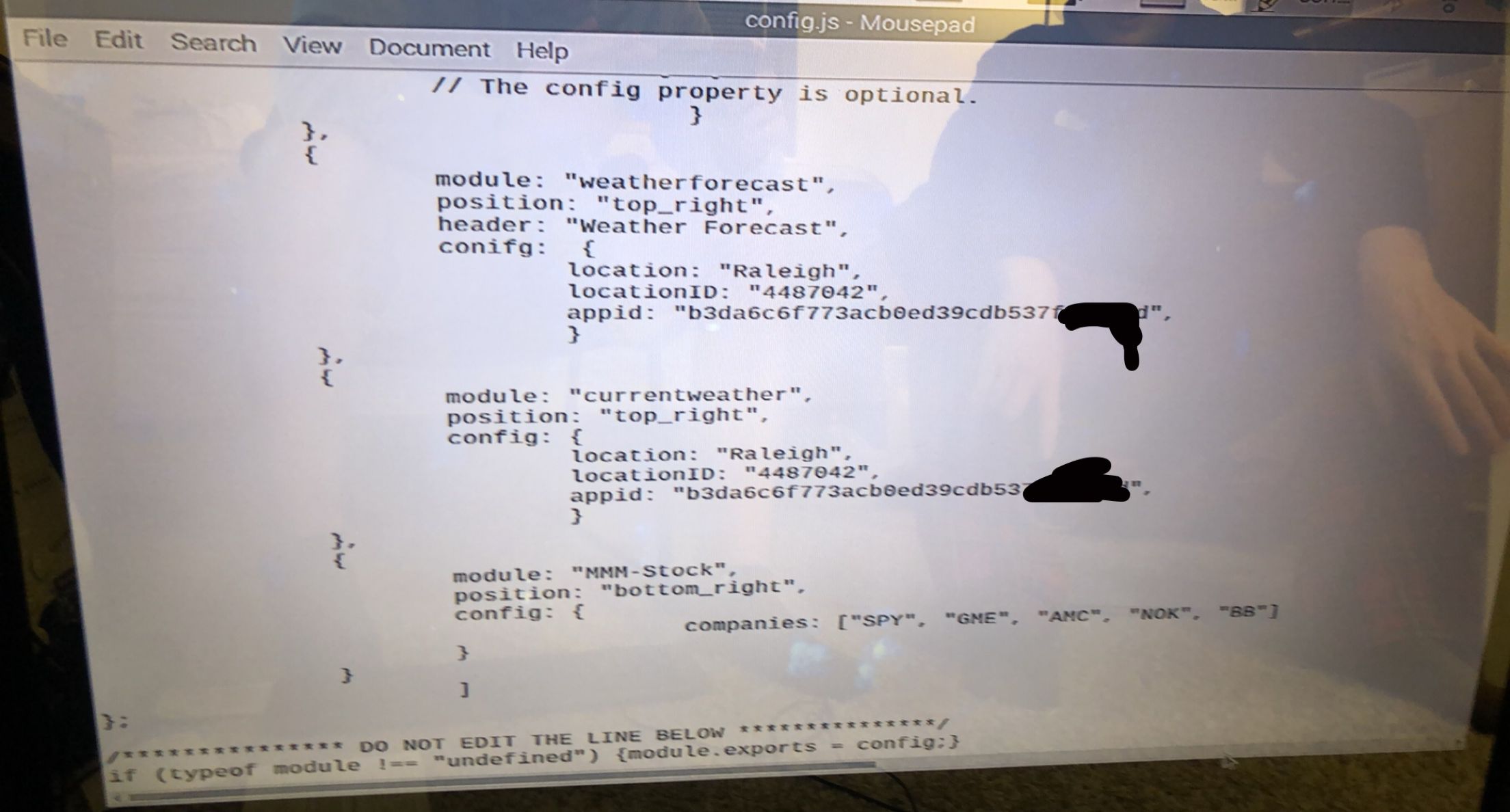

              @brendan_c23
              Well, it says right in the error message that your appid is not set. Hmmm

                brendan_c23 @Mykle1

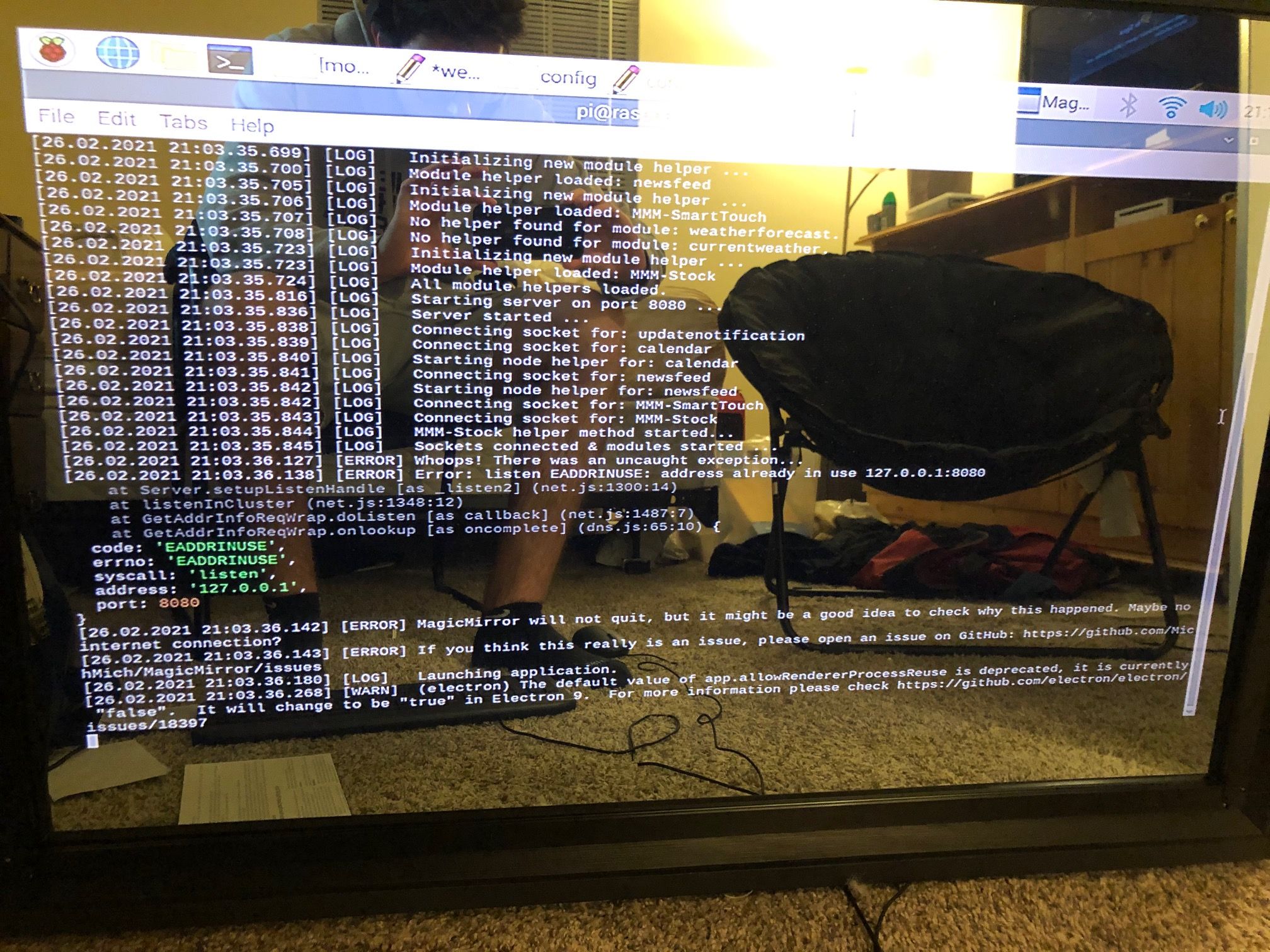

                  @brendan_c23
                  Something else is using port 8080. Most commonly it is because you have more than one instance of MM running at the same time. Or, there is another program on your pi using the same port.
                  Create a working config

                    brendan_c23 @Mykle1
                    @mykle1 Is it because I am using the same APPid for both weather modules? I have triple checked that I have the correct appid that was also working for the current weather. IMG_3983.JPG
                      No, you can use the appid twice. However, MM can not share port 8080
