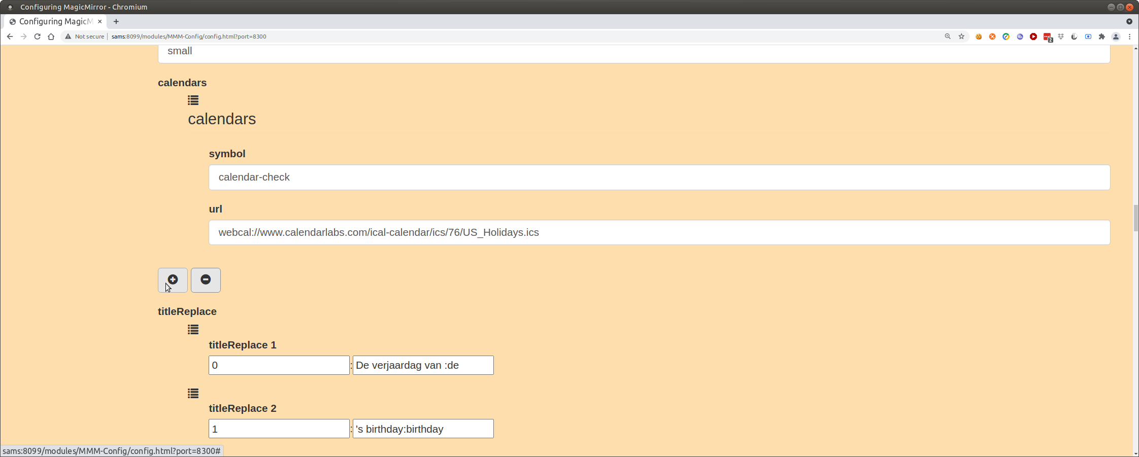

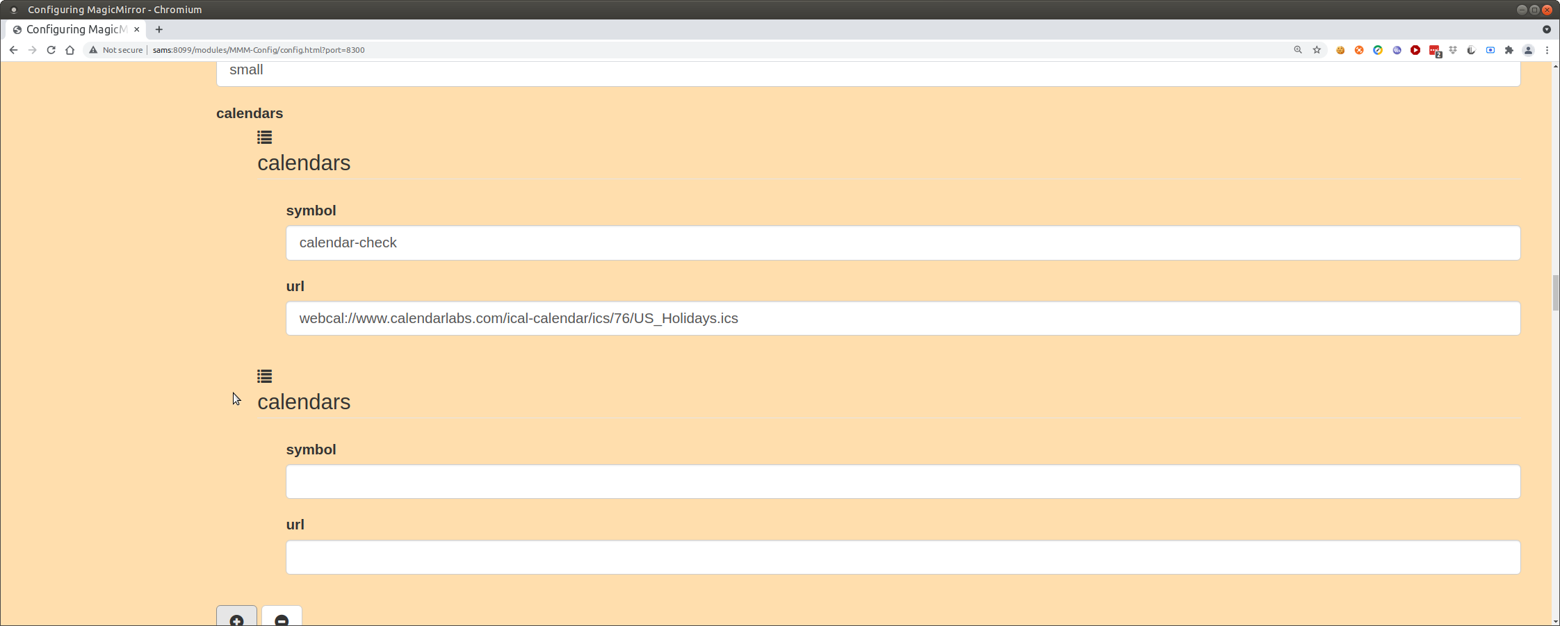

          in mmm-config, just hit the plus button under calendars
          the titlereplace is an entry editing tool.
          replace the string on the left w the string in the right in the event title

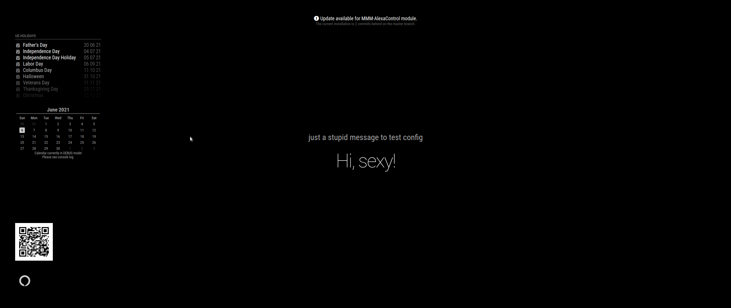

                            I installed and copy/pasted his sample, and got this
                            did u git clone in the right place?
