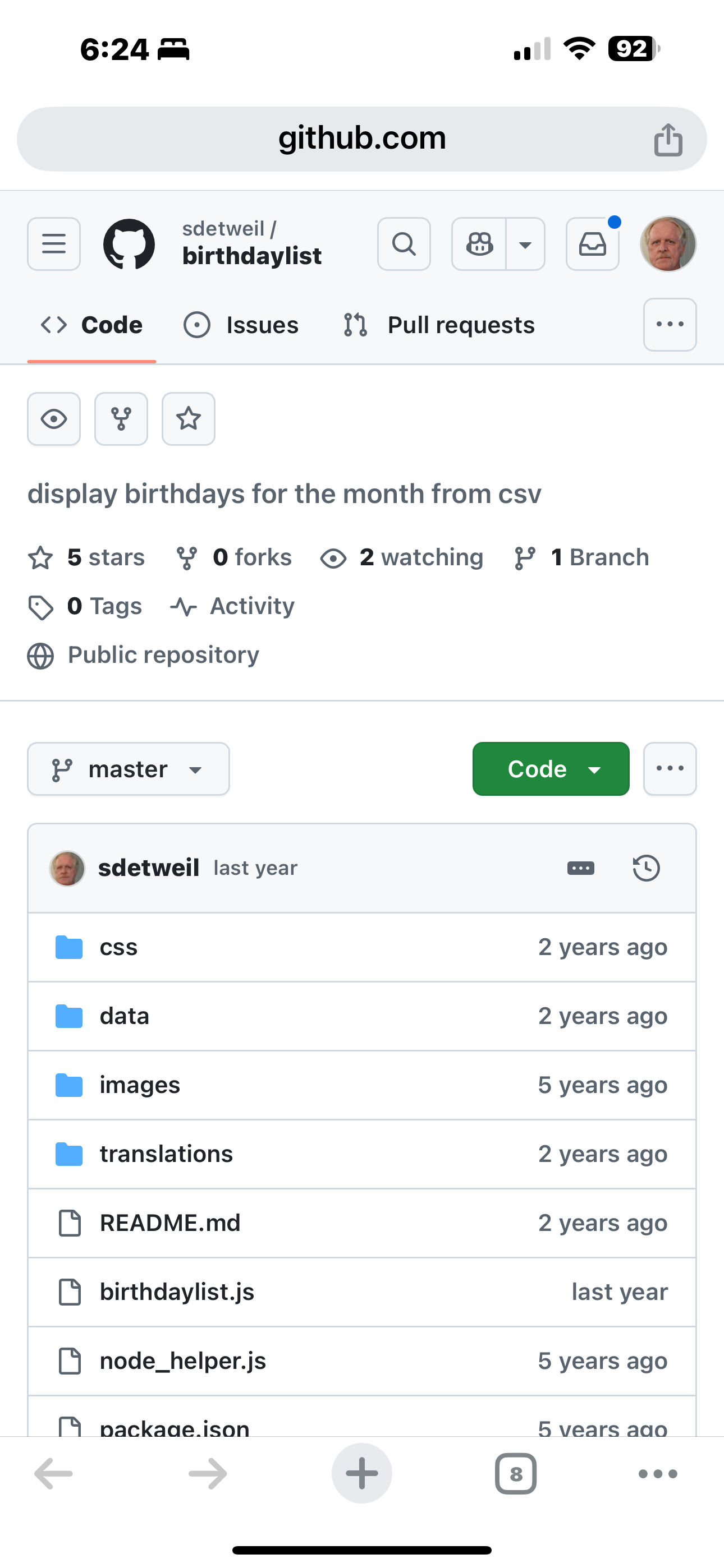

          sdetweil @rkorell
          @rkorell still present in same place
          https://github.com/sdetweil/birthdaylist
          i have not seen a report like this. will examine in the next couple days.

              sdetweil @rkorell
              @rkorell hm, its public and i copy/pasted the url
              i clicked the link i provided and got this

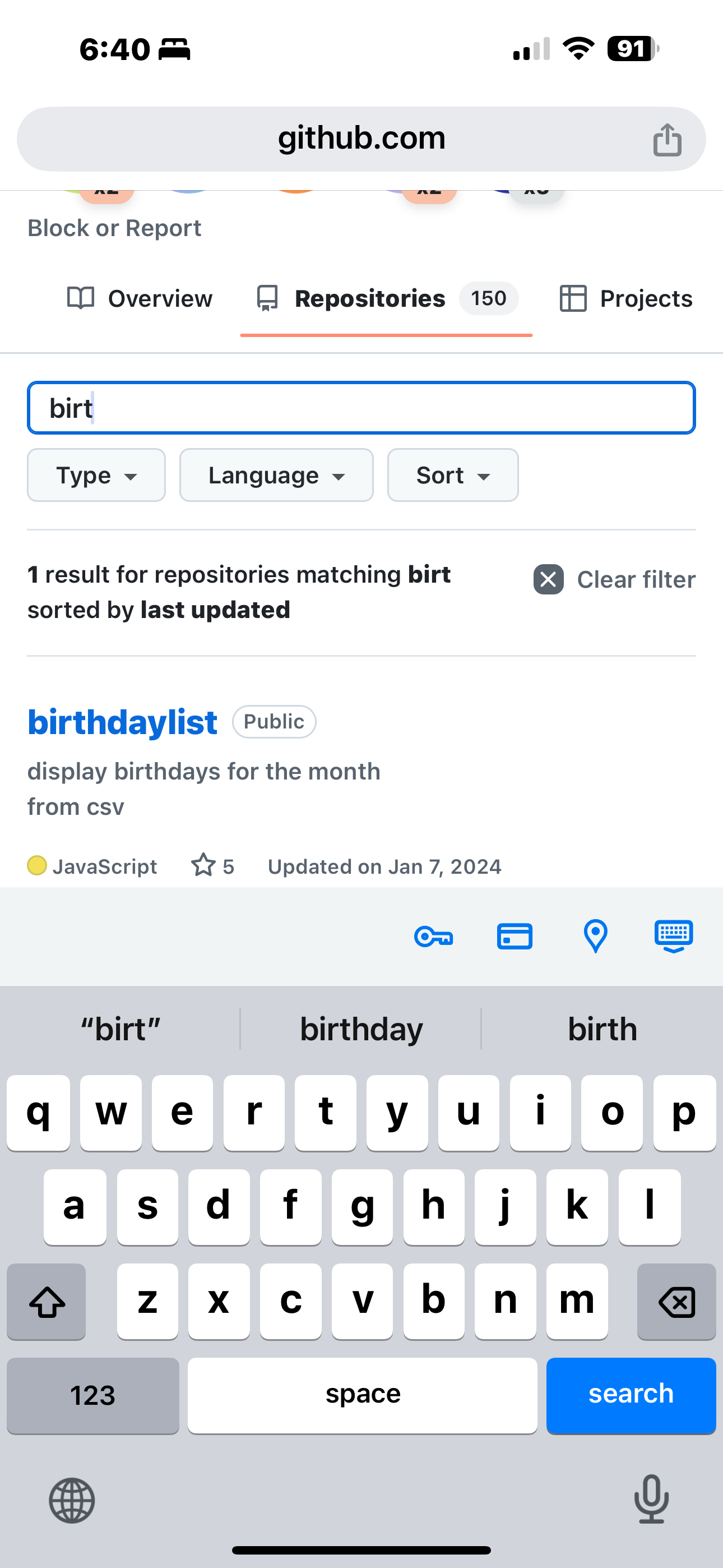

                        @rkorell i signed out of github and went back to
                        my home page, clicked repositories
                        put in part of the name

                            sdetweil @rkorell
                            @rkorell ok, just wanted to make sure nothing else was going on. github will only allow a user to pin 6 repos on their home page. i have at least 20 things i would pin
