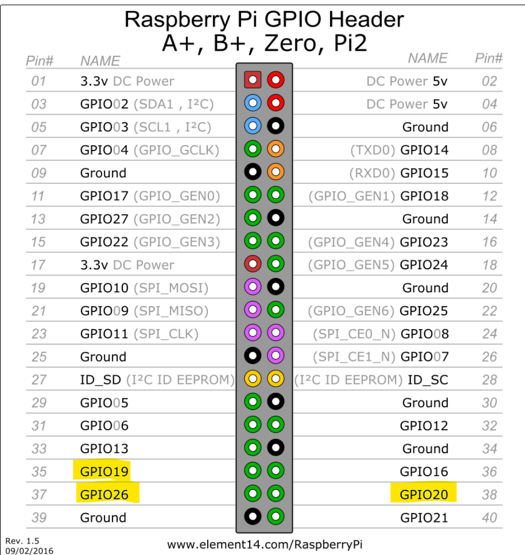

        @rkorell finally I got it solved :)
        The issue is really the GPIO numbering, I found this SO thread:
        https://stackoverflow.com/questions/78173749/use-raspberry-pi-4-gpio-with-node-js
        It is also valid for Pi3 and Pi2
        cat /sys/kernel/debug/gpio
        gpiochip0: GPIOs 512-565, parent: platform/3f200000.gpio, pinctrl-bcm2835:
         gpio-512 (ID_SDA              )
         gpio-513 (ID_SCL              )
         gpio-514 (GPIO2               )
         gpio-515 (GPIO3               )
         gpio-516 (GPIO4               )
         gpio-517 (GPIO5               )
         gpio-518 (GPIO6               )
         gpio-519 (GPIO7               |spi0 CS1            ) out hi ACTIVE LOW
         gpio-520 (GPIO8               |spi0 CS0            ) out hi ACTIVE LOW
         gpio-521 (GPIO9               )
         gpio-522 (GPIO10              )
         gpio-523 (GPIO11              )
         gpio-524 (GPIO12              )
         gpio-525 (GPIO13              )
         gpio-526 (GPIO14              )
         gpio-527 (GPIO15              )
         gpio-528 (GPIO16              )
         gpio-529 (GPIO17              |sysfs               ) in  hi IRQ
         gpio-530 (GPIO18              )
         gpio-531 (GPIO19              )
         gpio-532 (GPIO20              )
         gpio-533 (GPIO21              )
         gpio-534 (GPIO22              |sysfs               ) in  hi IRQ
         gpio-535 (GPIO23              )
         gpio-536 (GPIO24              )
         gpio-537 (GPIO25              )
         gpio-538 (GPIO26              )
         gpio-539 (GPIO27              |sysfs               ) in  hi IRQ
        I needed to set up the numbers according to the output
        e.g. Pin27 is 539 in the MMM-Navigate config.
        Now everything works so far as expected, thank you all for your help!

                I‘m not using this module and I do not know which of GPIO‘s you are using for your rotary encoder -
                In the module‘s description the author mentioned an eventually necessary modification for some of the PI‘s:
                On some Raspberry Pis it is neccesary to put the following line to /boot/config.txt for the GPIO where "rotary press (SW)" is connected:
                gpio=19=ip,pu
                Background: Sets your GPIO 19 as input (ip) and pull up (pu) Change the entry according to the GPIO pin you use.
                Have you double checked this?
                Your error-listing shows „invalid argument , write“ in some context to GPIO…
                May there is a topic for further investigation….

                        @crowimu
                        Only thing that comes in my mind that you have either put cable on wrong GPIO or cable is broken.
                        As per default you have either to use GPIOPins: [26,20,19]//rotary cw, rotary ccw, rotary press (BCM Numbering - marked yellow in the above picture) or (if occupied) enter the correct BCM (!) numbers in config of module.
                        If this is all correct, module should work.
                                       gpio-512 (ID_SDA              )
                                       gpio-513 (ID_SCL              )
                                       gpio-514 (GPIO2               )
                                       gpio-515 (GPIO3               )
                                       gpio-516 (GPIO4               )
                                       gpio-517 (GPIO5               )
                                       gpio-518 (GPIO6               )
                                       gpio-521 (GPIO9               )
                                       gpio-522 (GPIO10              )
                                       gpio-523 (GPIO11              )
                                       gpio-524 (GPIO12              )
                                       gpio-525 (GPIO13              )
                                       gpio-526 (GPIO14              )
                                       gpio-527 (GPIO15              )
                                       gpio-528 (GPIO16              )
                                       gpio-530 (GPIO18              )
                                       gpio-531 (GPIO19              )
                                       gpio-532 (GPIO20              )
                                       gpio-533 (GPIO21              )
                                       gpio-535 (GPIO23              )
                                       gpio-536 (GPIO24              )
                                       gpio-537 (GPIO25              )
                                       gpio-538 (GPIO26              )
