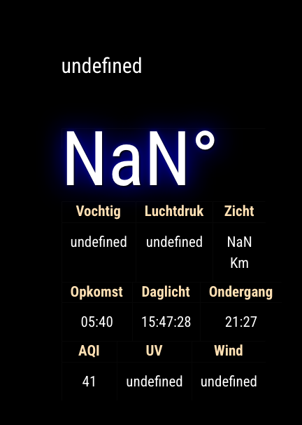

                    After updating and reload, I. got Undefined / NaN
                    What can this be?

                      Uncaught (in promise) TypeError: Cannot read properties of undefined (reading ‘icon’)
                      at Class.processWeather (MMM-NOAA3.js:210:20)
                      at Class.socketNotificationReceived (MMM-NOAA3.js:173:18)
                      at module.js:240:9
                      at Socket. (socketclient.js:32:4)
                      at Emitter.emit (index.js:136:20)
                      at Socket.emitEvent (socket.js:553:20)
                      at Socket.onevent (socket.js:540:18)
                      at MMSocket.socket.onevent (socketclient.js:26:11)
                      at Socket.onpacket (socket.js:508:22)
                      (still trying to learn JS, but not afraid to ask and AI is my best friend) ☺
                      htilburgsH 1 Reply Last reply Reply Quote 0
                      • htilburgsH Offline
                        htilburgs @htilburgs
                        The problem is with Weatherbit.
                        When I try Piratesky, everythings works fine…

                          @htilburgs I will have a look at weatherbit. They may have changed icons.
                          Just a little busy today but when I get a moment I will definitely have a look.
                          I also require your lat and lon so I can get the data/icons for your region/area

                            userlat: “51.479256”,
                            userlon: “5.657010”,

                              @htilburgs Good morning. I have just tested weatherbit using you lat and lon and not seeing any errors.

                                I see It.
                                I don’t what was wrong, you sas the messages for MM in console. Thanks for looking into It, maybe It was a one the thing.

                                  @htilburgs Thanks for confirming. I double checked the icons available from weatherbit and compared to the list and they are all covered. Hopefully it was just a once off thing. 🙏
