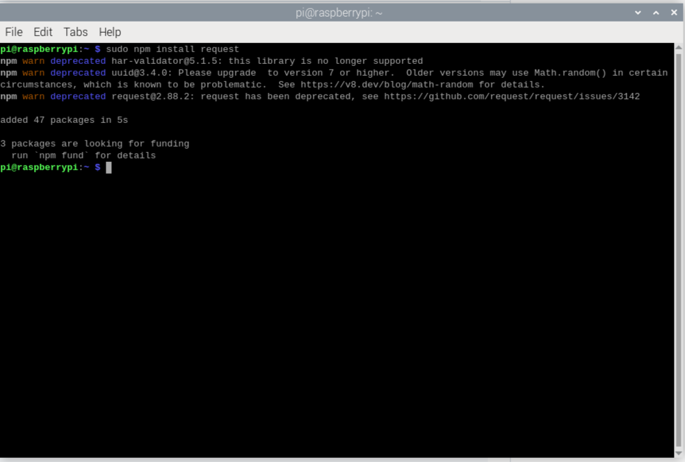

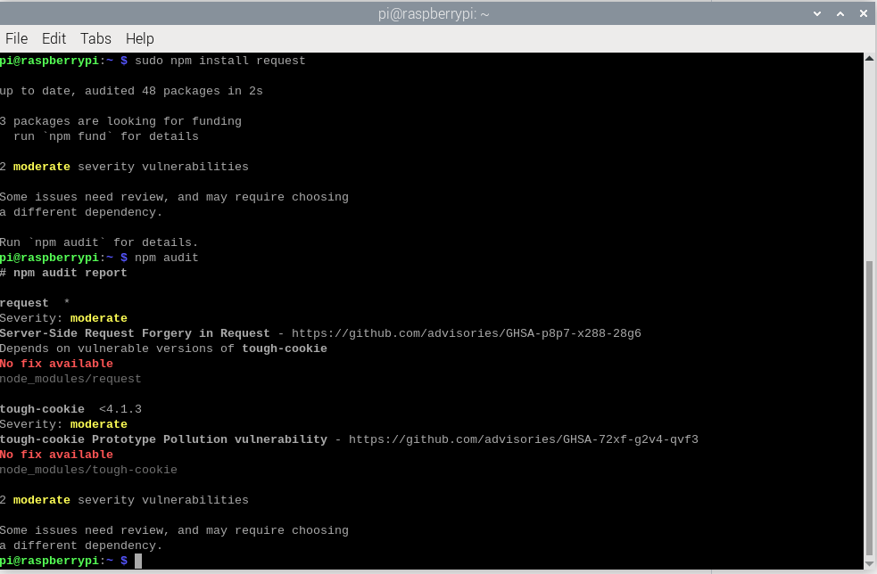

      Ok I’ve tried a couple installs starting completely over from scratch with fresh versions of Raspberry Pi OS, MagicMirror, Request, and MMM-PetFinder from PhantomOffKanagawa and I am still unable to get the module to work.
      I am using a new Pi 5 and am installing MagicMirror using sdetweil’s script.
      The only issues I see are related to Request. When I install it I get these issues below. But when searching on them I couldn’t find any solutions. Are these issues normal? Or is there anything else I’m missing?

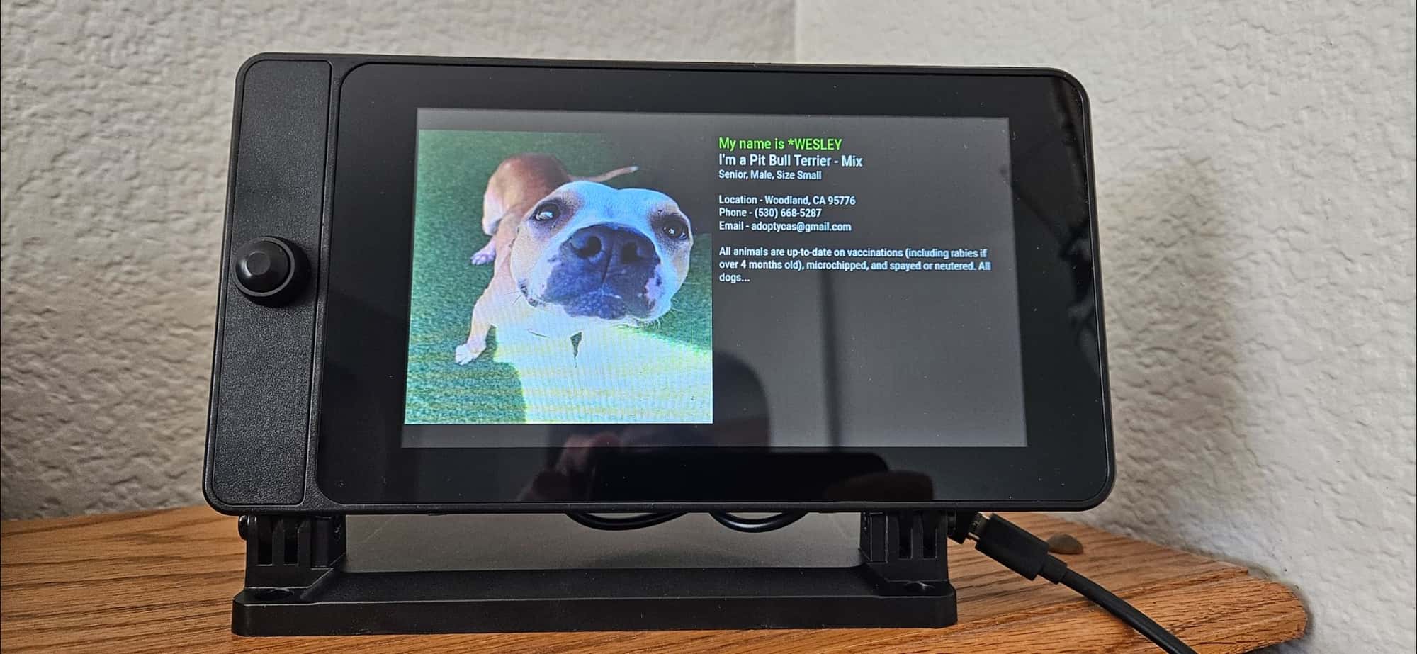

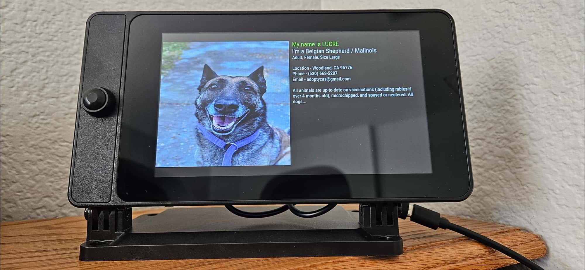

    • Has anyone been able to get MMM-PetFinder to work?
      Has anyone been able to get MMM-PetFinder to work recently? I’m working on a gift for someone but it looks like the PetFinder API has changed since the last module update. Going through the documentation and I can’t get past the Token Request part. Has anyone else had any luck with this?
