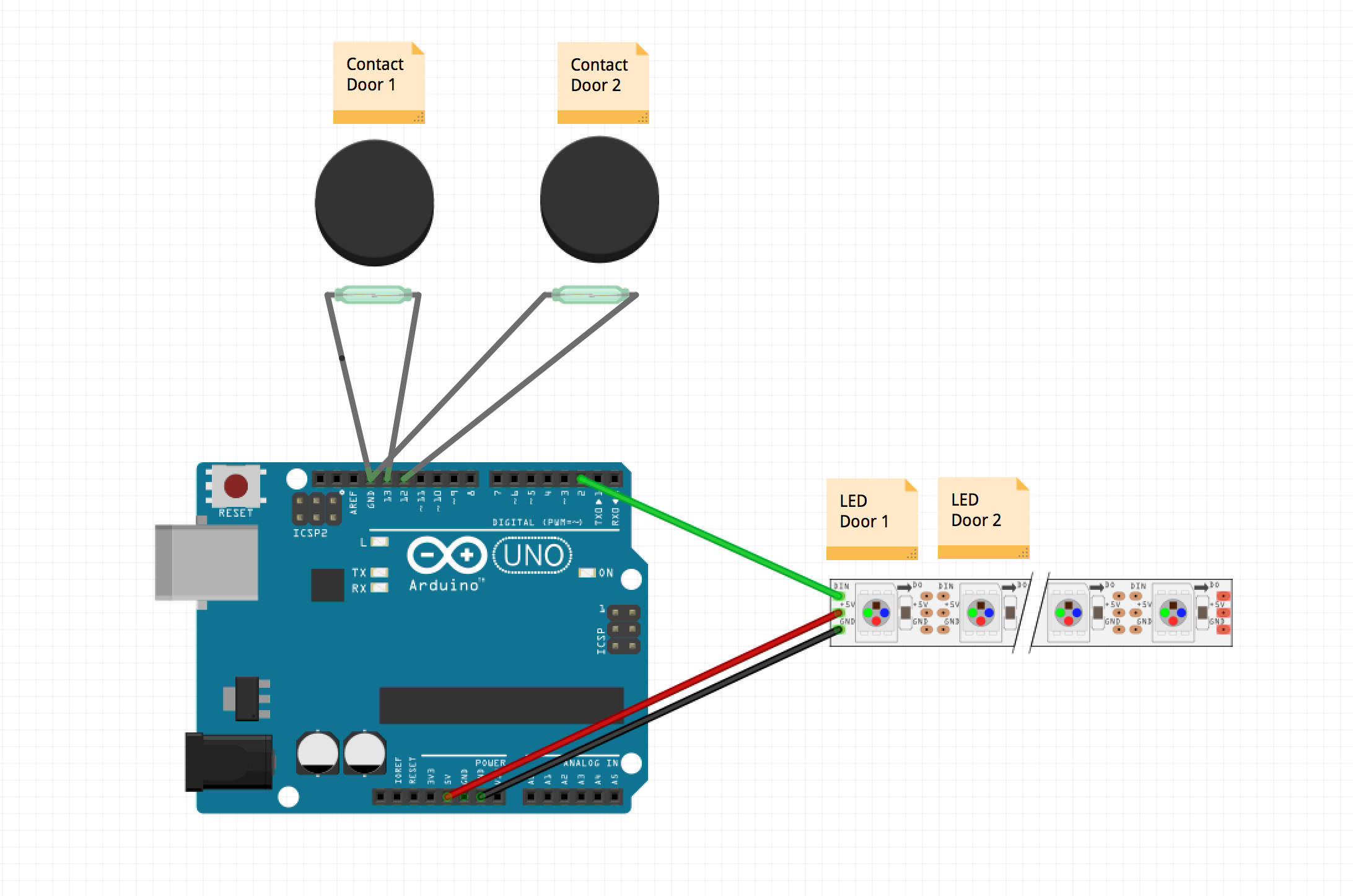

                      Hello.
                      Here is my current “installation”.
                      alt text
                      My 2 door sensors send 1 or 0 if there is contact.
                      Depending on the result, LEDs 1 and 2 light up red or green.
                      What I would like is to replace the leds with a logo on the mirror.
                      (I have a door on the street side and a door on the garden side which explains the logos)
                      Here is the code of my Arduino project.
