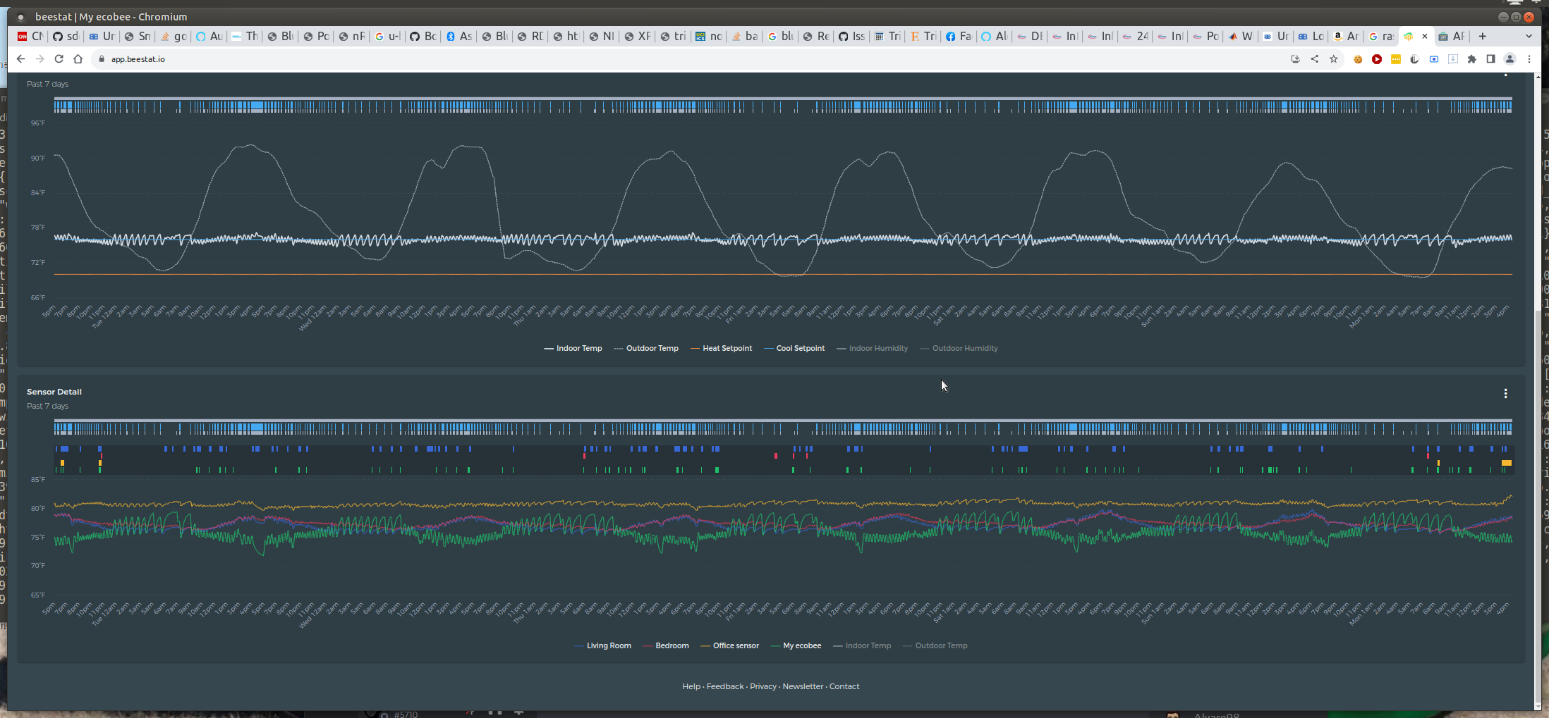

                      sdetweil @JohnGalt
                      @JohnGalt I have not integrated my ecobee to my MagicMirror
                      but it looks like there is an API
                      https://www.notion.so/API-Documentation-e4a7746e6a3f45dbb58ea6b45b8f9744
                      and one can get charts now
                      https://beestat.io/
                      I believe the section at sensor details shows the ‘occupancy’ … this is like a week of detail from my house.
                      in the live version there is floating info as the cursor passes over data
