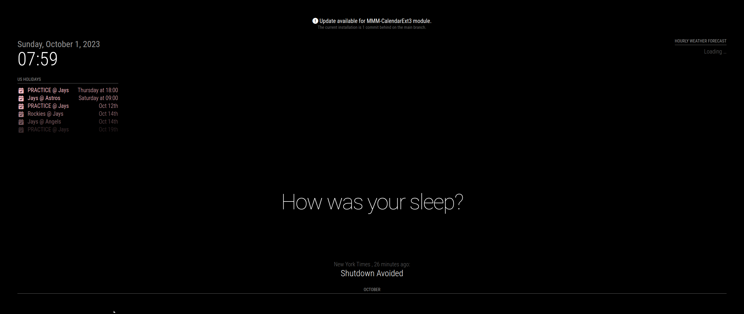

                this works for me
                                        module: "clock",
                                        config:{
                                                displaySeconds:false,
                  Manino @sdetweil
                  @sdetweil Intresting, no need for trailing comma when it was only
                  module; "clock",
                  position: "top_left"
                  It did work with a trailing comma after position line, thanks!
