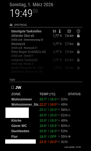

            Tado on the left side:
            Tado on the right side:

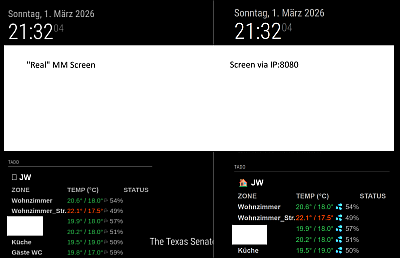

                  Crazy …
                  See this:Tado8a.png
                  Left on the real MM: no pictures
                  Right over IP:8080: all needed images

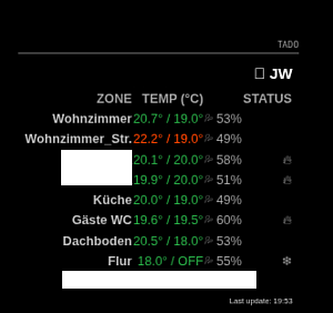

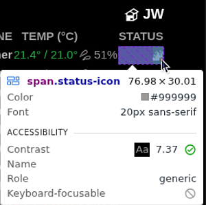

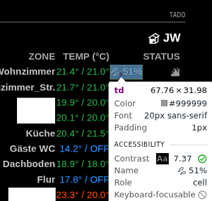

                      fonts-Symbola installed and rebootet:
                      And some inspections:
