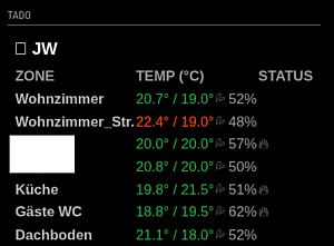

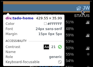

      fonts-Symbola installed and rebootet:
      And some inspections:

        I didn’t have any colors either.
        Then I installed the “Noto Color Emoji” font.
        After that, I added the following to custom.css:
        /* Do NOT use Symbola */
        .MMM-MyTado {
        font-family: “Noto Color Emoji”, sans-serif !important;
        Now the colors are there :-)

          Yes !! - This “Noto Color Emoji” font works!
          Now i’ve colors and pictures.
          The steps:
          sudo apt update
          sudo apt install fonts-noto-color-emoji
          fc-cache -fv
          • change font in css
            and reboot your mirror
          Thanks for your help and one more time: Thanks for the module

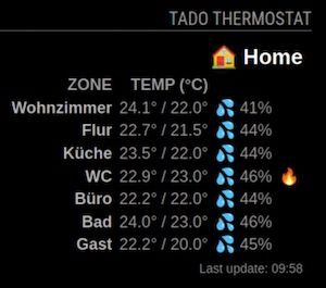

              I’ve made the view a bit more compact. The word “Status” was stretching everything too much. Now I only see the status icon. Looks better, I think… :-)
              /* Nur die STATUS-Überschrift ausblenden */
              .MMM-MyTado th:last-child {
              display: none !important;
              htilburgsH 2 Replies Last reply

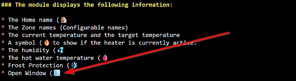

                  I also saw this in the README (OpenWindow):
                  I often see this message in my app, but how can I activate it here too?
                  J 1 Reply Last reply

                    Perhaps this is due to the time period of updating the data. Unfortunately, the values are only updated every 30 minutes. If the window is opened and closed again during this period, then of course it will not be displayed. Just a guess…😉
                    htilburgsH 1 Reply Last reply
                    • htilburgsH
                      htilburgs @JoeFranz
                      @JoeFranz @mymirror
                      That is correct. Due to the limit of 100 polls a day (thanks to Tado), you will probably not see this often.
                      When you have the “contract” with Tado, you can put the polling lower (mine is at 300000 / 5 min, still trying how far I can go) and I have seen it once, when I let my door open for a few minutes).

                        I see what you did, but there are more ways to do this:
                        showColumnHeaders: false
                        Then no headers are shown and you have a compact view
                        or you leave the statusColumnName: "" (empty) so no name is shown.
                        With the CSS change, it becomes definitive, and that is not what should happen.

                              The humidity is already shown -> The humidity (💦)
                              The open window is already shown -> Open Window (🪟)
                              It will be shown in the status column when it appears in that zone.
                              (still trying to learn JS, but not afraid to ask and AI is my best friend) ☺
