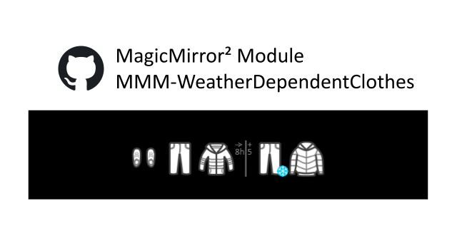

      A short look on this module before going out for work (and maby later for a drink) to check if you are properly dressed for the weather next 8+ hours.
      What do you think about it? I am happy to read your thoughts.
      [card:fruestueck/MMM-WeatherDependentClothes]
