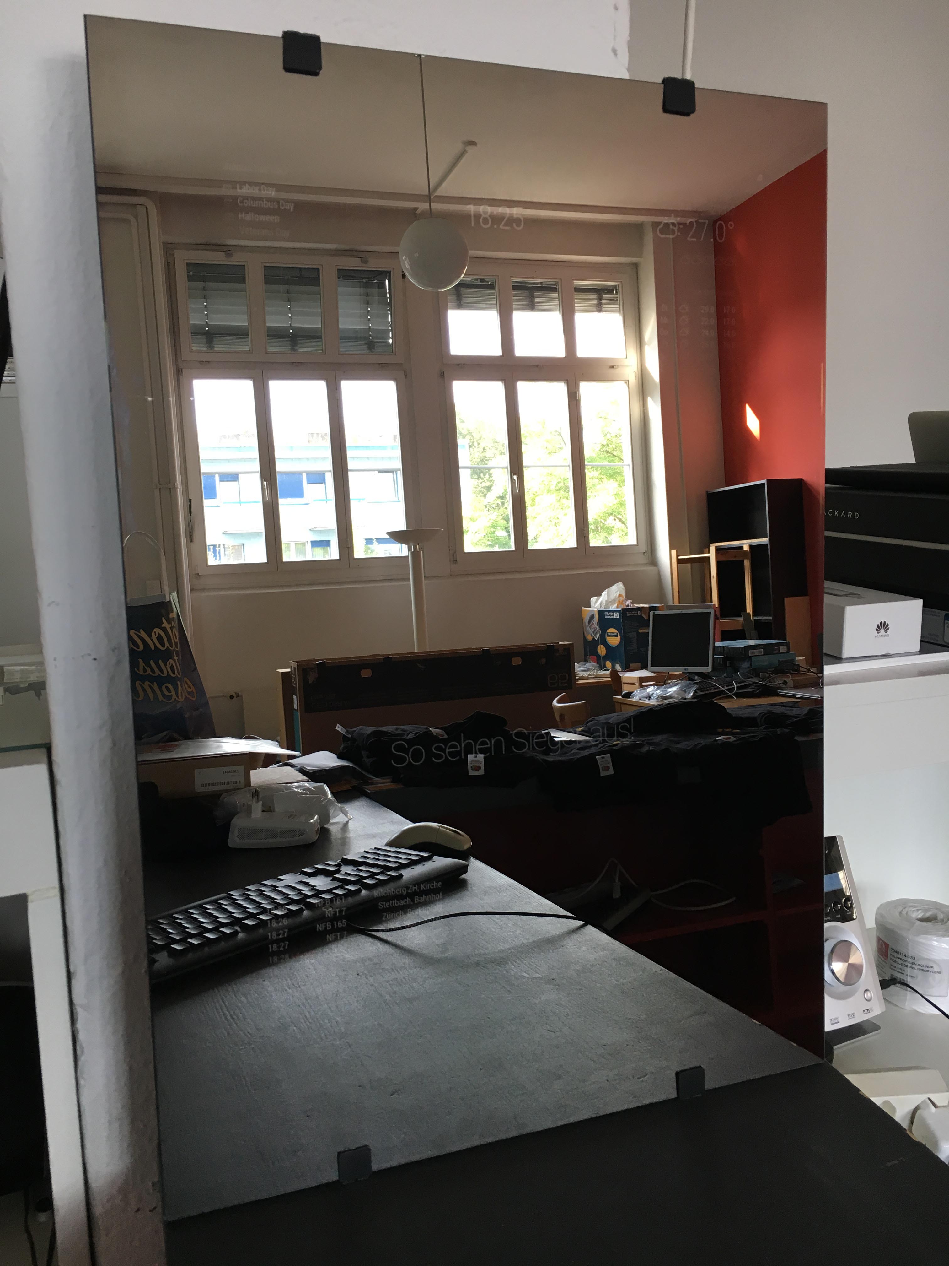

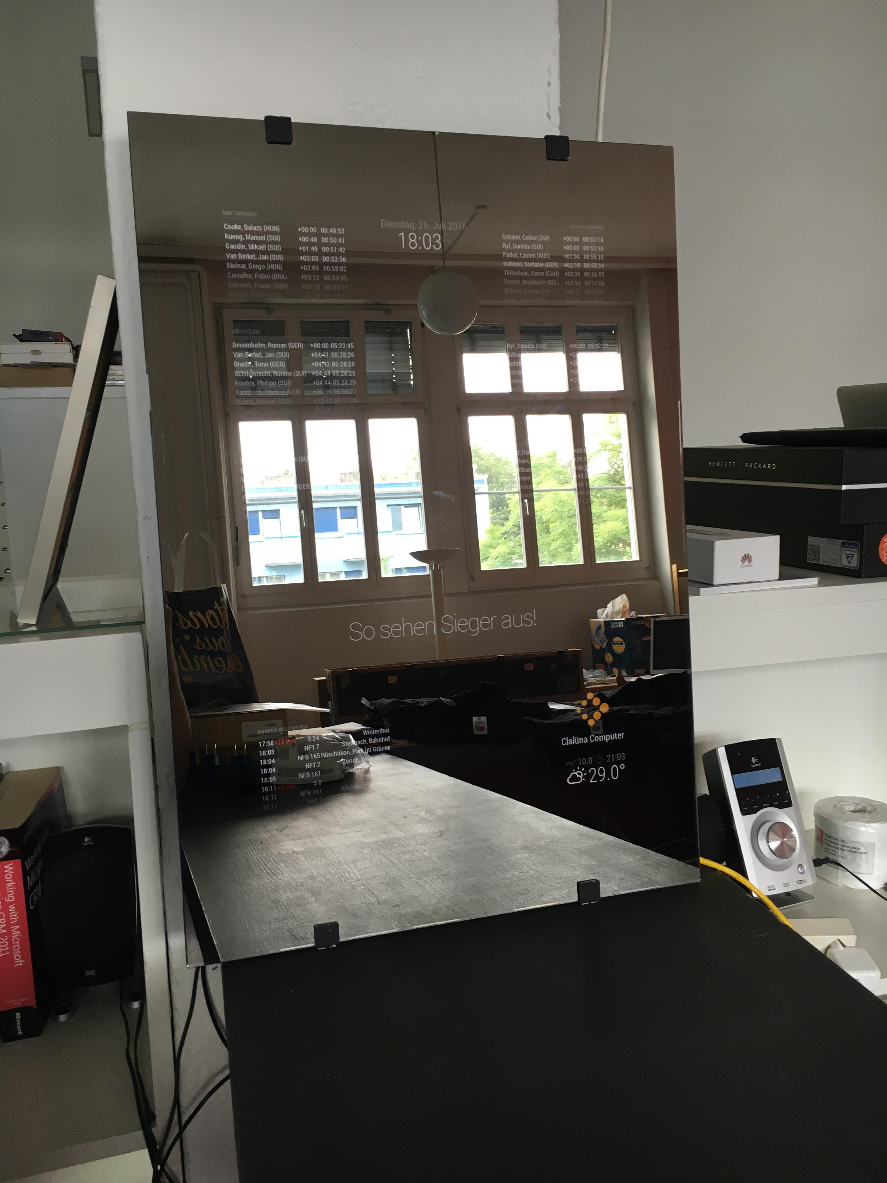

      Here is my frameless mirror project. I like this style a lot.
      Here you can see the difference between the 12 % and 20 % mirror.
      The room has big windows.
      12%:
      20%
      frame:

        interesting. Thanks for showing the difference between 12% and 20% so clearly.
        Is the 12% better readable if you use the shutter to darken the room?
        • B
          Bangee Module Developer
          my first mirror was built with a 12 % in a “darker” room.
          There is no big window on the other side of the room:
          https://forum.magicmirror.builders/topic/117/bangee-s-mirror/16
          I’ll post another project with a 12 % mirror.
          the reflection of the 12% is golden. the 20% has a natural reflection.
          I’ts hard to decide ;-)
