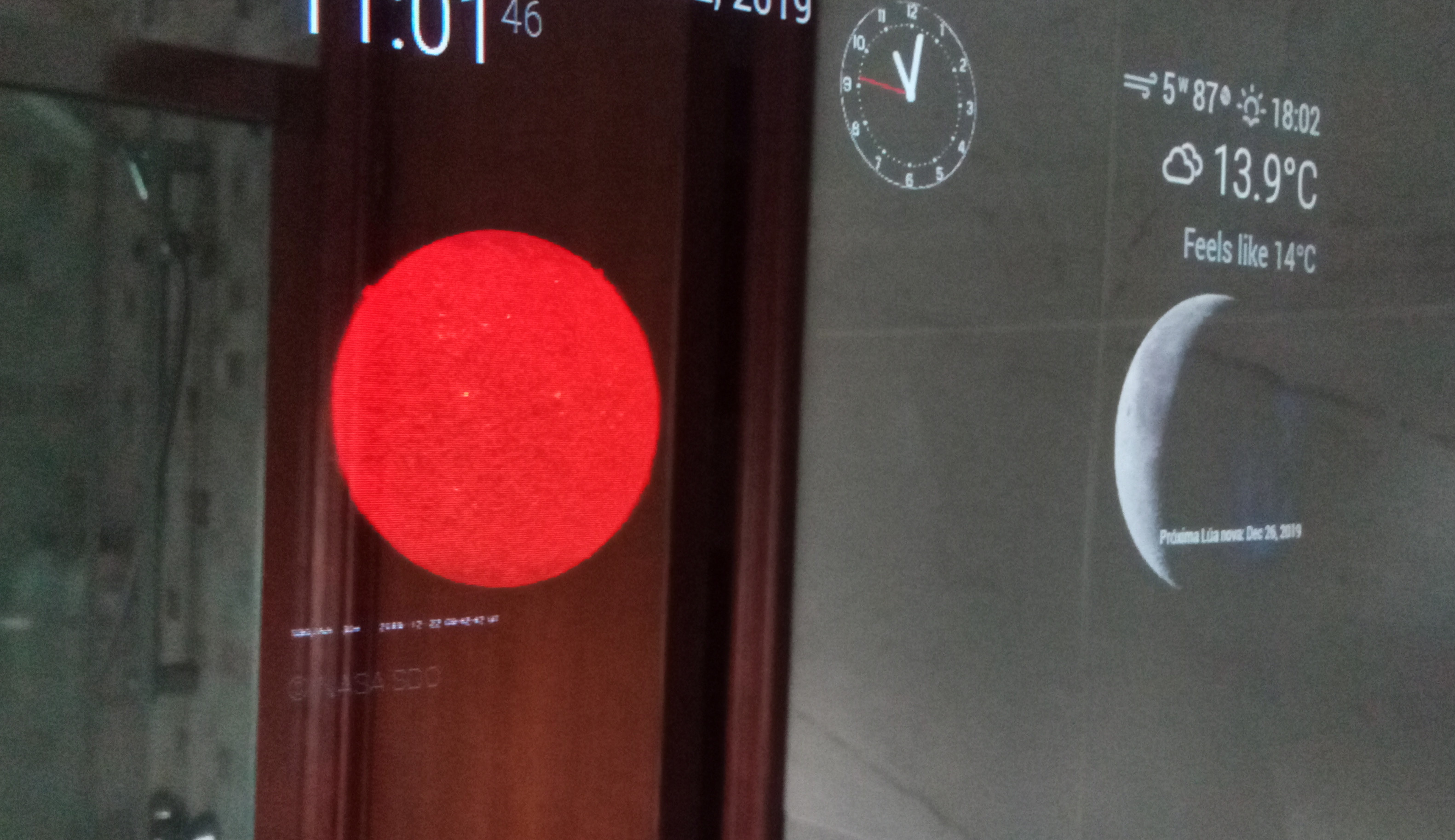

      To complete my first Magic Mirror Module, MMM-APOD, I created another Module, MMM-SolarPicture, it displays the last Solar Dynamics Observatory (SDO) picture :
      MMM-SolarPicture ScreenShots
      I hope you like the module.
      Please inform me of any problems.
      Grena

        Very nice module!! I just tested it and it looks great next to the MMM-Lunartic module.
        I wonder if it will be possible to show all the images from the SDO website one after the other, setting the time between one and another, so you can see them all consecutively.
        Great work. Thanks for sharing!

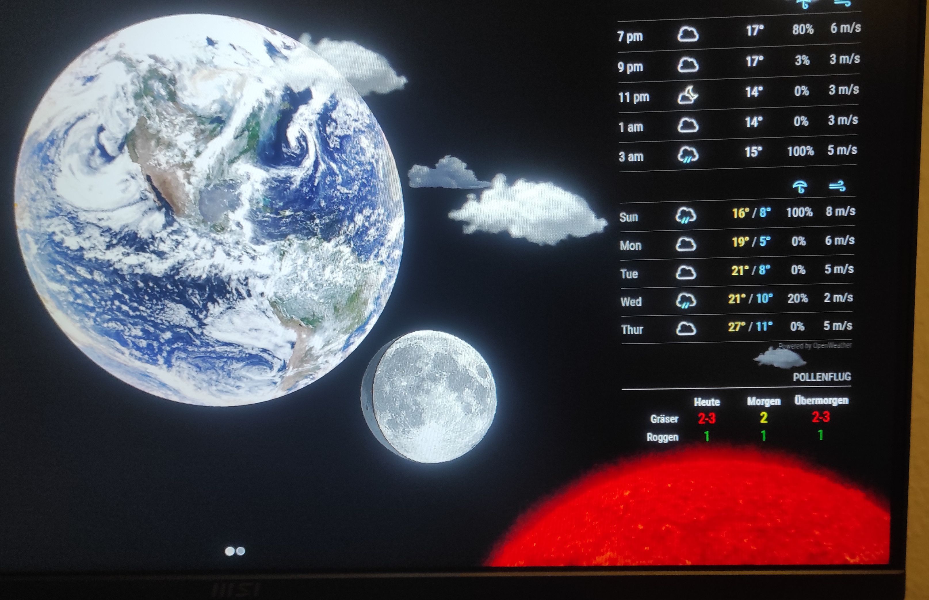

                  Hello everyone!
                  First of all: Thanks for the module! I like it a lot.
                  I tried to move the picture around by adding a new position in my custom.css but it is not moving at all. The MMM.MoonPhase module moves without a problem, but these paramaters don´t work for the sun (because of the missing *.css file, I guess). I´m no expert at all, therefore a little help would be highly appreciated!
                  My goal is to push the sun “outside” the screen so that only the upper left corner of the sun is on the bottom right side of the screen.
                  Thanks in advance and kind regards,
                  Marco

                    sdetweil @bugphunk
                    @bugphunk i do not know, but use the developer window elements tab to discover and set css styles to determine what needs to go in custom.css
                    see the second link in my signature below

                      Hello @bugphunk,
                      I’m not sure I fully understand what you want to do… But to move a module, use the position option. An illustration of the different zones is available here
                      If you do not get the desired result, you must look for the custom CSS code!
                      The module displays a simple img in a div… The absence of a CSS file in MMM-SolarPicture should simplify things because everything is managed by MM!

                        Thanks for your support. The developer window elements tab might do the trick.
                          bugphunk
                          Got it! Thanks again!

                            @bugphunk cool!
                            It would be nice if you post here, how you did this get done…

                              @bugphunk
                              Ditto on how you got to this point that looks really nice.
                              Slow learner. But trying anyways.

                                bugphunk
                                Hi folks, I’m no expert at all and it was a lot of trial and error. I used the lower_third position because there aren’t any other modules in that position which were also moving around the screen when changing the position of MMM-Solar-Picture. Also the NASA-watermark is still there in the upper left corner of the shown solar picture. It is just hidden behind the Earth module, so that worked out for me. My config.js on a 1080p screen
                                        module: "MMM-SolarPicture", //IGNORED
                                        position: "lower_third",
                                                imageType: 'AIA 304',
                                                updateInterval: 1 * 60 * 60 * 1000, //(1 hour)
                                                maxMediaWidth: 1200,
                                                maxMediaHeight: 1200
                                I added these lines to my custom.css
                                .MMM-SolarPicture img {
                                position: absolute;
                                top: +100px;
                                left: +1100px;
                                opacity: 1 !important;
                                Good luck with moving around your sun and kind regards
