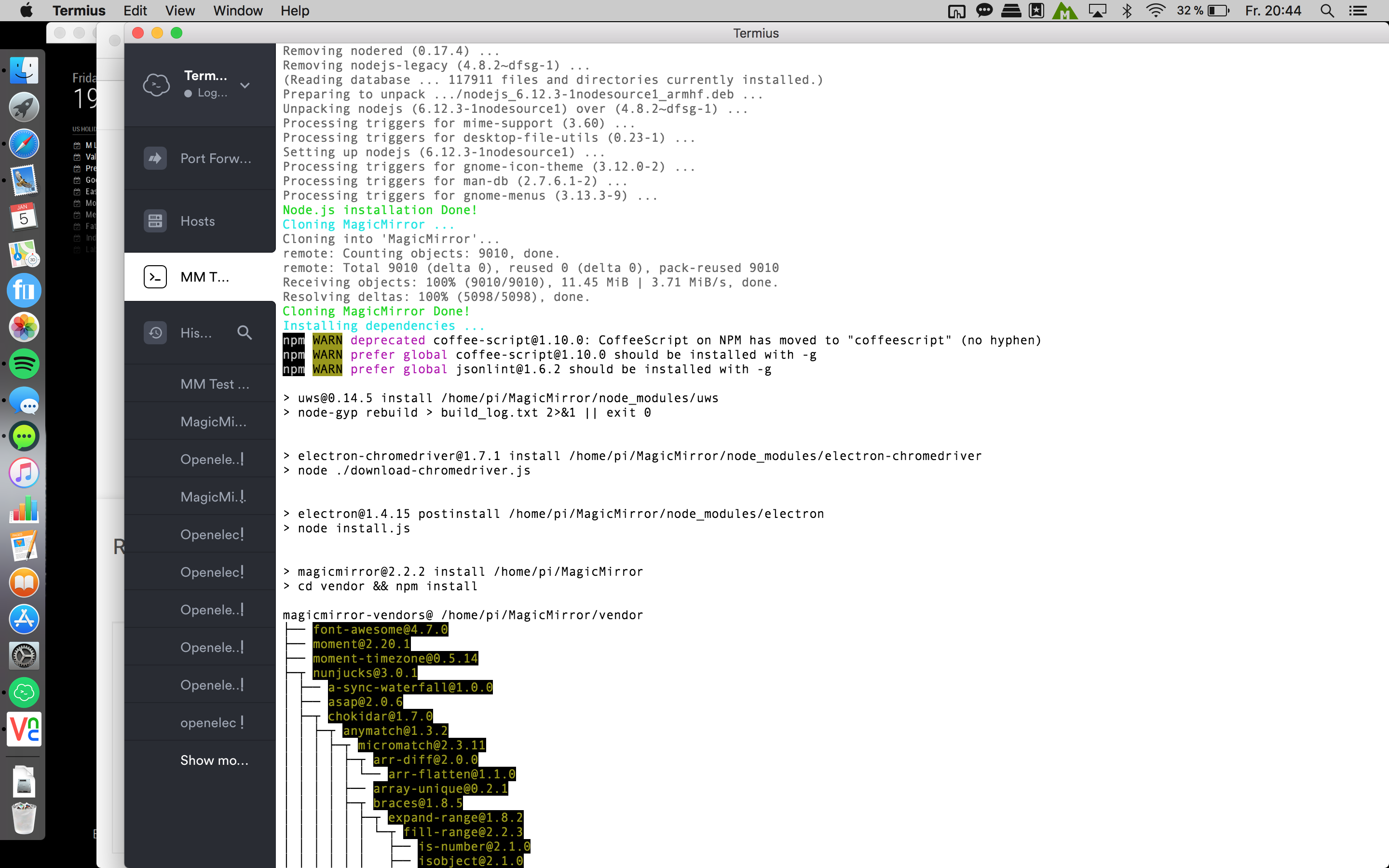

                    I think i figured out what went wrong ;)
                    i set up a new raspbian (Desktop Version) and could install the MagicMirro without any issues.
                    IMPORTANT:
                    while the installation of MagicMirror (automatic installer) u will see this:
                    Cloning MagicMirror Done!
                    Installing dependencies ...
                    npm WARN deprecated coffee-script@1.10.0: CoffeeScript on NPM has moved to "coffeescript" (no hyphen)
                    npm WARN prefer global coffee-script@1.10.0 should be installed with -g
                    npm WARN prefer global jsonlint@1.6.2 should be installed with -g
                    > uws@0.14.5 install /home/pi/MagicMirror/node_modules/uws
                    > node-gyp rebuild > build_log.txt 2>&1 || exit 0
                    When u arrived this, it seems the installation is done. But wrong! just wait. it will take some time even if there is no cursor blinking.
                    Just wait and you will see some more installation steps:

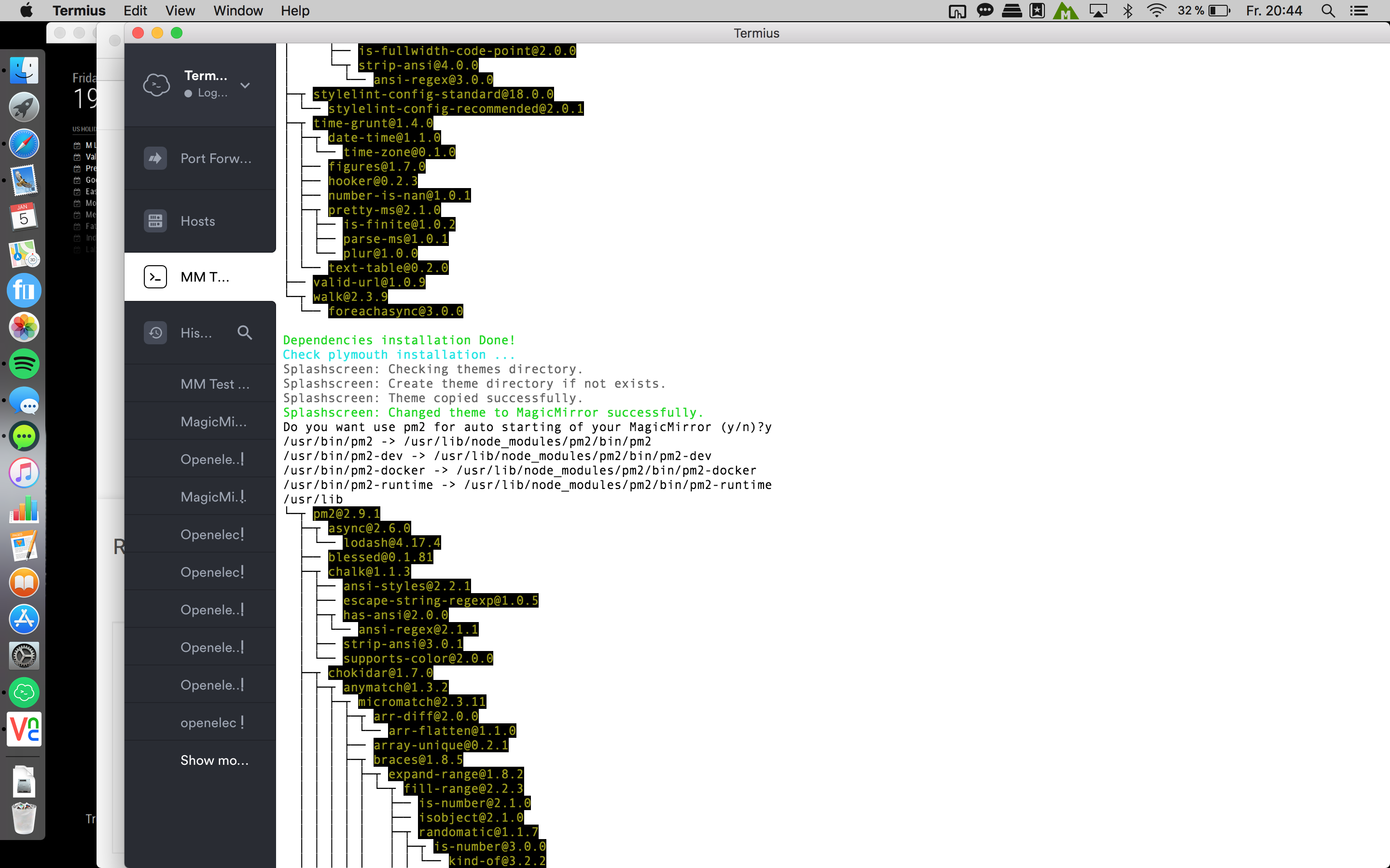

                    Wait again:

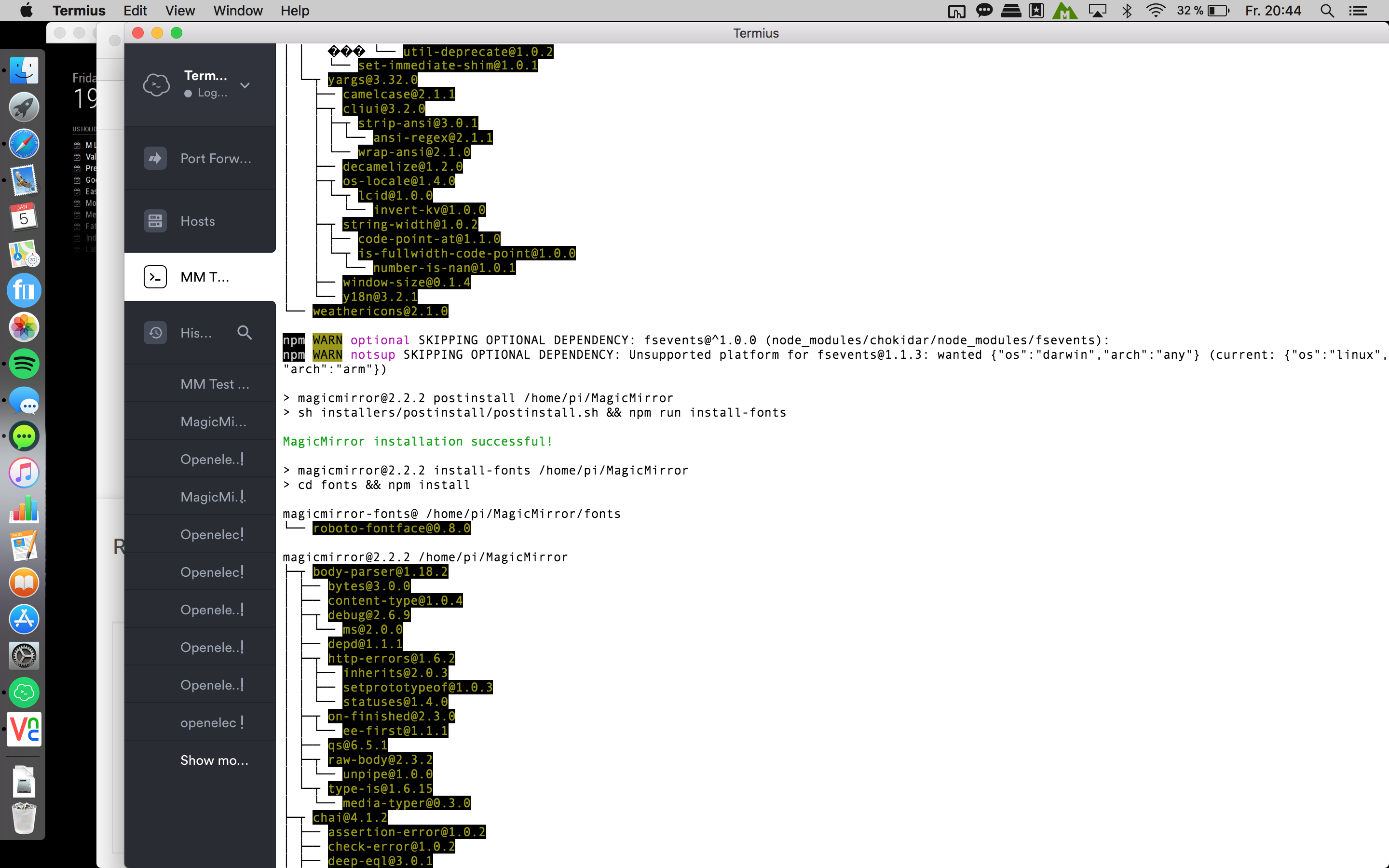

                    wait again ^^ and u will be asked if u want to use pm2. say YES! :

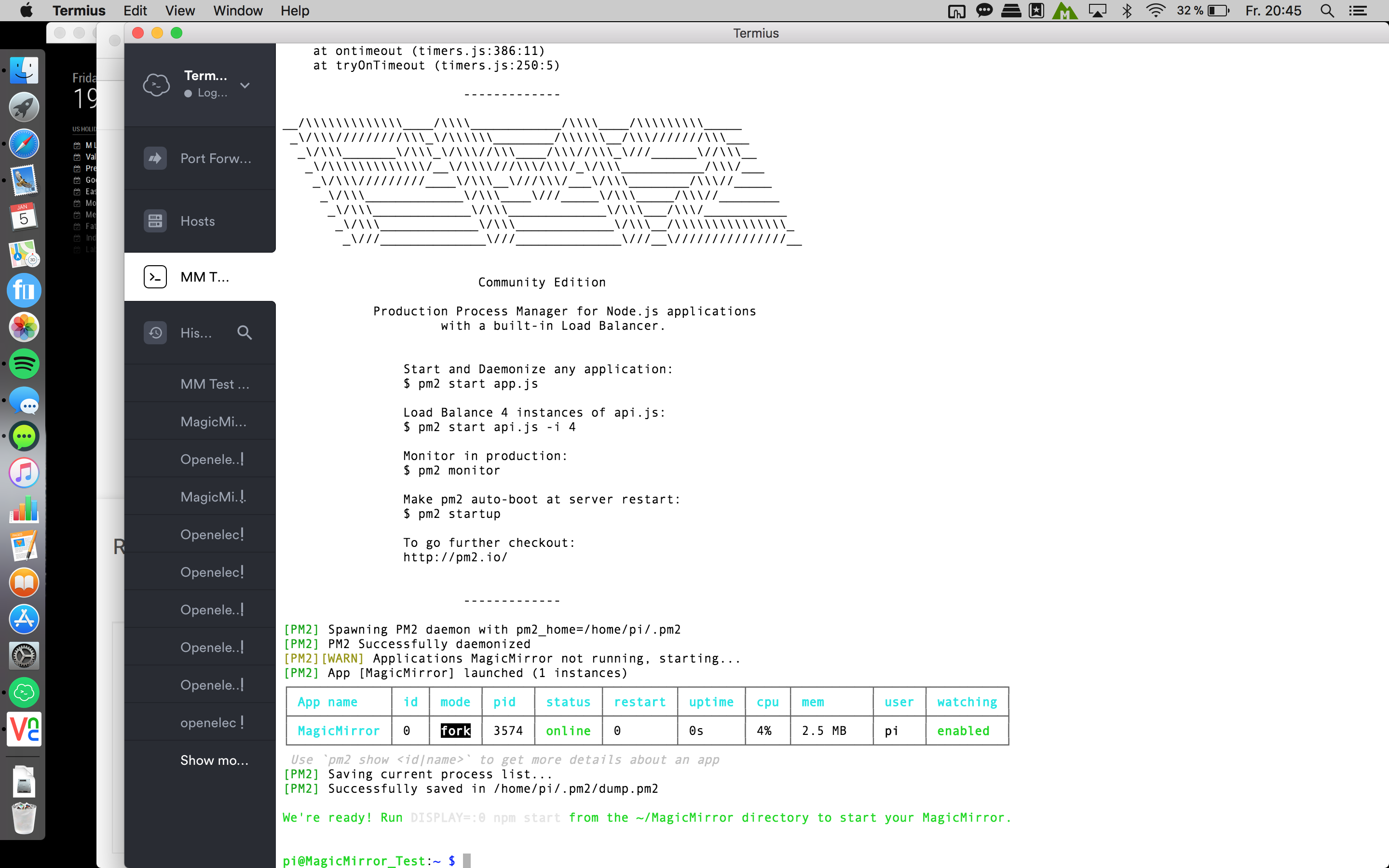

                    Finally u will see this:
                    And after a few seconds the magic mirror will start automatically and u can enjoy :D
